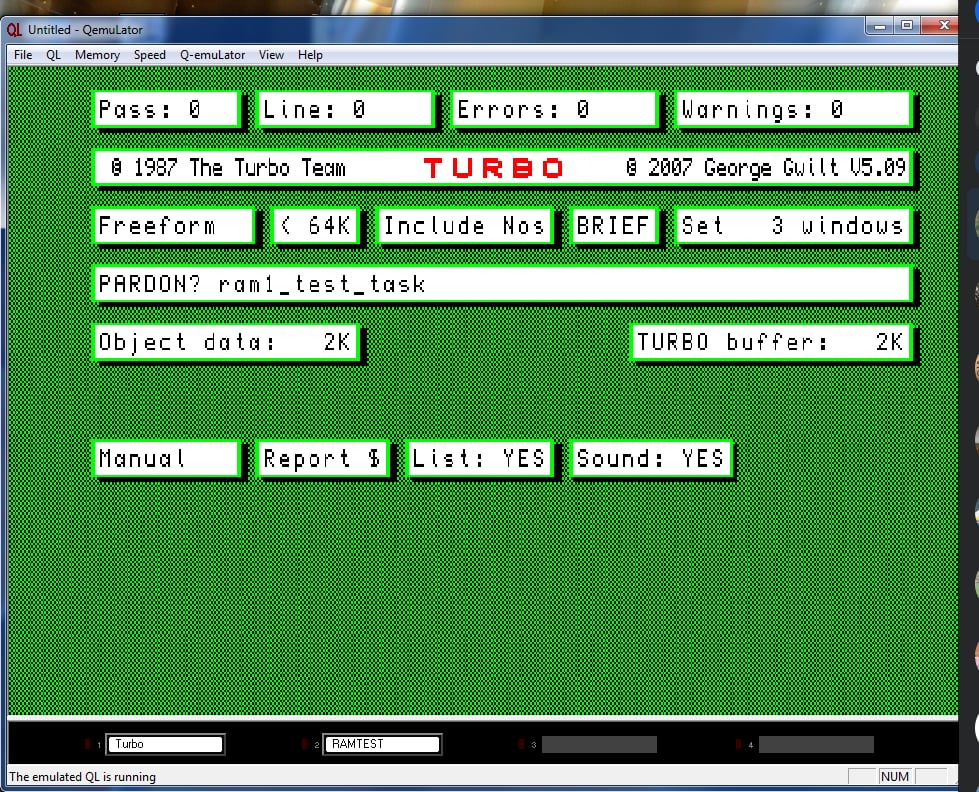

tofro wrote: Sun Jan 05, 2025 9:43 pm The file name contains a dot - You need to put it in quotes.
Thank you,
yes, It was an issue. And after it, the compiler loaded as shown:
After using the Andrei MDV image that contains the compiler, it worked as shown:
and compiled fine.
Tomorrow I would like to explore a little more, why I couldn't with the shared files but the mdv image worked with the compilator.
It's very interesting
