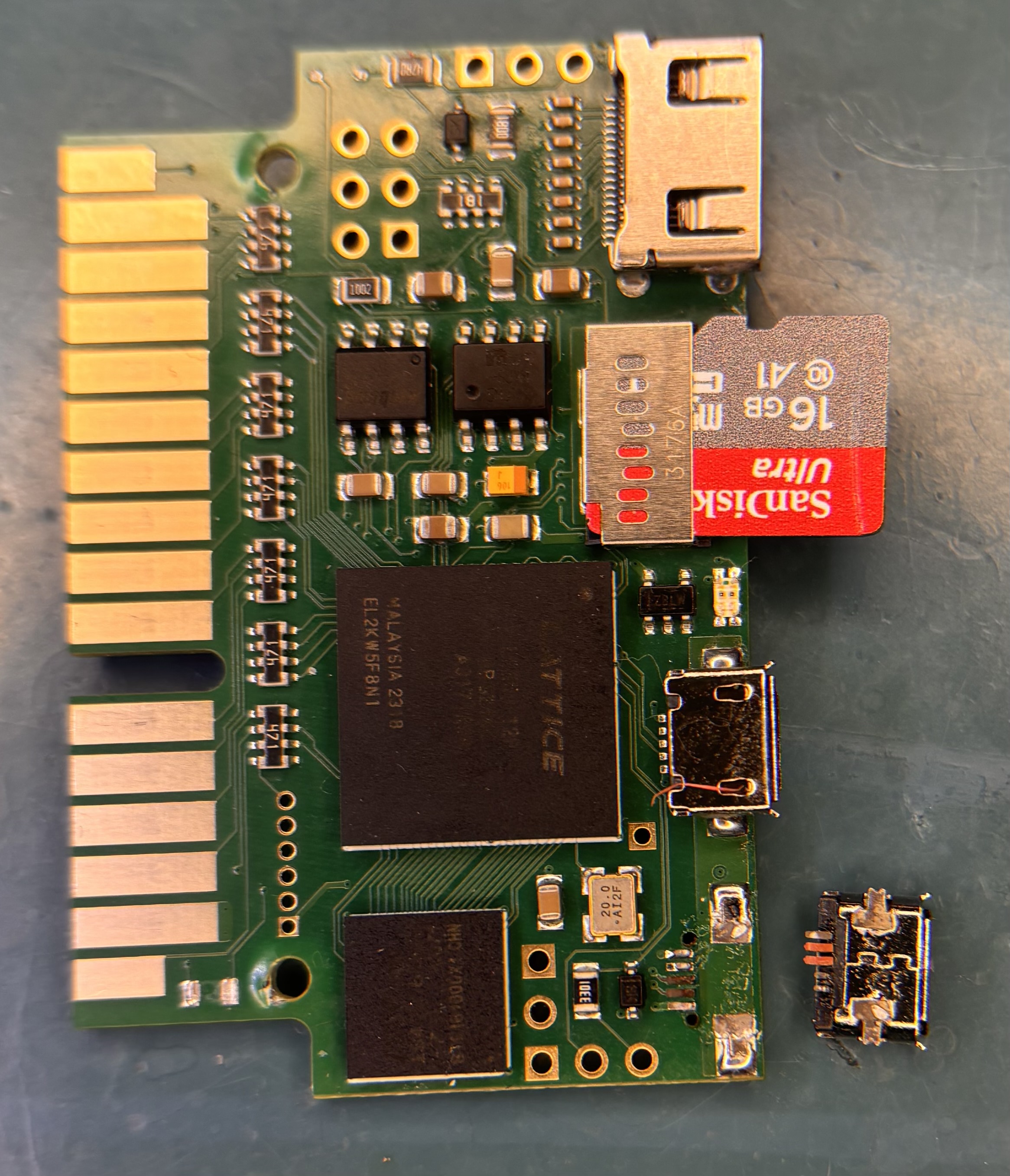

Well, guess all experimentation has now ended as the very tenuously attached USB socket for the mouse has just snapped off my board. I'm not happy, and neither is the board.

Very sorry to see that. The downside of modern SMD technology... Stephan and me discussed replacing this connector by a throughhole type. But only few of such accidents happened, and it did not seem to justify the addidtional tooling and prototyping costs.
Do you need the PS/2 keyboard port? If not, we can help by a special FPGA logic which places mouse there.

Thanks Peter, and no I don’t need the keyboard option. However, I have fixed the connector by very carefully soldering on two very small data wires (the ones that had ripped off from the board) and routing them to pads on the back of the board. I then connected the two power pins and soldered and epoxied the connector back into place. Hopefully this will be more secure now.
It seems to work, in that I get a green flash indicating that a mouse has been detected. What I could do with is knowing how to test the mouse in use, with say a mouse cursor. I am reading through the manual but haven’t found anything that will help with this. Do I have to instigate the pointer environment some how then load a driver in some way. I do seem to remember seeing a QL pointer environment web page that I read some time ago.
Sorry for my ignorance here but I am coming back to the QL after having one in the 80s. I never had a mouse then but did have the ICE ROM cart, which I obviously can’t use with the QIMSI GOLD, or I don’t know how to. Since the 80s the QL world does seem to have moved on quit a bit, hence me needing quite a bit of catch up.
