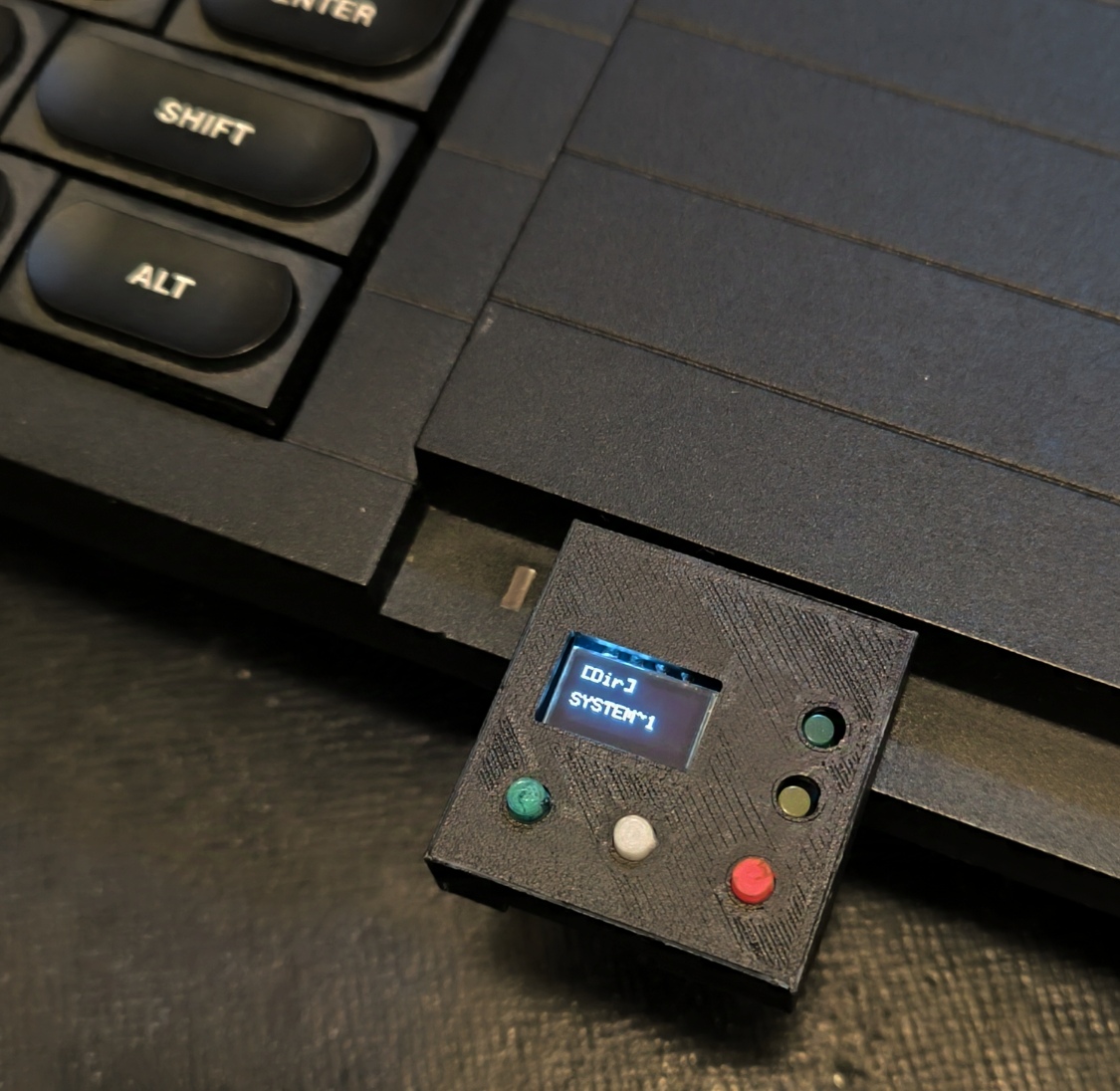

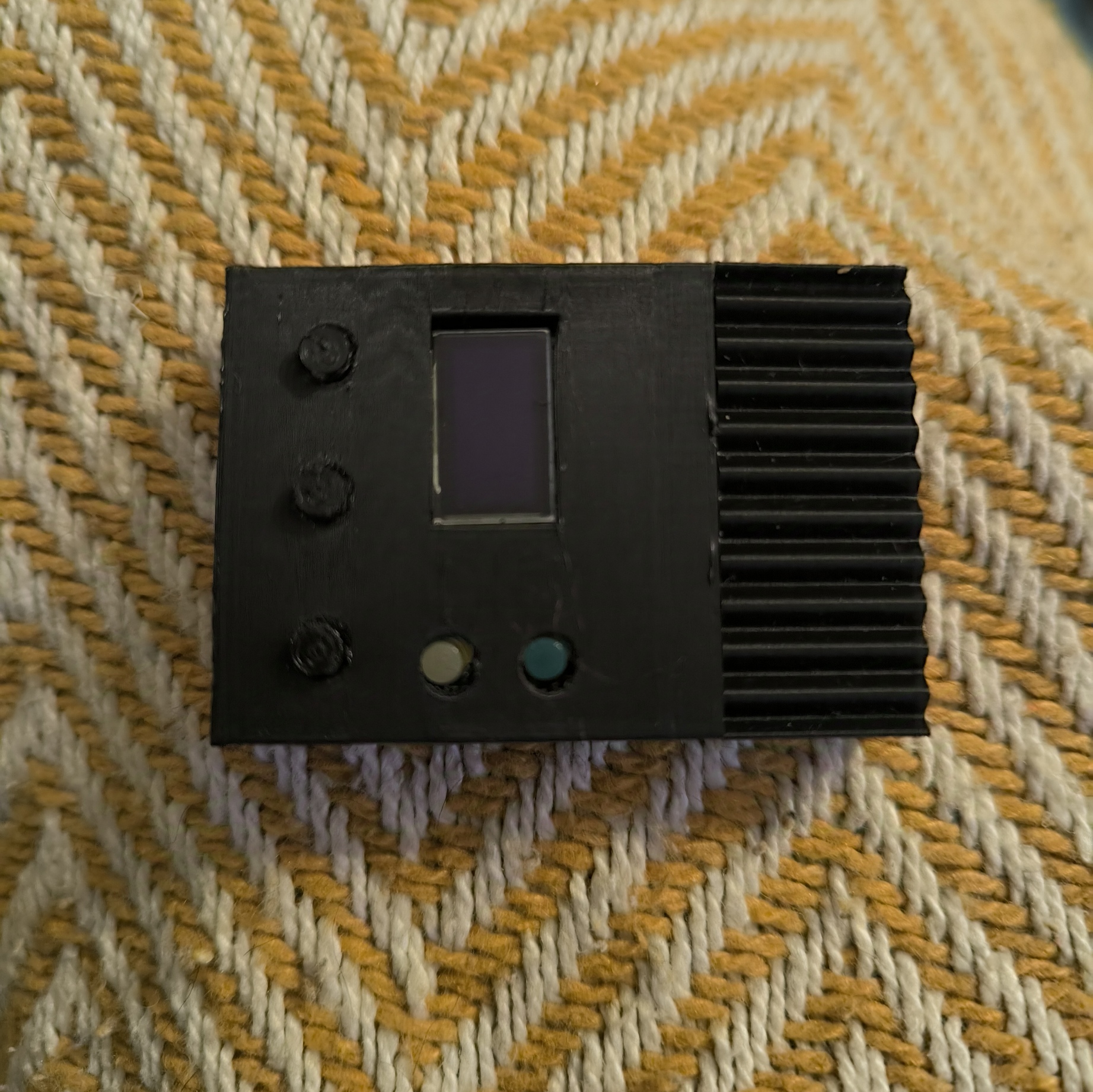

I made a case :)

Jbizzel wrote: Tue Dec 24, 2024 11:05 am I made a case :)
Beautiful!!!
I love it!
Wauuu!
I didn't thought it were possible in such an elegant way
You should share it on Facebk group too.
It is really beautiful.

Post by Jbizzel »
Here it is
https://www.thingiverse.com/thing:6886864
Thanks for a cool project

Jbizzel wrote: Tue Dec 24, 2024 6:01 pm Here it is
A little improvemen would be to carve on the STL (no idea how difficult is to do) with the symbols.
For Leds, have you used SMD with cover or TH leds?
