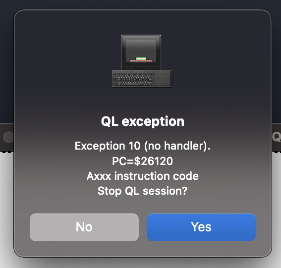

Having got the timer code back in to the main code and assembling without errors I'm back to getting an exception
Happens when TRAP #1 is called
Is there an alternative to this 50hz stuff I could use that would be consistent across emulators & real iron please?
Could I use the RTC ticks maybe?
Posts: 3211
Re: Joystick/Sound in Supervisor mode?
The QL's RTC is only progressing in 1s intervals. You could use it, but it would make your program crawl :) The polling interrupt is really the only way you get a suitably fast tick rate.
If you pack your sources and put them here I could have a look at it.
