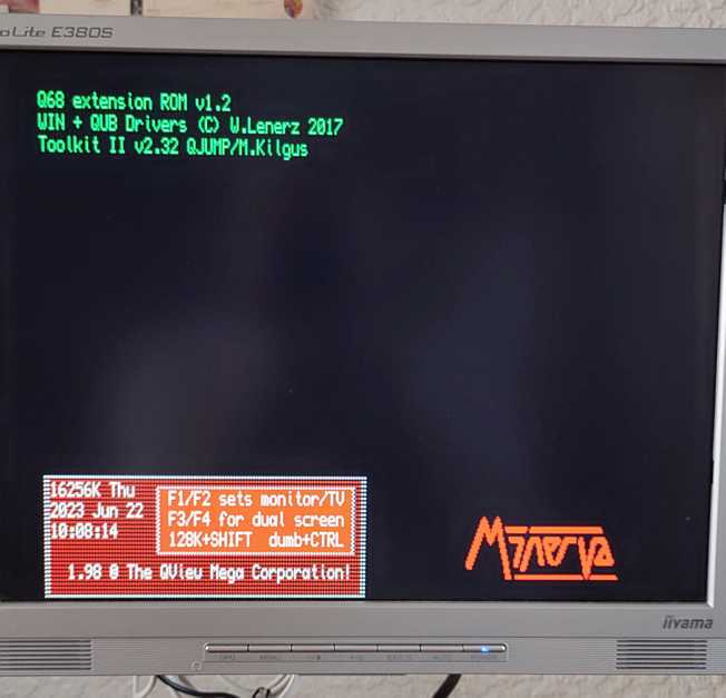

Thank you Jan.
PEEK($18020) = 56
PEEK($18021) = 64
Here is how my Q68+Minerva4Q68 now boots up:
Min4Q68
Min4Q68
It can now get to the Minerva command line by itself if I leave it for a few seconds, but the cursor is steady, not flashing, and keyboard does not work. I have tried both with and without the mouse connected.
Looks like some progress.

Derek_Stewart wrote: Thu Jun 22, 2023 10:40 am Can these values be inserted into the QL_ROM.SYS file?
These are not ROM locations but I/O ports, hence they are set by the firmware.
The difference between my 68 and Dilwyn's 64 at $18021 is the transmit interrupt bit, this shouldn't make any difference now as it is ignored by the new builds.
From the mail conversation I got from you and Peter Graf I gather that v1.05 now sets the external interrupt bit in PC.INTR, this would have made a difference in the original Minerva ROM but I have changed the code such that it executes the handler anyway unless bit 3 in PC.INTR indicates a frame interrupt (which is correctly implemented at least in my v1.00).
The SMSQ/E v3.38 source contains a test upon initialisation for the keyboard interface interrupt which I haven't backported yet. I'm not sure whether this affects particular keyboards or firmware versions but it might explain why Dilwyn's keyboard still doesn't work. As these are only a few instructions to be ported you may expect a new build tonight or tomorrow ;).
(@Dilwyn: you might try POKEing 0 into location 1057 (1089 for the LRESPR'ed version) which enables the full RAM test, this will slow down the startup but will detect any RAM failure just in case...)

dilwyn wrote: Thu Jun 22, 2023 10:24 am It can now get to the Minerva command line by itself if I leave it for a few seconds, but the cursor is steady, not flashing, and keyboard does not work. I have tried both with and without the mouse connected.
Here's the latest build, hope to finally have fixed the keyboard interrupt now.
This also prints a message when using the keyboard interrupt, else it uses only the polled task as usual.
