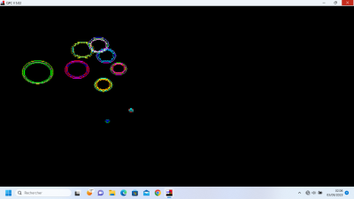

Hi Folks,
Just decided to do a little Doodle before the end of my holiday break. A simulation of blowing Soap Bubbles.....
Unzip, LRUN and watch, or ESCape !
Regards, Steve.
Regards, Steve.

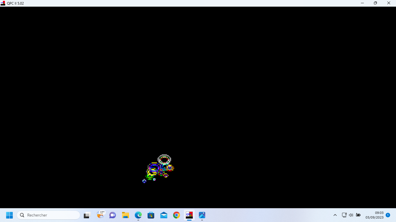

Re: Doodle
Hi Again,
Here is a much more fluid version, after simplifying and removing quite a few lines of code....
This will probably be the final version. Should work on most platforms. (Tested under QPC2).
Regards, Steve.
Regards, Steve.

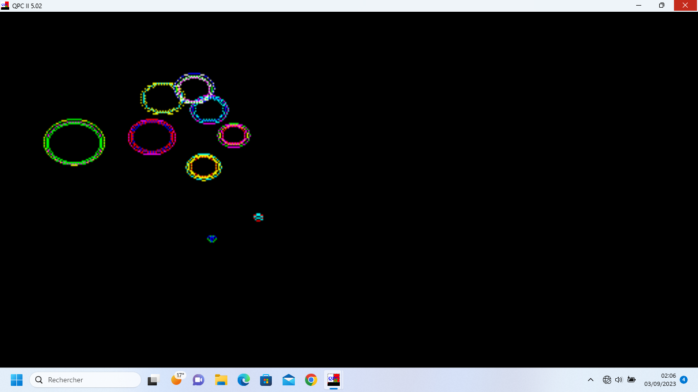

Re: Doodle
Just managed to reduce the code from 3ko down to 2ko, by compacting the bubble-loop from 28 lines down to a mere 4 lines....
The original 7 bubble stream may now be up to 28, so the animation is even more realistic. (Hit ESCape to halt).
It is surprising what can be done using the much underrated but very versatile Turtle graphics !
So I will continue experimenting with them, and see what I can discover ?
Regards, Steve.
Regards, Steve.

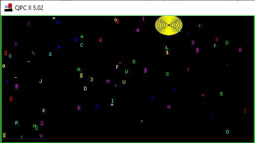

Re: Doodle
Nice work Steve. Runs nicely on QPC2, I like the circular 'explosions' when the objects collide.
I tried this version on Q68, in QL screen modes (high colour modes would have been slower). It ran, but slowly. Even with the SGC mods it was still a little short of acceptable speed with any decent number of objects.
Is it meant to always show just 2 objects when you first run it? If I run it a second time, I get many more objects.
Some years ago, I tried to write a set of text sprite routines in BASIC, as procedures so that it was possible to write your own animation routines using redefined text font characters as sprites. It took longer than I expected, and struggled to make it fast enough in BASIC. And it allowed far fewer moving objects. Like you I remember that the collision detection took a lot of time. I'd gone as far as to use layers or 'planes' so that only objects on the same 'plane' could collide, the others simply passed in front of or behind each other depending on the depth.
After a while I realised I was over-complicating it and gave up, intending to pick up on it later when I had more time. Trouble is, I never got more time! I'll see if I can find it and have another go to see what I can do this time, if you don't mind me possibly learning from your program to improve mine.
Screen dump of Brownien2 running on my QPC2 in high colour mode (only using mode 8 colours). Anyone who hasn't tried it, all those text characters are 'objects' that are moving around the screen at the same time. With a font of redefined characters you could make very basic sprites. Especially if you used CSIZE 1,1 where you could use 8x9 pixel objects instead of the usual 5x9 characters in other CSIZEs.

Re: Doodle
Hi Dilwyn,
Firstly, regarding slow operation on SGC, collision detection is the main hurdle.... and could no doubt be improved upon.
On my QPC, I don't get the 'only 2 objects at startup' problem. Perhaps including RANDOMISE in 'init' might help on your setup ?
As for using planes, version3 now simply uses OVER 1 to avoid printing on strip, and hence reduces sprites hiding each other...
Any CSIZE can now catered for, although I prefer 0,0 which reduces screen clutter.
Please feel free to do what you like with the program, as it is only an experimental prototype, intended for optimisation.
Postings about sprites on other topics got me to start wondering if using QPC2 potential might open new posssibilities.
Regards, Steve.
Regards, Steve.
