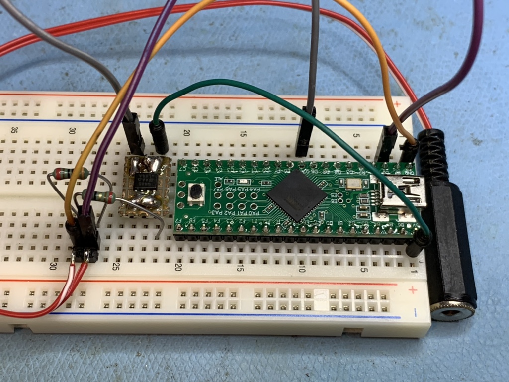

Sooo, finished my board a few days ago. It's a simplified design using some FDS4465 Mosfet that is totally overkill but which I had laying around from prototyping an 8x8x8 LED cube 10 years ago
Results in a very simple circuit.
I had some trouble with the software, SMSQ/E kept crashing on me while QEmuLator worked fine. The culprit seems to be the DIY edline_code, it only started working after using the "Minerva" version that is also supplied in the same package. Haven't investigated this any further.
It might be of note that the PC side is hard coded to node 8, once I realized that everything started working (as a German saying says "once you do it right, it works").
