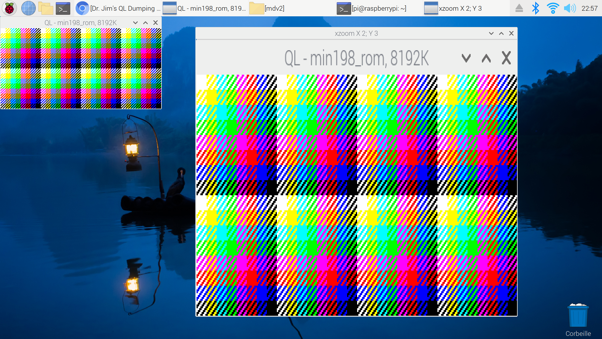

I have a uQLx on a Pi0-W (which, I measured, runs 20 times faster than my BBQL) and I tested today the 8 colors mode which obviously works OK.
Here a screen copy of my 8 colors TARTAN48 test (supperFORTH version) :
8 colors TARTAN test
for trying it yourself, here is the corresponding source code :

TARTAN DOG'S 4 0 | 4 1 | END_TARTAN BLACK WHITE DOG'S TOOTH
END_FILE
BYE POLKA
May the FORTH be with you !

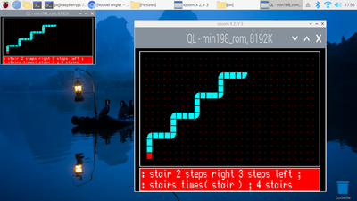

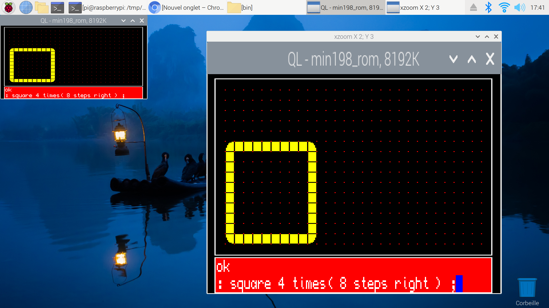

Two other Screen shots in 8 colors mode, of a FORTH program that I wrote for 8 years old kids (my daughter's class) to show them how to code (in FORTH, indeed).
a square
a square
stairs
stairs
As it runs on ComputerOne FORTH and in french, give me some time to convert it for SupperFORTH and in english (for you to play with it too)
BYE, POLKa
