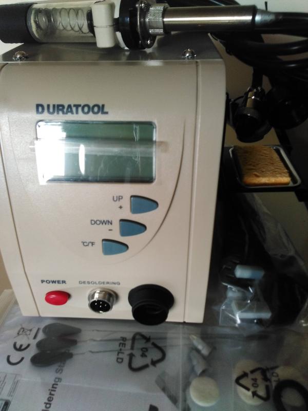

I gone & dunit. I saw it on EBay for £50 and the bloke said it had only been turned on for 4 hours. I like a bargain and pressed the buy button convincing myself I could take the RAM chips out and flog it again given that new ones are £100 but I won't.
It looks like being turned on is all that has been done with it because the only sign of use is the discoloured tip. Why would someone buy a solder sucking machine for 4 hours use? The sponge is brand new and there is a tiny fleck of solder on the spring as if it has been used on one hole. Perhaps he ripped off the tracks and gave up.

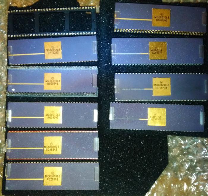

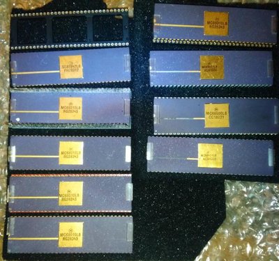

Look what I did find instead. A bunch of 68010 a 68000 and some virtual memory management chips I think but what use are they? Ideas on a postcard. Gone to figure out how to use the sucker and rip the RAM tracks off my QL.
