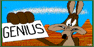

Hi Tofro,
You might want to take a look at Ungif. http://www.dilwyn.me.uk/graphics/ungif.zip
It does dithering in mode 4 and 8 and runs on any QL but was used here on QPC2 in mode 8 to make this example.
A DO on the converted image opens a menu to change settings and redo the image.
This size is 512x256, but it can be adjusted to trim the automatic border later.

tofro wrote:
Andrew wrote:The same Guru - dithered "by hand" in Photoshop, scaled for QL pixel ratio and loaded in QPC mode 8
Impressive.
Do you know by any chance what algorithm for dithering Photoshop is using?
And could you try to do the same thing to the jinxter bus picture?
Photoshop uses a modified Floyd-Steinberg algorithm - but in our case it doesn't work good when applied to the whole picture.
What i did was: i raised the contrast to maximum then i proportionally scaled the photo to 341x256 to compensate for the different x and y sizes of QL pixels (I also had to add some black to left and right for this) . Then i scaled it to 256x256, reducing only the width. Then i separated the guru from the background and applied a 70% dithering on him. The background was modified by hand, using some patterns and brushes that i created for PI Cole game.
I can do the same for the jinxter bus picture, if you send it to me.

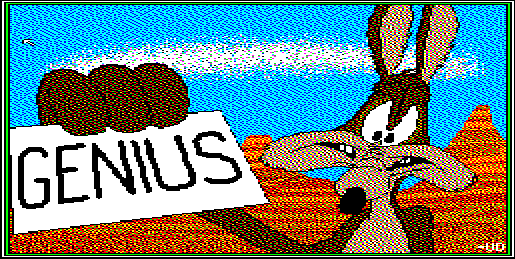

Posts: 3194
Re: The Pawn is back. And it's not alone!
How's this?
(Mr. Guru rendered as an interlaced picture - 57 colors - using the dithvide method. Otherwise not modified from original)
Still needs a bit of tweaking, apparently. But much better already, I think.
The method is actually much easier than I first thought. And My monitors get only lightly annoyed with this method.

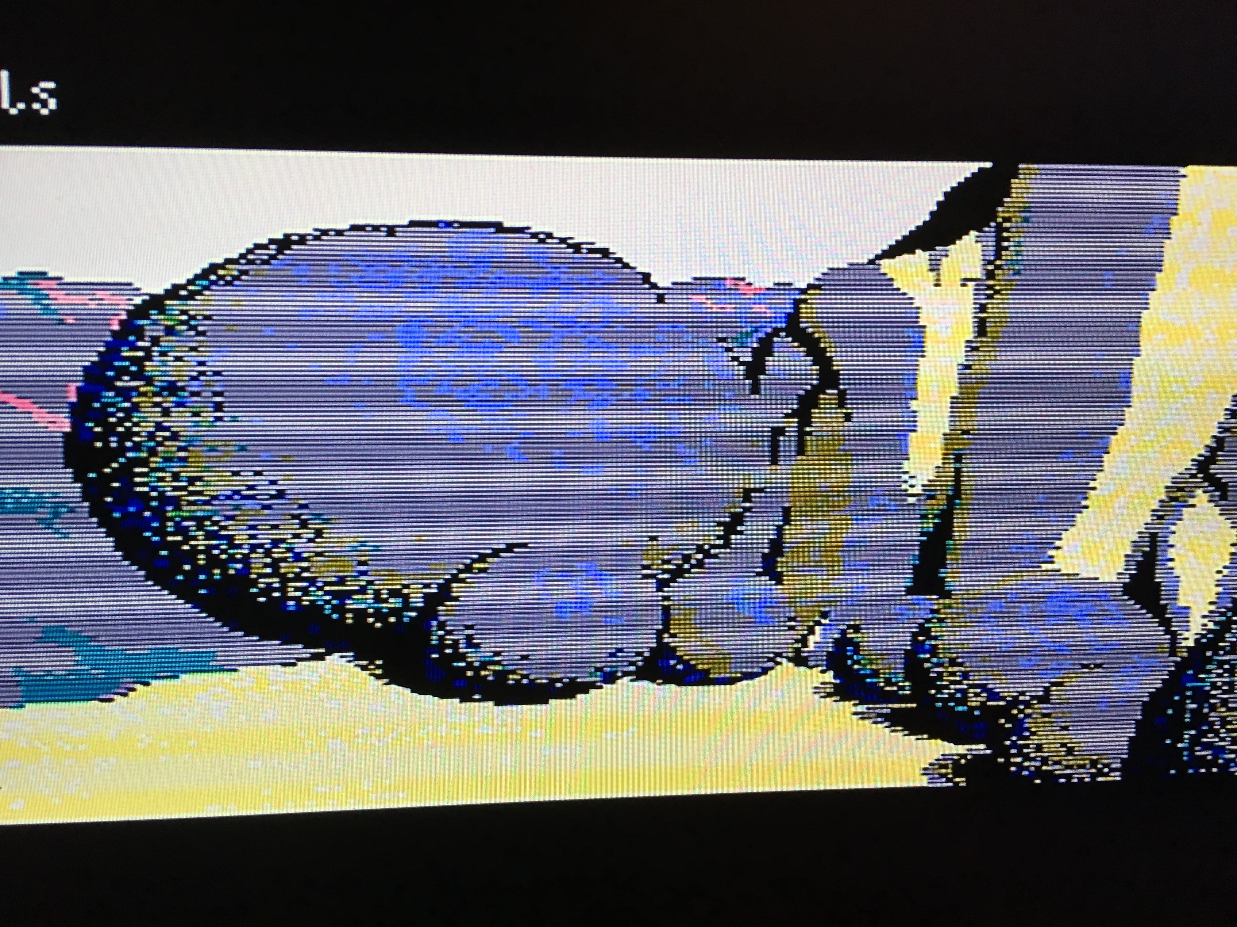

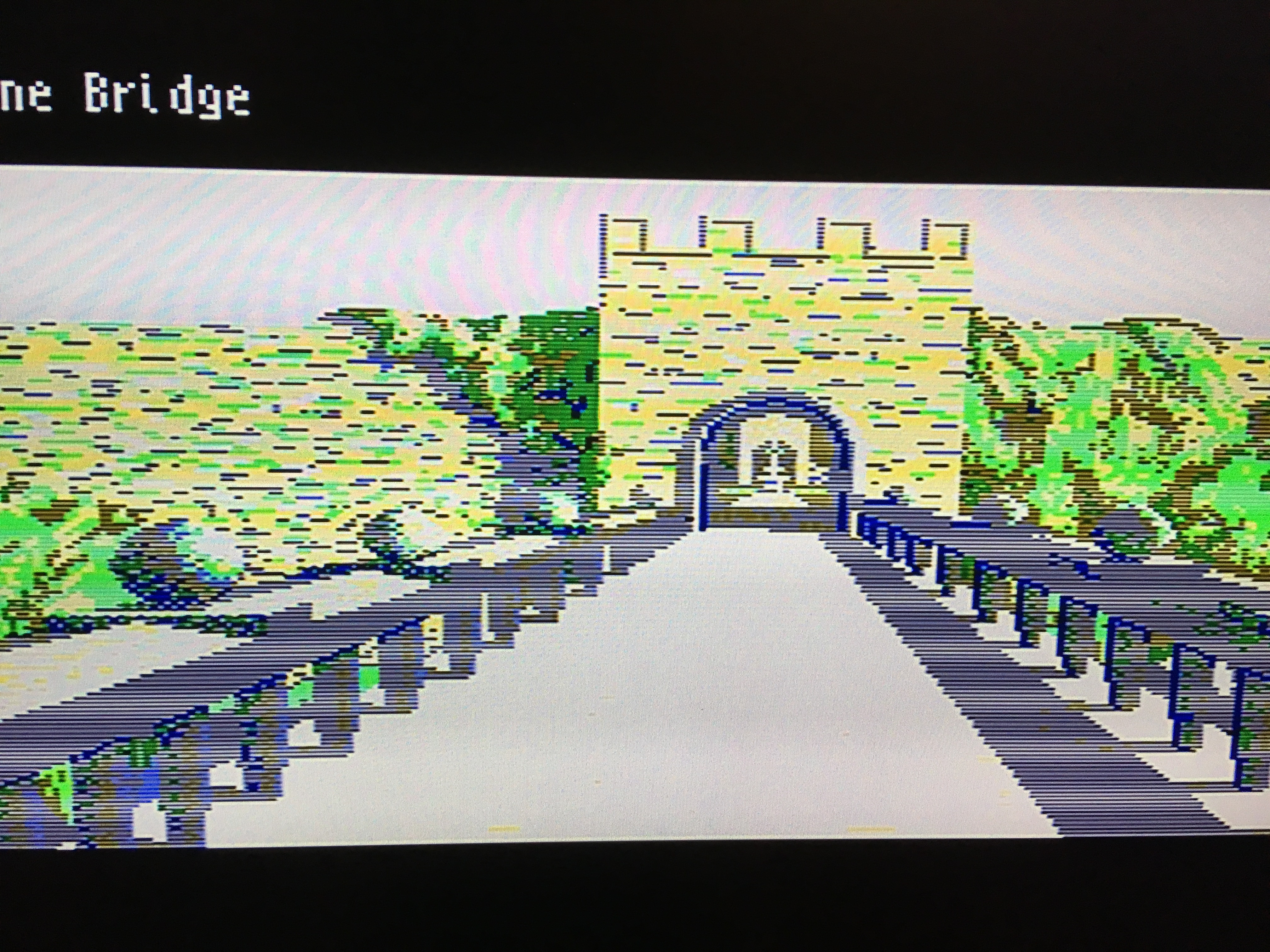

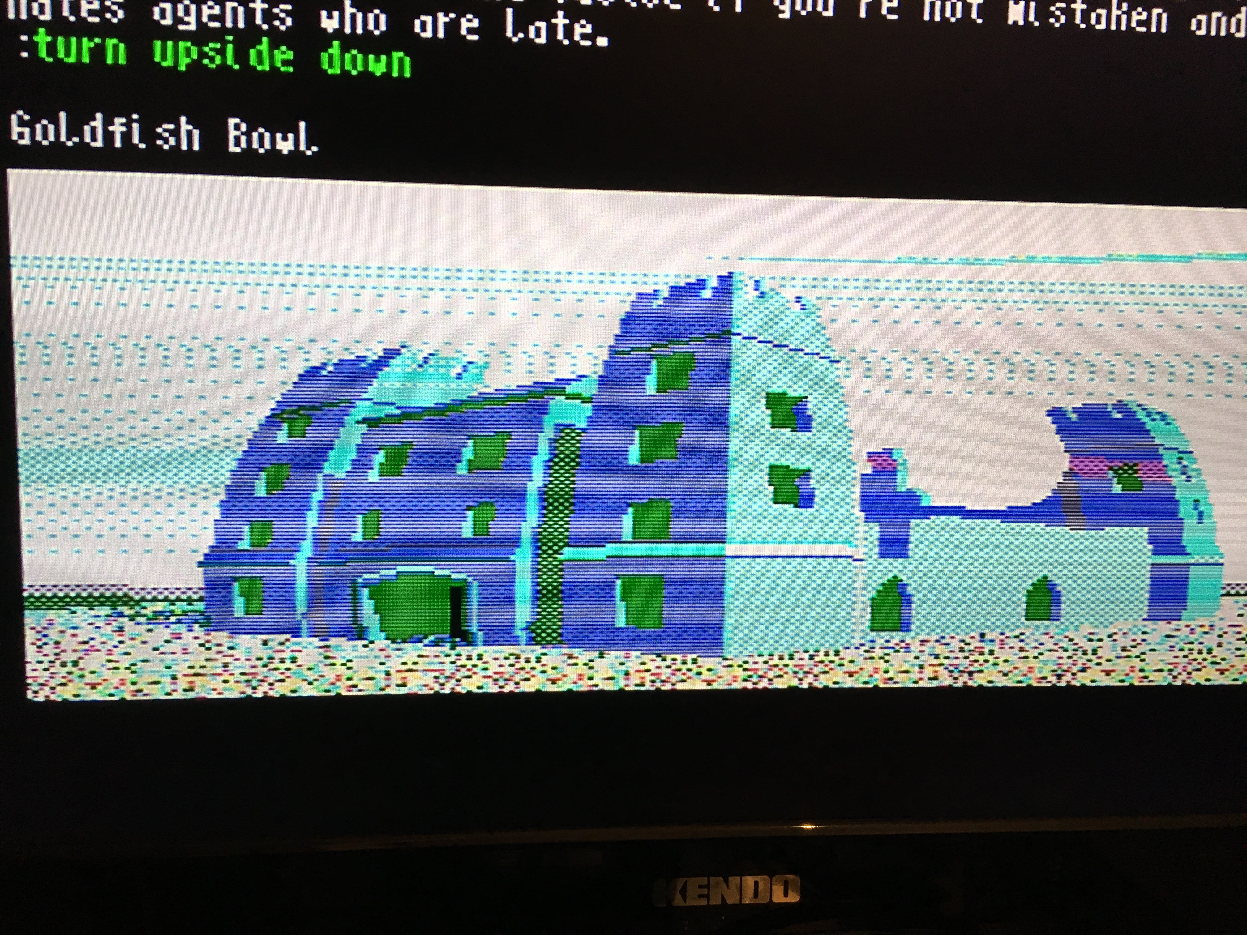

Posts: 3194
Slowly, but steadily, we seem to be gettting somewhere:
Unfortunately, I still have this annoying flickering mentioned in the other thread. I put a delay loop into my keyboard loop, which improved things a bit, but the issue is still there. Today, I have not tested on a real CRT, so it might also be caused by the upscaler.
The horizontal stripes that appear in the picture are not visible in reality - apparently interference with camera exposure time (excuse the crappy pictures taken with my phone)

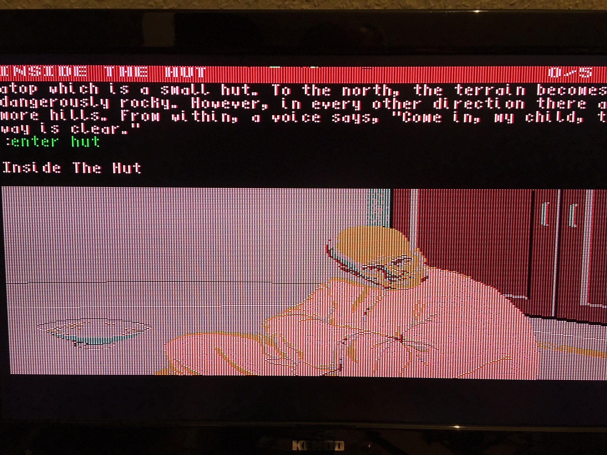

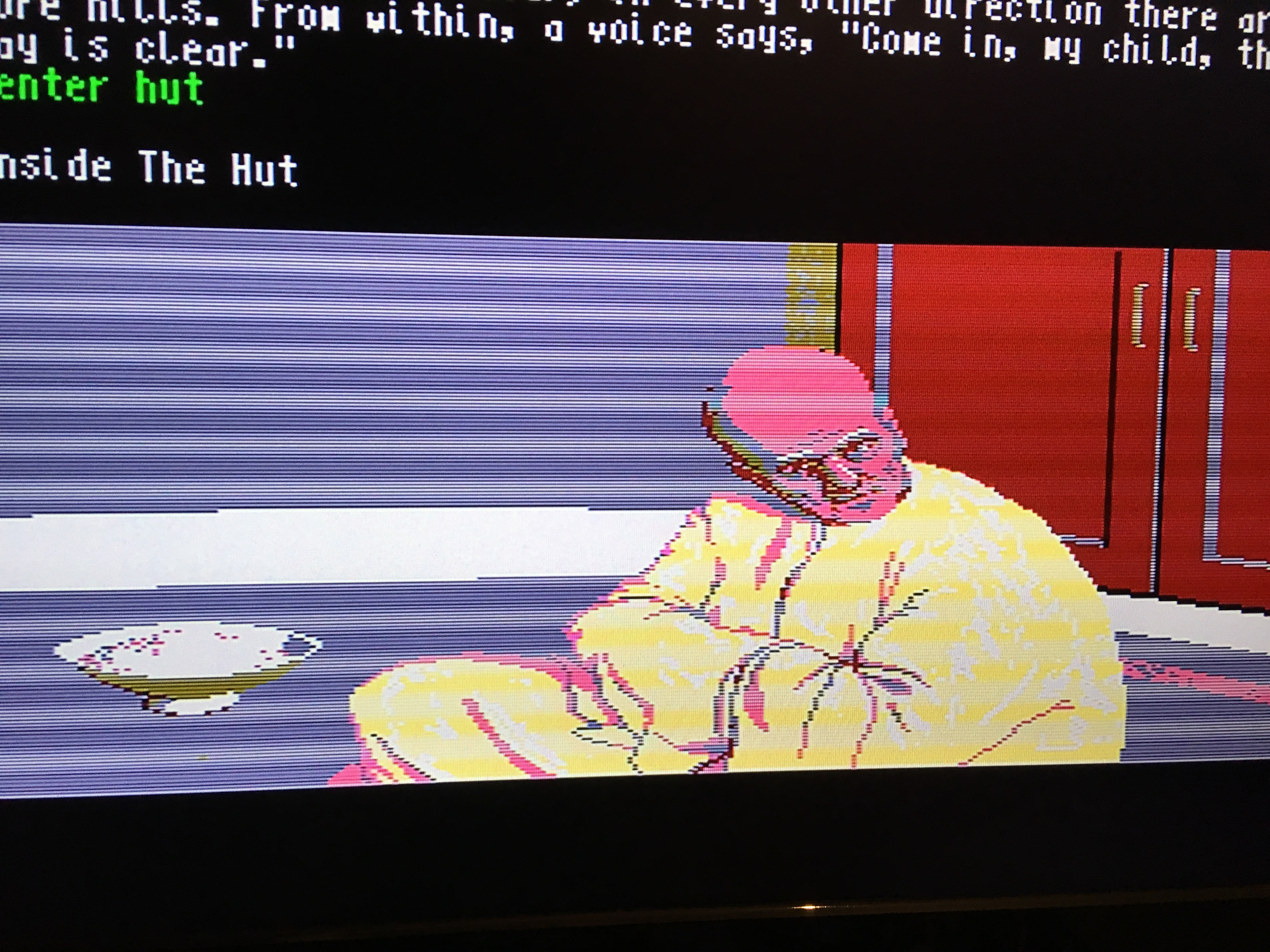

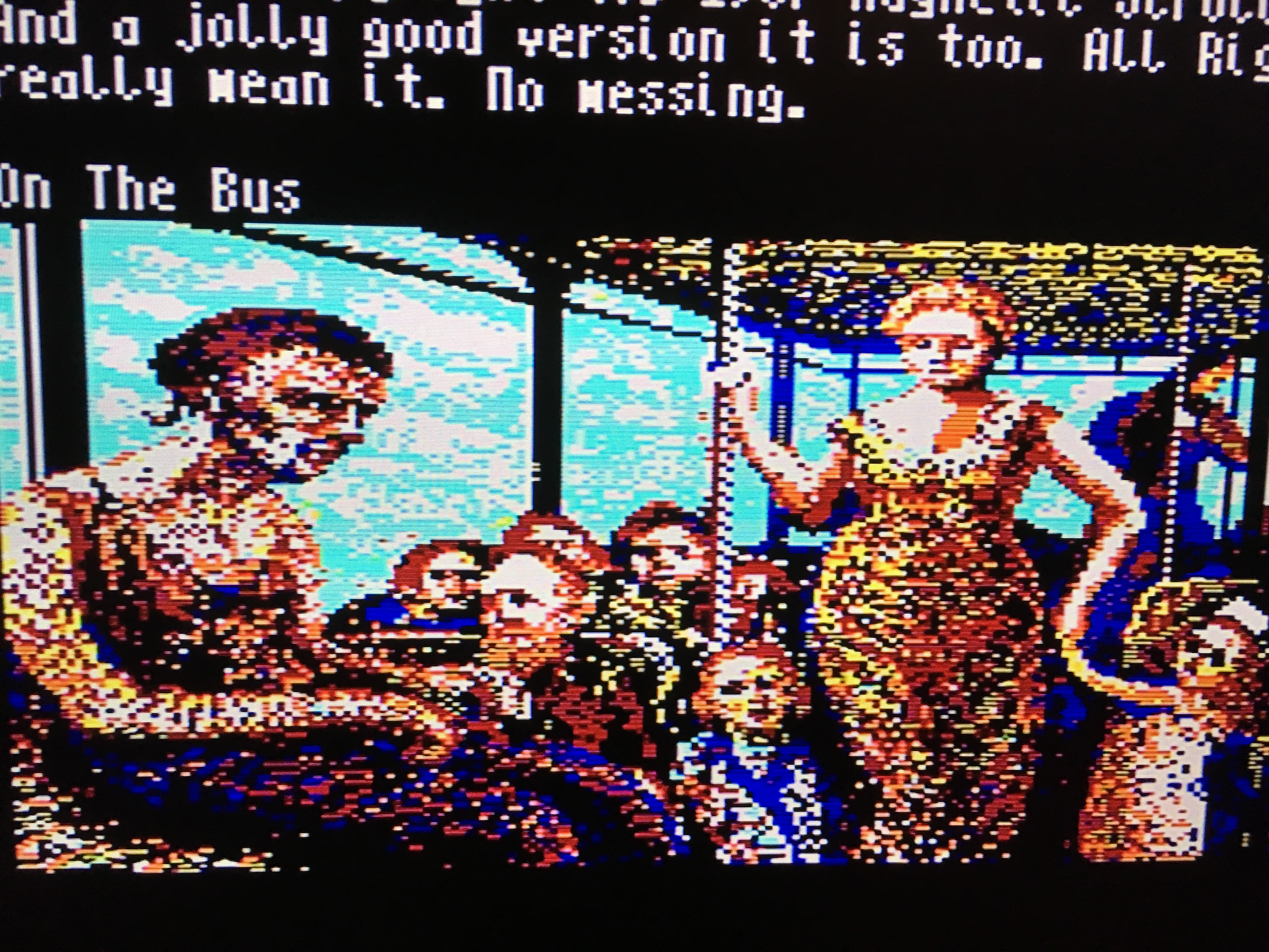

Posts: 3194
And some more QL "MODE8i" pictures from MS adventures:
Mr. Guru seems to have at least partially recovered from his Jalapeño issue...
I think that doesn't look too bad for a QL in MODE 8.
I also have one or the other crash/hang when displaying pictures. Needs a bit more fiddling
