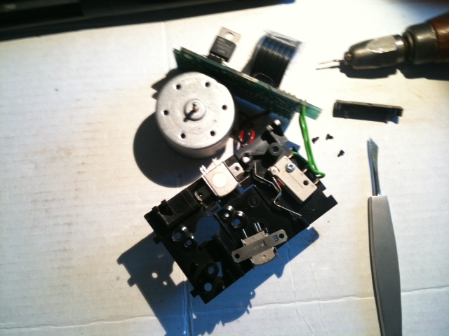

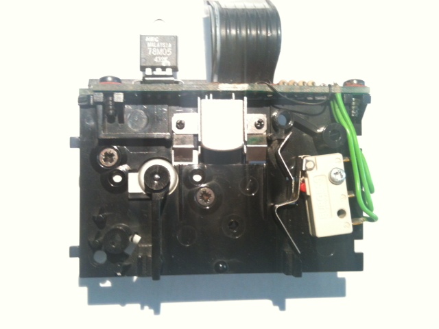

This is one of the four drives I have here for tests and maintenance.
I have managed to replace its R/W head for the good one (thanks to Charles, he has donated a spare).
faulty head desoldered + dismounted
To the right you may see a motor position jig, plus some watchmaker's tiny screws.
The result after fitting good R/W head. Drive had its motor repositioned, head reseated on all four legs, clutching side spring retensified, head springs aligned, new roller fitted. EDIT Ah, forgot, motor speed verified to be OK.
good head fitted
good head fitted
The drive now formats, and pass R/W tests, appears anew in generally good healthy condition.
