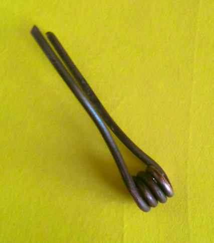

Even if we demagnetised the head, (a simple DIY solution could be a coil for transformer pistol iron, see picture), the head will become magnetised again just by ordinary use.

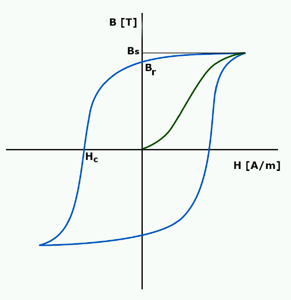

I am now learning about magnetic hysteresis, it seems a welcome quality of magnetic materials, absorbing some inaccuracies we see here. EDIT
Some pre-magnetisation current is needed during writing. It's purpose is to build up some magnetics in the material in the linear (green) part above. The pre-magnetisation current is typically set to frequency between 60-120Khz not to interfere with the recording signal carrying the actual information. The theory has it, that without premagnetics, it won't be quite possible to read recorded information back.

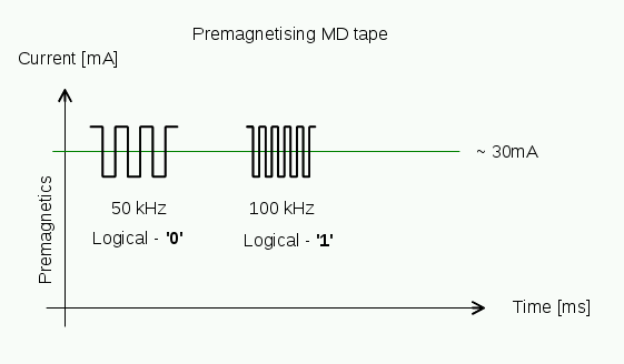

I have read some posts from Gert, also looking further at MD `waveforms' in the QL Service Manual.
MD uses direct current for premagnetisation, and FM modulation for data, 50kHz ~ "0", 100kHz ~ "1".
I do not know what value the premag current is, in the picture shown as 30mA.
Tomas

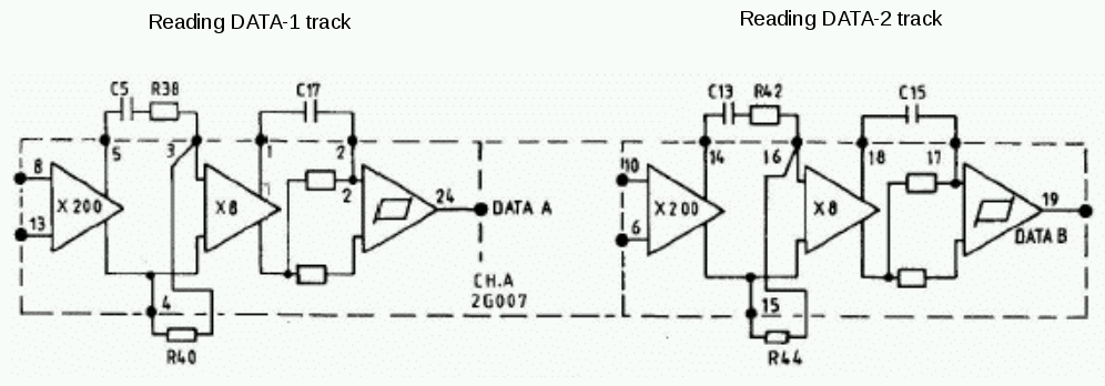

ULA block diagram above shows, in my opinion, only reading data from two tracks, outputting two channels DATA 1-2 (A/B).
But how is data written to tape, we know we need two frequencies 50/100kHz and some direct current?
Tomas

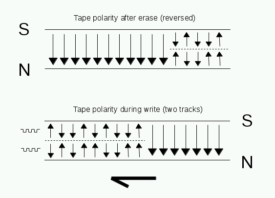

Hi Tomas
As I understand it, writing involves the ULA 'switching' its inputs to outputs and driving the same (stereo) pair of coils with the 50/100KHz signals.
The direct current is entirely independent and flows just through the single erase coil - which has a larger 'gap' - and which is offset physically to effectively de-polarise the tape shortly _before_ that same section of tape reaches the RD/WR gaps. This de-polarisation is effectively placing white-noise on the tape, which the ULA (or the 8302?) can distinguish from the polarised data and is used for the sector GAPs in the MDV timing protocol.
Also, if my understanding is correct, whilst the ULA outputs serial binary when reading, what it actually reads off the tape (during the DATA sections) are peaks in current that represent the transitions between low and high. The actual 'levels' that were recorded during writing become irrelevant - only the timing between these current surges at each transition. Thus, it's not quite pure FM, but more like (but not quite) 'Manchester' encoding - where the relative timings between transitions in a given 'bit-cell' time-window determines the bit-state. In such encoding schemes, the 'CLOCK' is actually encoded within the data stream. I may be wrong here...
