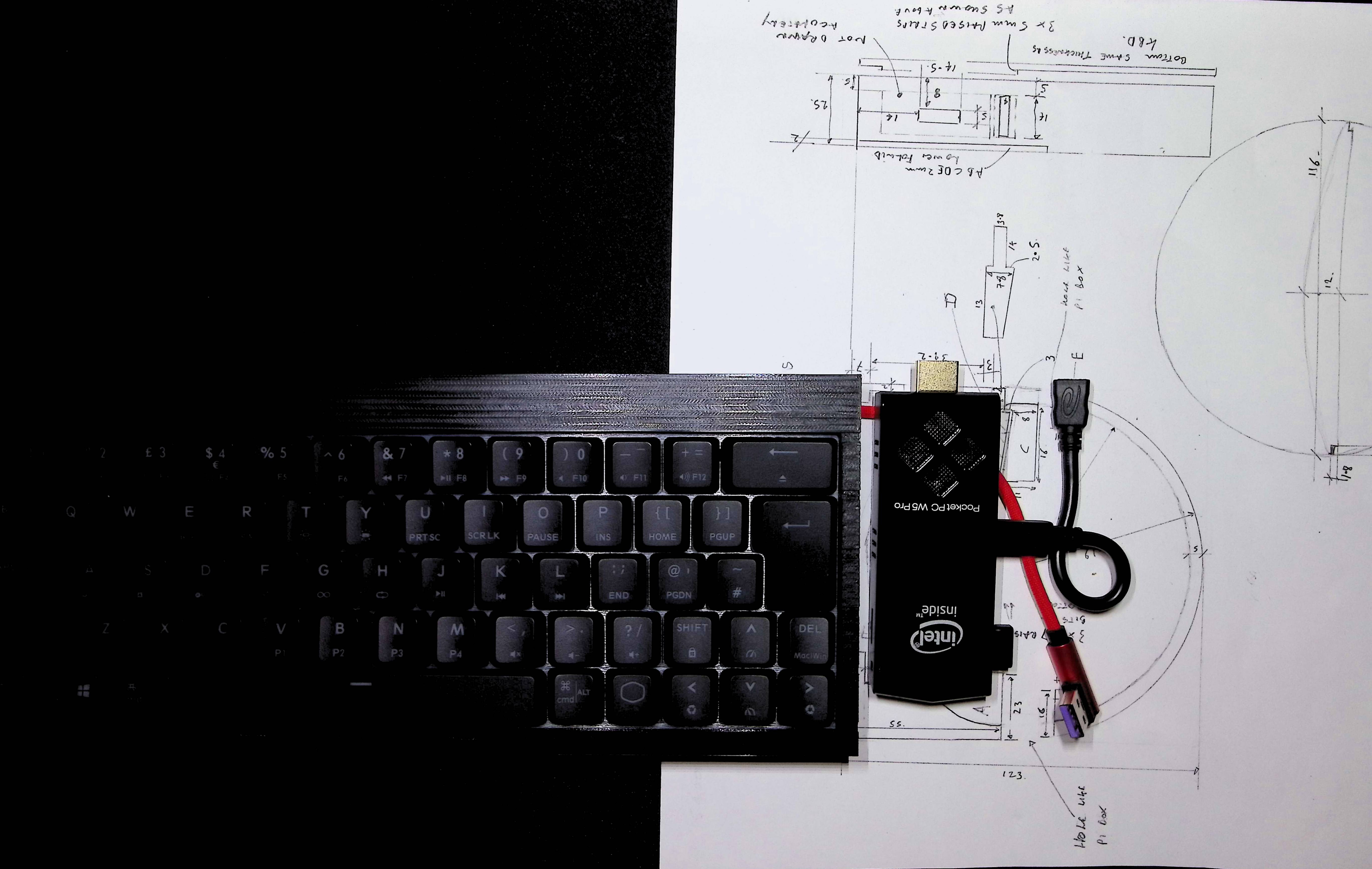

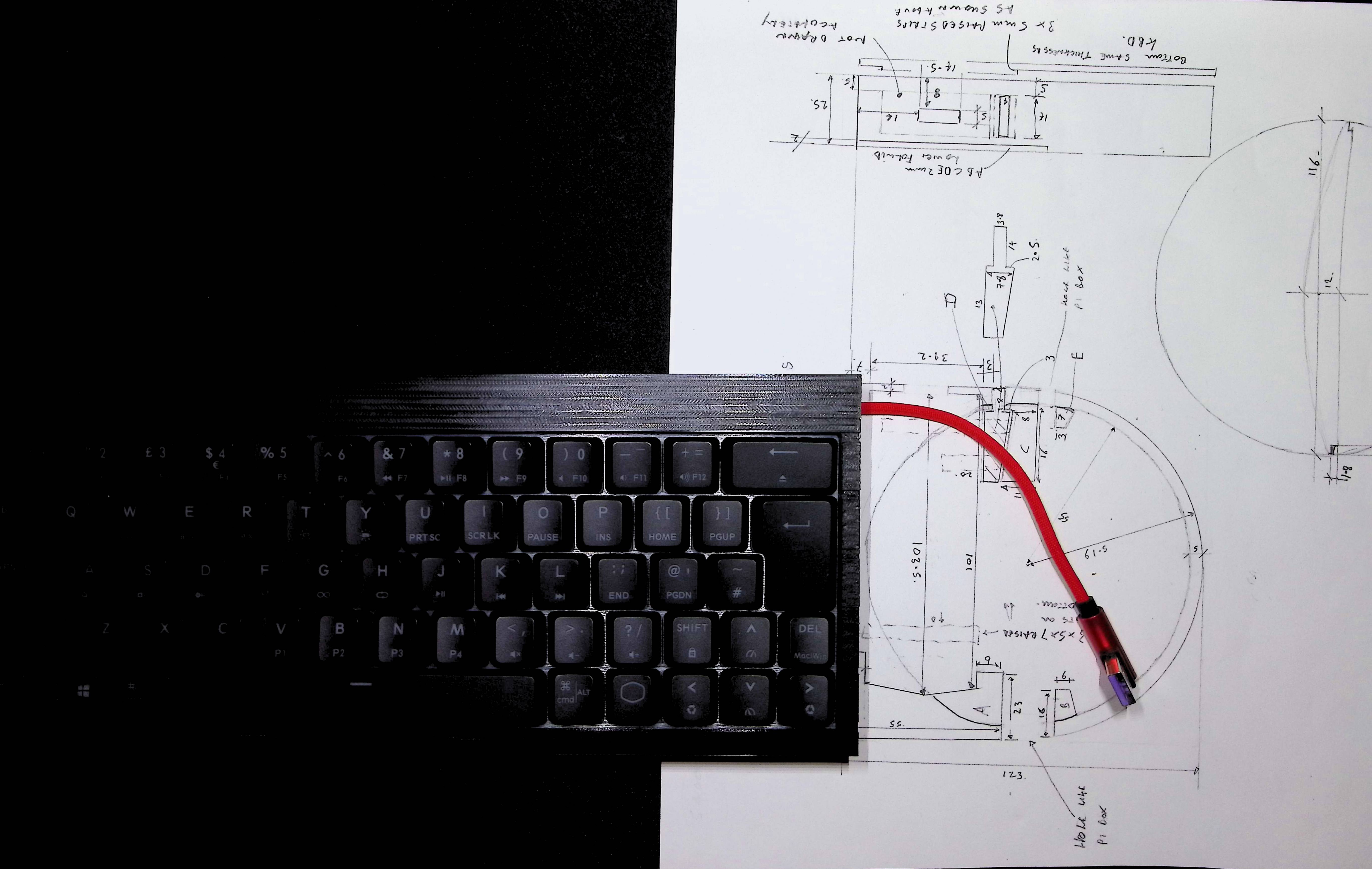

It seems the inside has been prepared for a raspberry pi and some smaller interfacing .
i will continue to search on my side , any help from your side highly appreciated .

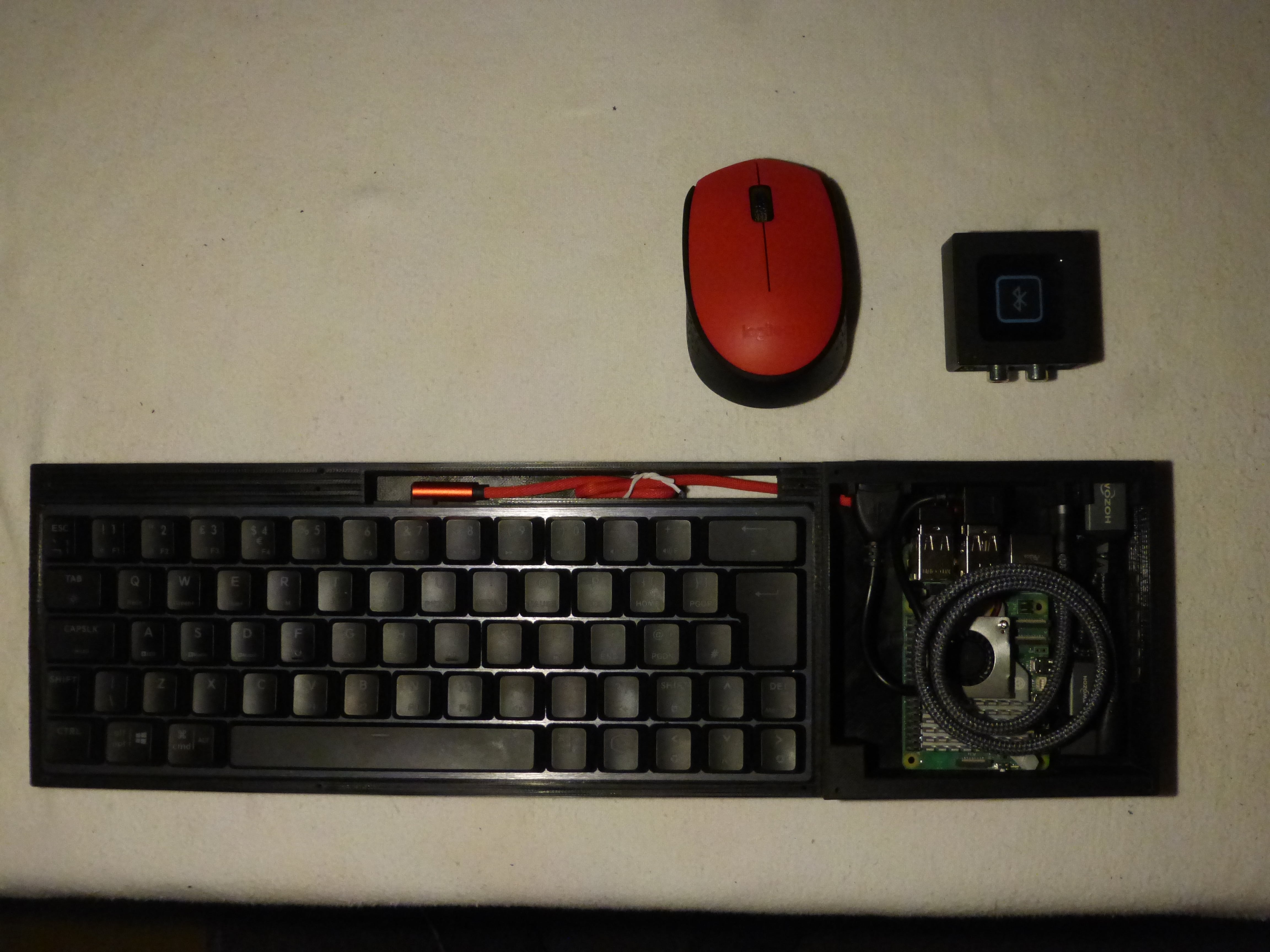

For what it's worth, here are my thoughts on your "QLwafer" project:-
I have run SMSQE in both a Pi4 and a Pi5. The Pi 4 is a bit too slow but runs SMSQE without problems. The Pi5 is much faster but needs a fan to keep it cool and has some display problems with my installation of SMSQE.
As you can see from the picture of my Pi5 fake QL design below, the Pi5 needs adapter leads to bring the HDMI, USB and USBC sockets to the outside of the case. My guess is, your box would need an adapter container to hold the Pi.

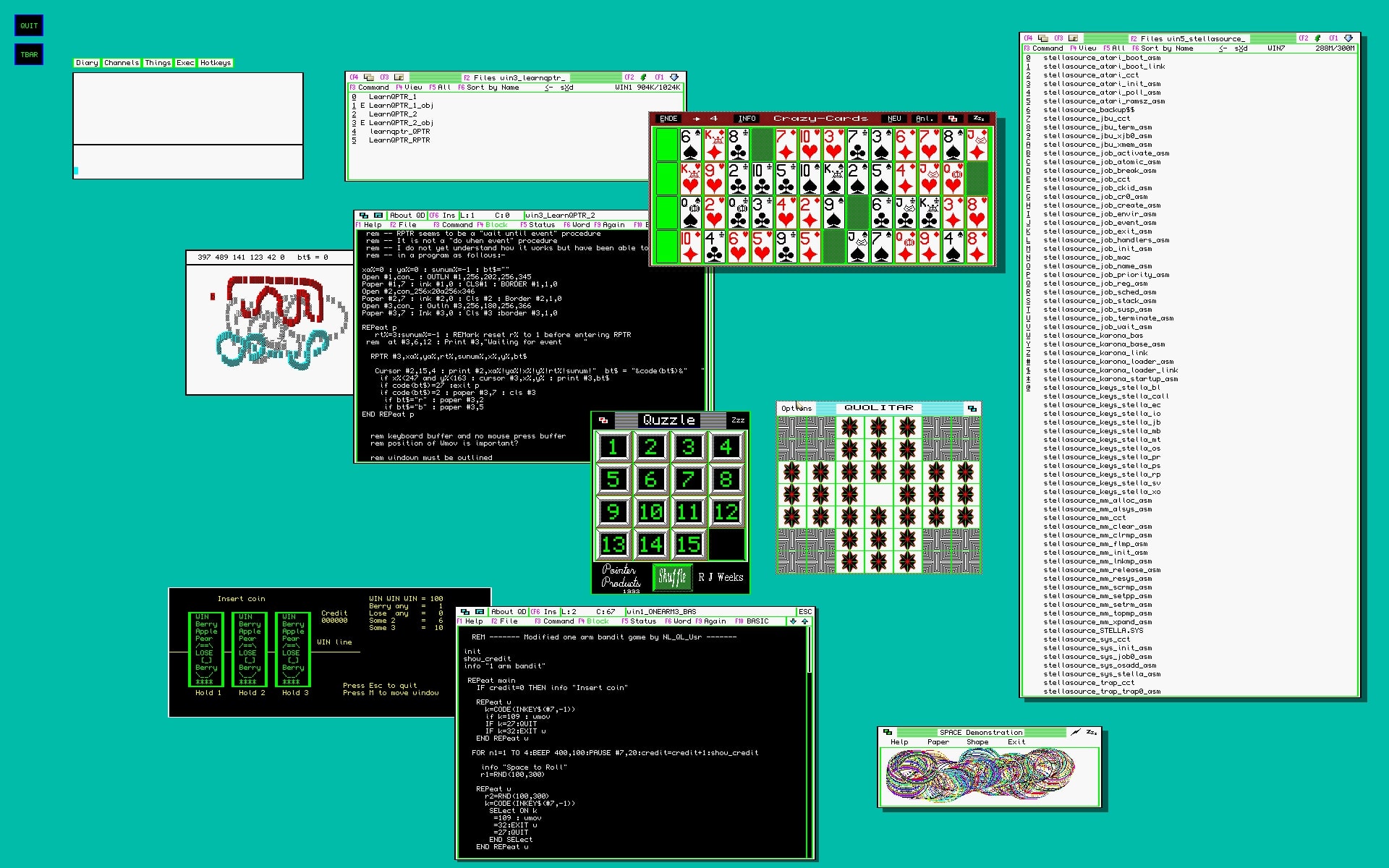

Getting a Pi to run SMSQE is not as easy as getting a PC to run it. If you want to run SMSQE at a high resolution eg. 1920 x 1200 (see pic) you need to run SMSQmulator for Java. When I find the time I will post the step by step process I used to do this on my Pi5 design.
The real difficulty is the QL keyboard to USB interface. This is why I have decided to
use a standard USB keyboard for my "not very QL wafer in PC" design I am in the process of making. (see 2 pics).
