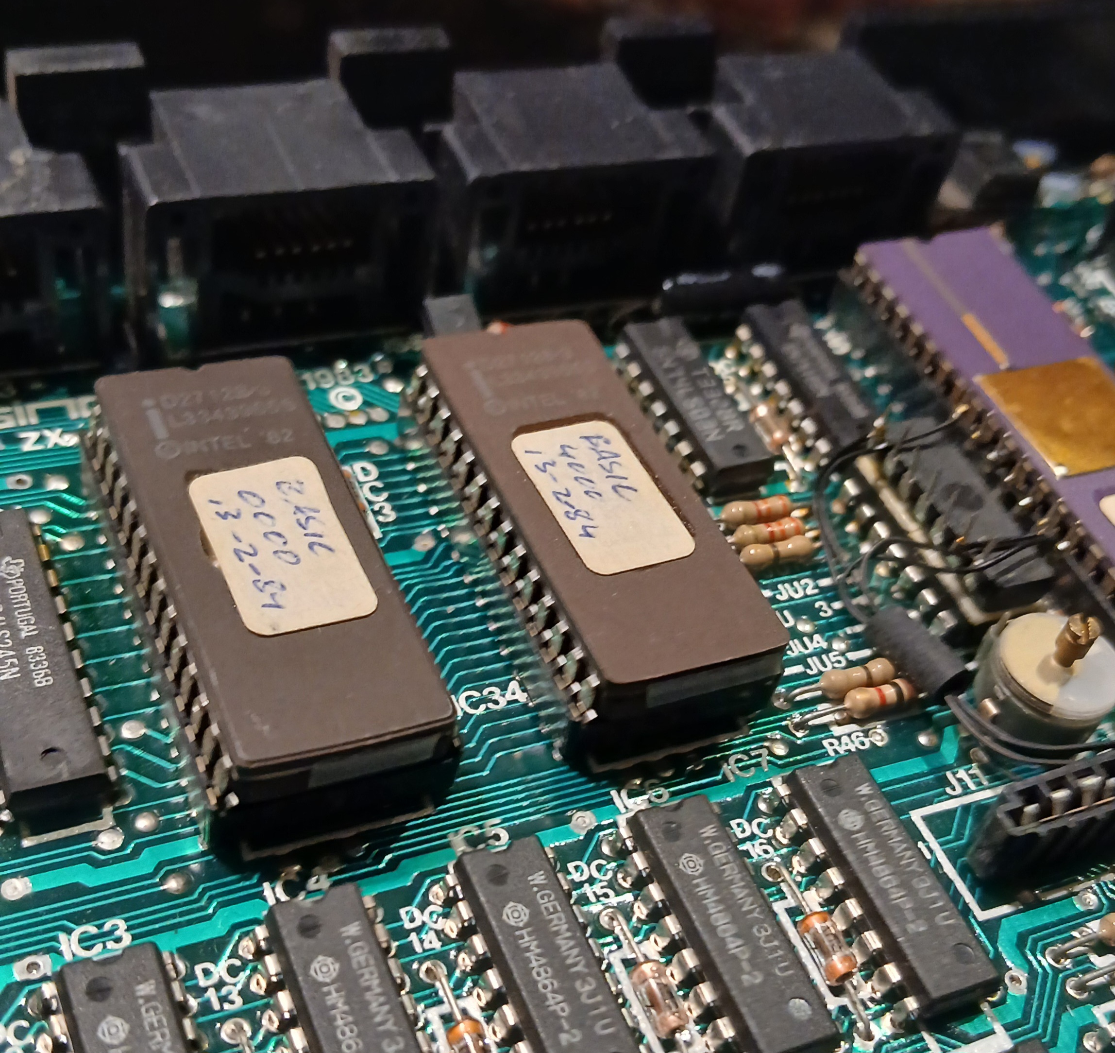

I agree with Chr$ if you have an eprom programmer than dump the roms, we can then examine them in dissasembler/emulation to see what they actually do!Chr$ wrote: Wed Apr 19, 2023 7:59 pm I think personally my next step would be to check the content of those ROM chips and of course try a known working pair (or single 27512 type), written with a ROM of the full 48kb. Those 27128 chips are both only 16kb (as mentioned before) so it's possible it had an external ROM dongle originally, which is now missing.
Might not be that easy though, as one is labelled 0000 and the other 4000 (and the code from 8000 onwards 'was' external. Normally they are 0000 and 8000 internally. So I think would indicate that addressing might be different. Someone else will be able to offer a better insight.

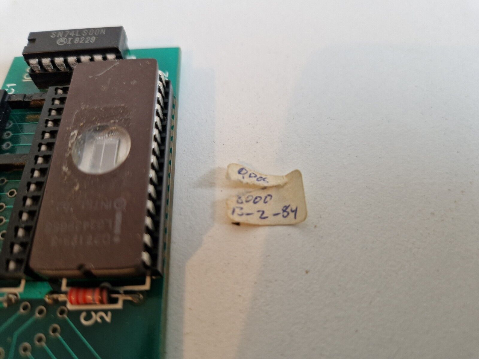

I did some investigation, tracking back the seller of this QL on ebay. There was a second auction from the same seller where theQLvsJAGUAR wrote: Sun Apr 16, 2023 3:25 pm - Most likely this QL came with a ROM port dongle holding at least additional 16 KB of the firmware (in a third 27128 EPROM IC), usually labelled 8000 (at address 8000 Hex). Do you have got a ROM port dongle or any additional EPROM ICs?
"Sinclair QL EPROM Cartridge Board with an EPROM labelled 13-2-84 8000 0D0C as checksum" was sold. Most likely this would fit to this QL computer with the ZX-83 PCBA. See picture. Key question is who the buyer of this is!?
QL forever!
- janbredenbeek
- Posts: 717
Re: New QL user & owner
That 'checksum' needs some investigation... Key question is how it's generated. I've tried byte-sum, word-sum (both big- and little-endian) and word-XOR on FB, PM, AH, and JM ROMs (8000-BFFF) but none of the results looked like 0D0C.QLvsJAGUAR wrote: Wed Apr 26, 2023 5:41 pm I did some investigation, tracking back the seller of this QL on ebay. There was a second auction from the same seller where the
- edit: the '0D0C' should probably be read as 'QDOS', since the other two ROM's stickers had 'BASIC' on it!

That‘s a very good read and conclusion, Jan.janbredenbeek wrote:That 'checksum' needs some investigation... Key question is how it's generated. I've tried byte-sum, word-sum (both big- and little-endian) and word-XOR on FB, PM, AH, and JM ROMs (8000-BFFF) but none of the results looked like 0D0C.

MetroZodiac was kind enough to sell me this ZX83 QL and I've just returned home with it. Credit to him for cleaning it up so well, it's in fabulous condition.
I've read the 13-2-84 dated ROM chip contents and those are attached in the zip file. Someone with better understanding of the ROMs can perhaps find out which version they are... I can see the text 1.00 in one of them with similar looking code after it compared to PM, which is great (or a red herring), but also a bloody shame if the last 3rd has gone to someone else and remains missing! Unless it's FB, for which the last 3rd is available.

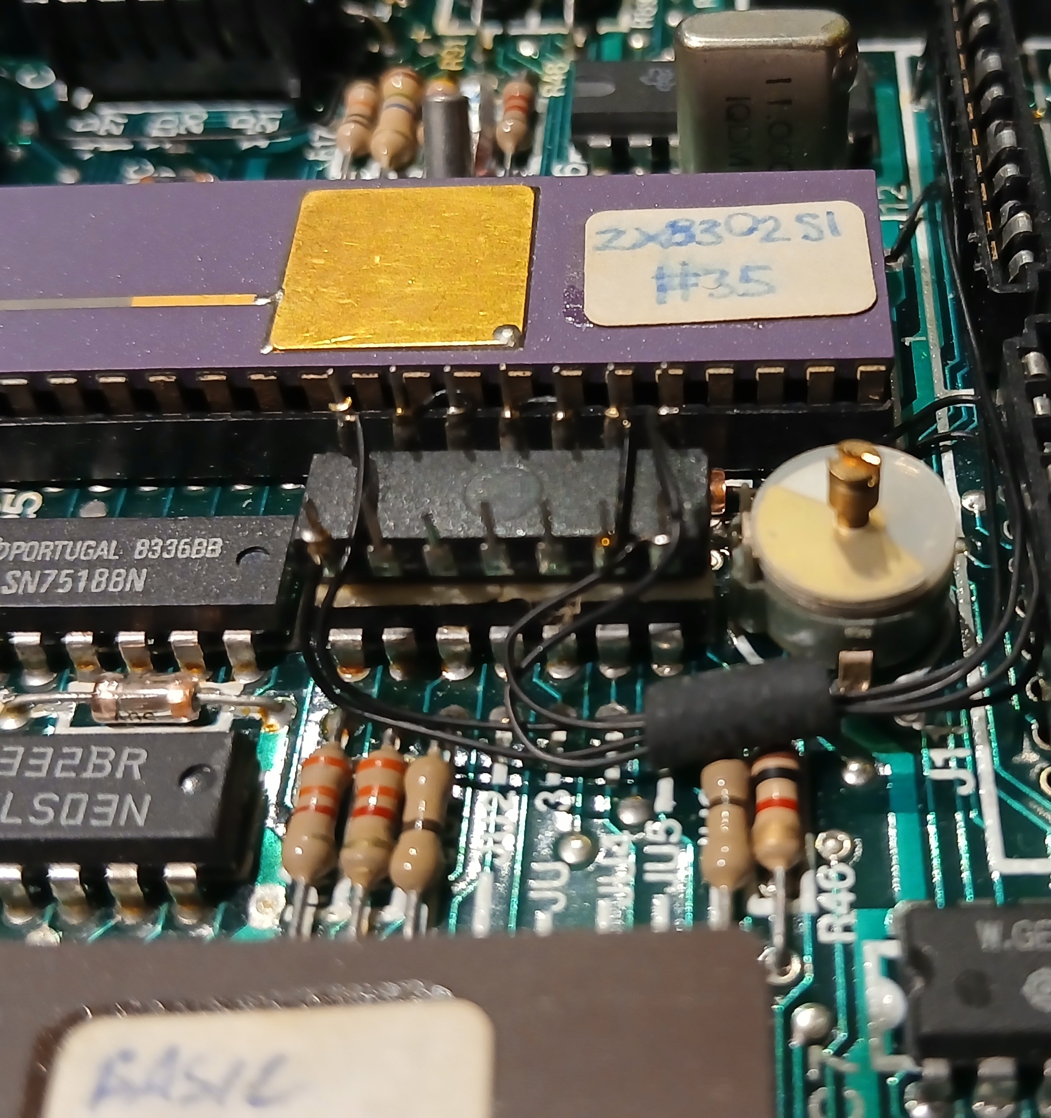

I've not powered it up yet. The 'cockroach' upside down chip is I assume a 74LS00 or something very similar, so unless anyone screams no, I assume for testing purposes that I can replace both ROMs with any other version all on a single 27512.
- ZX83 13-2-84 ROMS.zip
- (18.67 KiB) Downloaded 138 times
A 27512 EPROM won't work - as the sockets have VCC wired to where A15 should be. Instead - the masked ROM's that Sinclair used are a pair - one activated by a high chip enable - and the otehr by a low chip enable - and these use A15 on what would be the chip enable to decode the 32K and 16K blocks - the sockets themselves are effectively wired in parallel (this is why you can piggy back the ROM chips) and fit them to just one socket.
It is a shame Sinclair didn't wire the socket like a standard JEDEC Eprom - so that a 64K ROM chip could be used.
