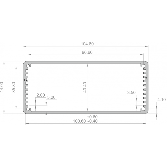

Here is drawings of the Rear Panel locating the I2C connector:

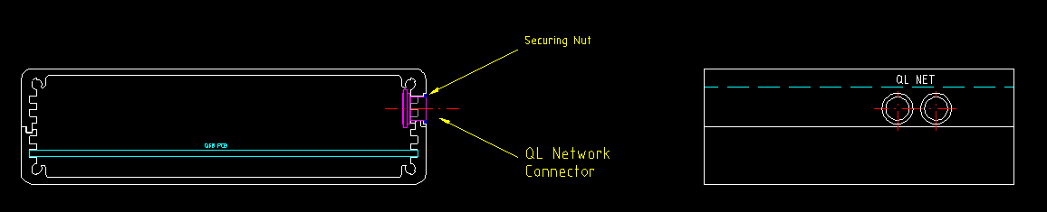

Here is the drawing showing the QL NET connection on the side of the case:
For clarity I have only drawn the barrel of the QL NET Connector. The curcuitry will be attached to the top case cover with enough length to connect to the Q68 expansion port.
The QL NET connector hole is 6mm dia. with a 8mm dia. x 1mm counter bore to accommodate the QL NET connector securing nut.
The Blue dashed line is the inside of the case.
This soft makes the case modular and similar to the QL NET modification I did for the later Q68 cases.

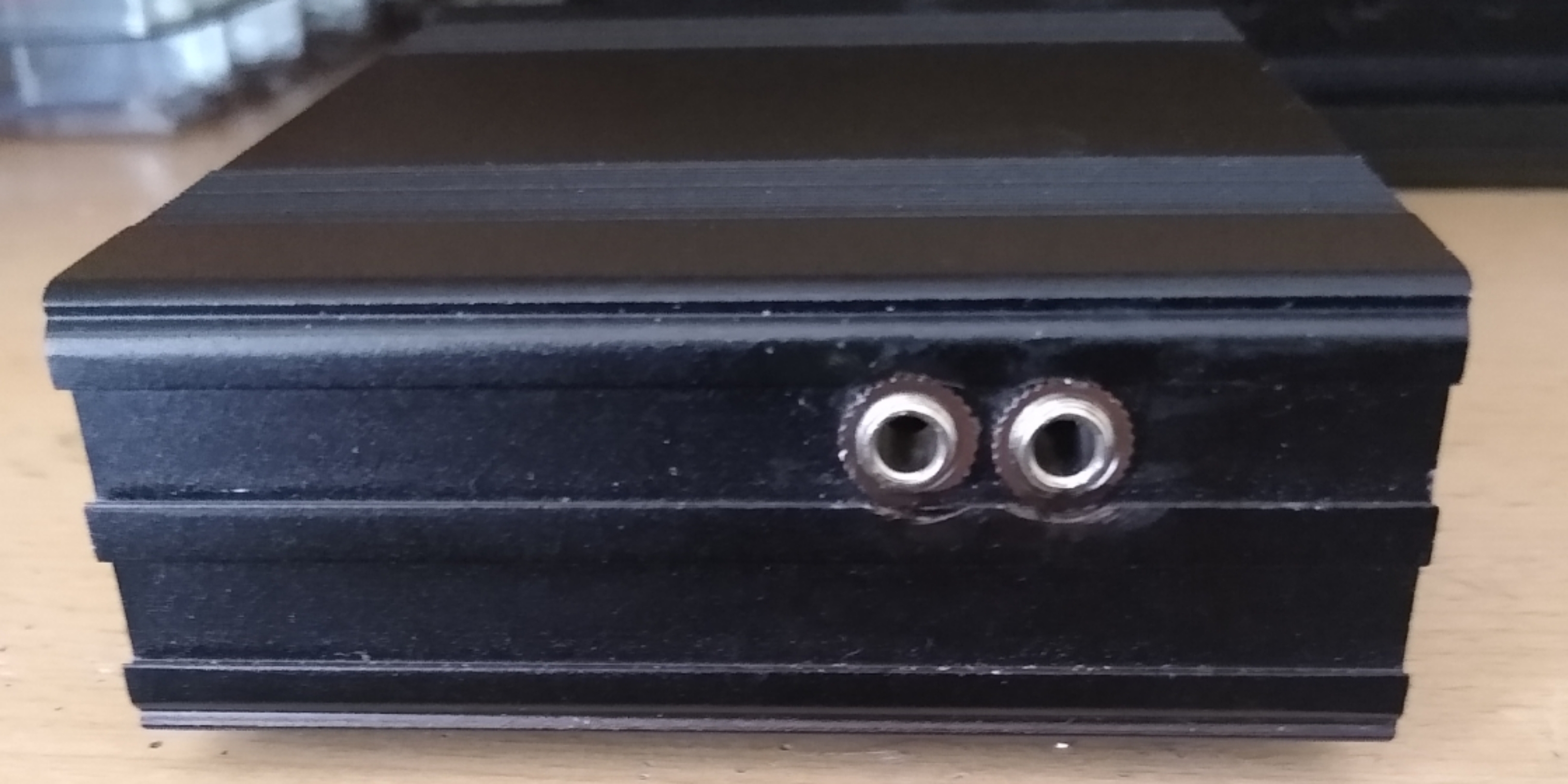

Here is the old Q68 Case from right hand side with QL NET connectors installed
