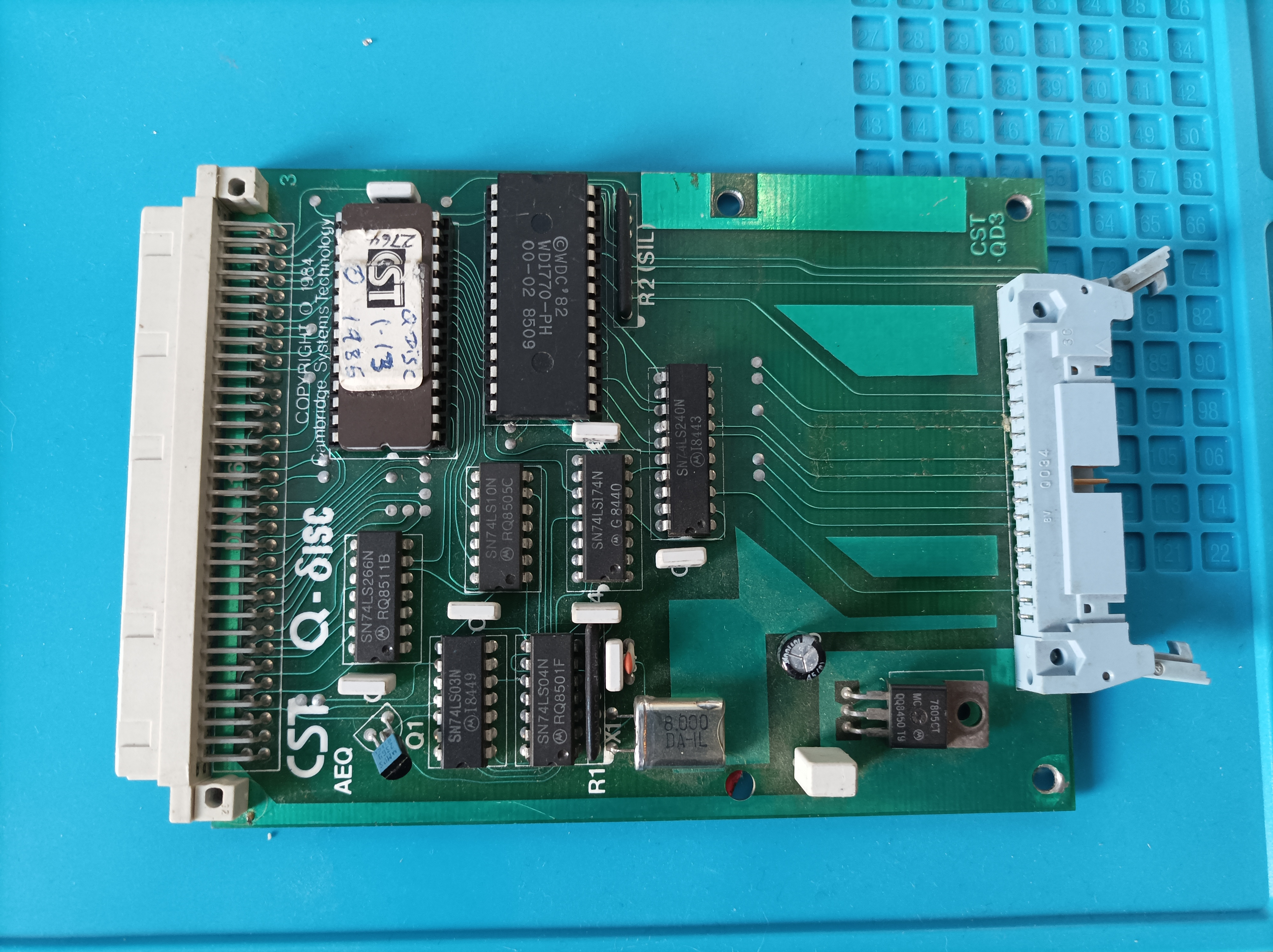

dilwyn wrote: Interesting: the QL Wiki only refers to three versions of the interface, with pictures of two versions - the later one shows an EPROM with a "v1.19 (1987)" label on the EPROM. https://qlwiki.theqlforum.com/doku.php?i ... _interface
My Q-disc PCB is labelled CST-QD3 with ROM 1.13 (c)1985, bought in '87.
The layout is - almost - as the Wiki image model '84.
The Utilities disc is V3.0 with Convert, Backup, Filed, Disced & RamDrive.
There is no mention of any version in the manual.
The question is, does a later v1.1x work in any PCB version?

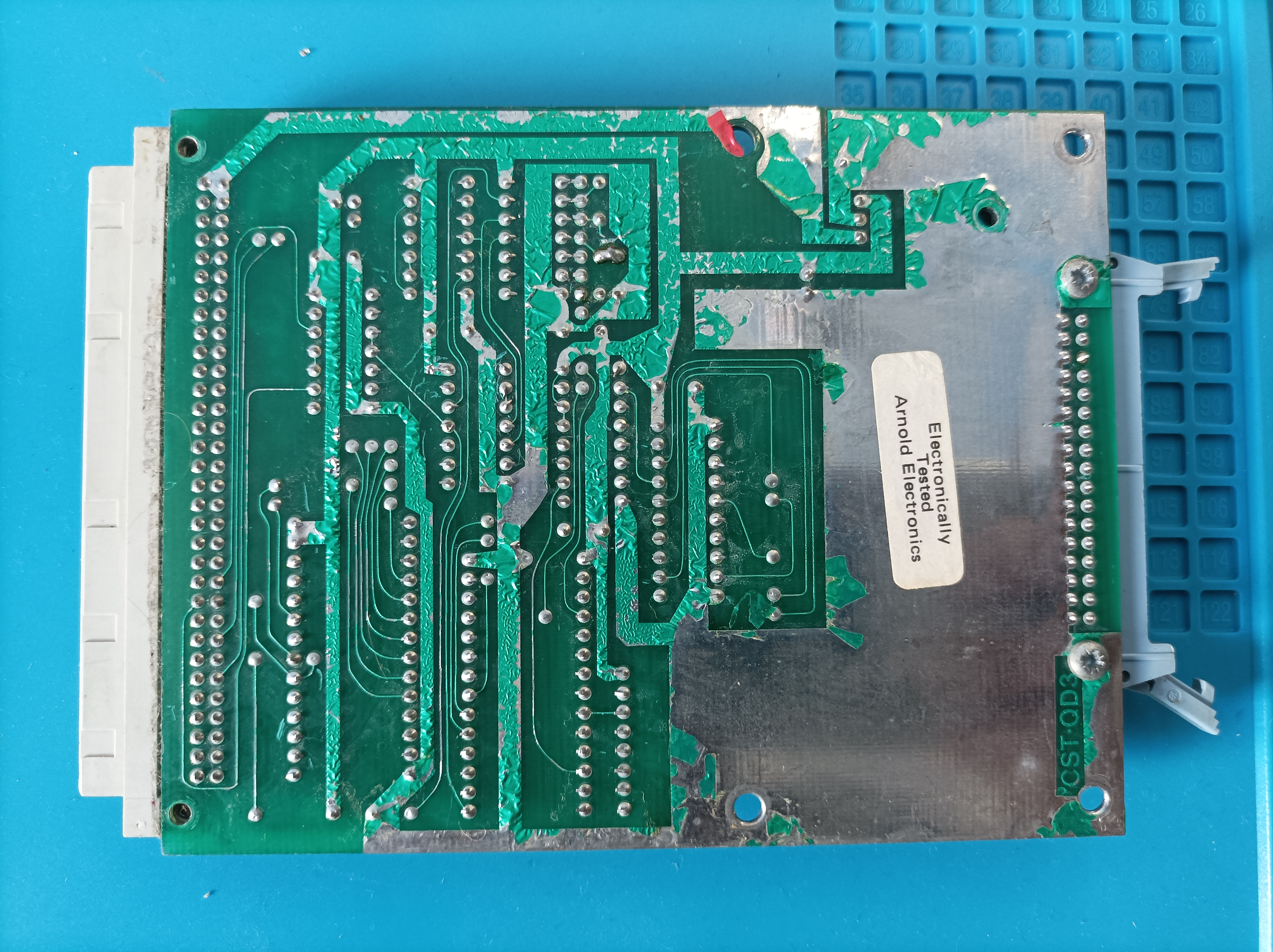

This is asking a lot - would it be possible for you to take a photo of the interface for me, showing both front and back of the PC. It would help me to align these manuals once and for all.

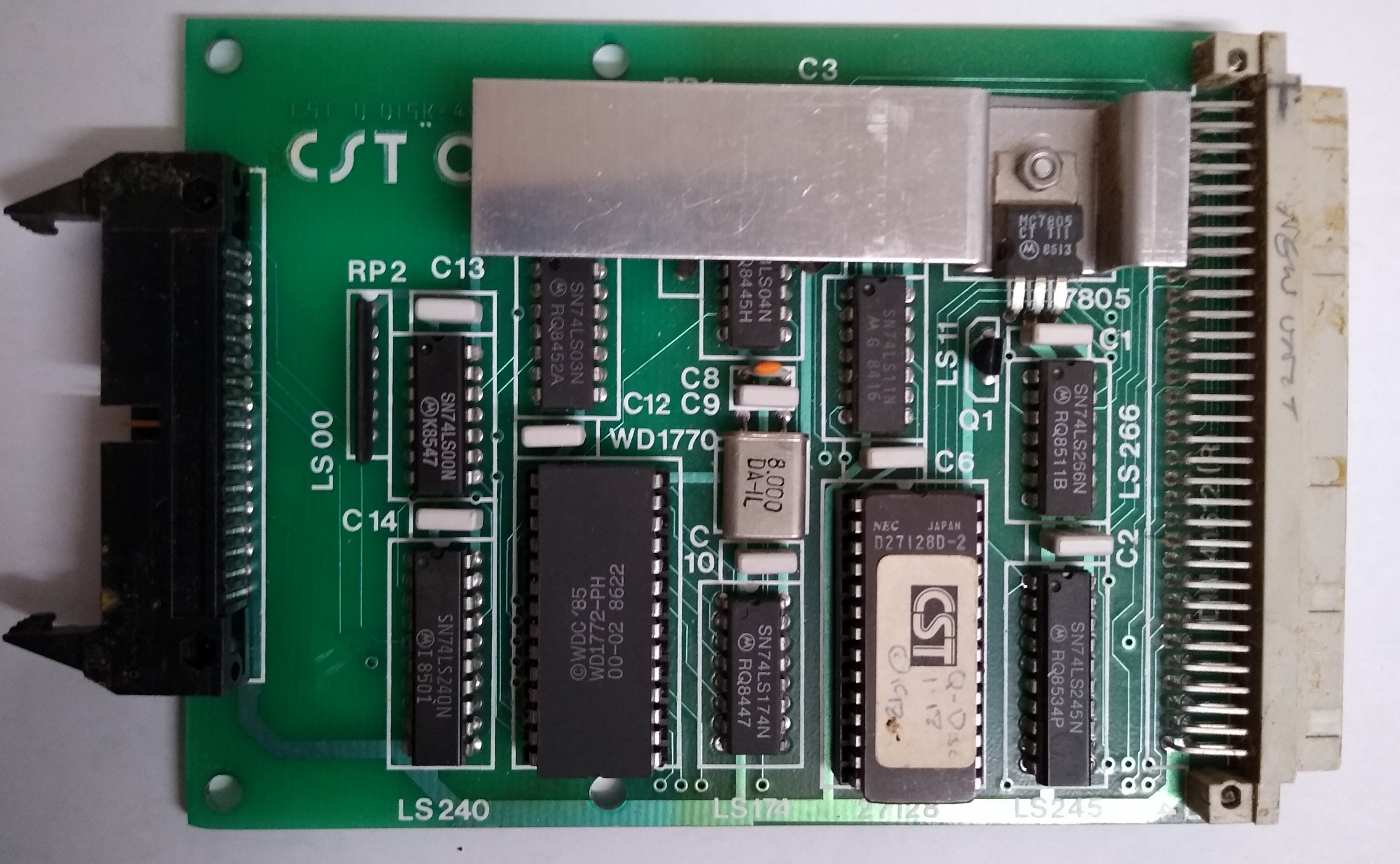

Hopefully these help, these are from my card. Which does seem to be missing the heatsink.

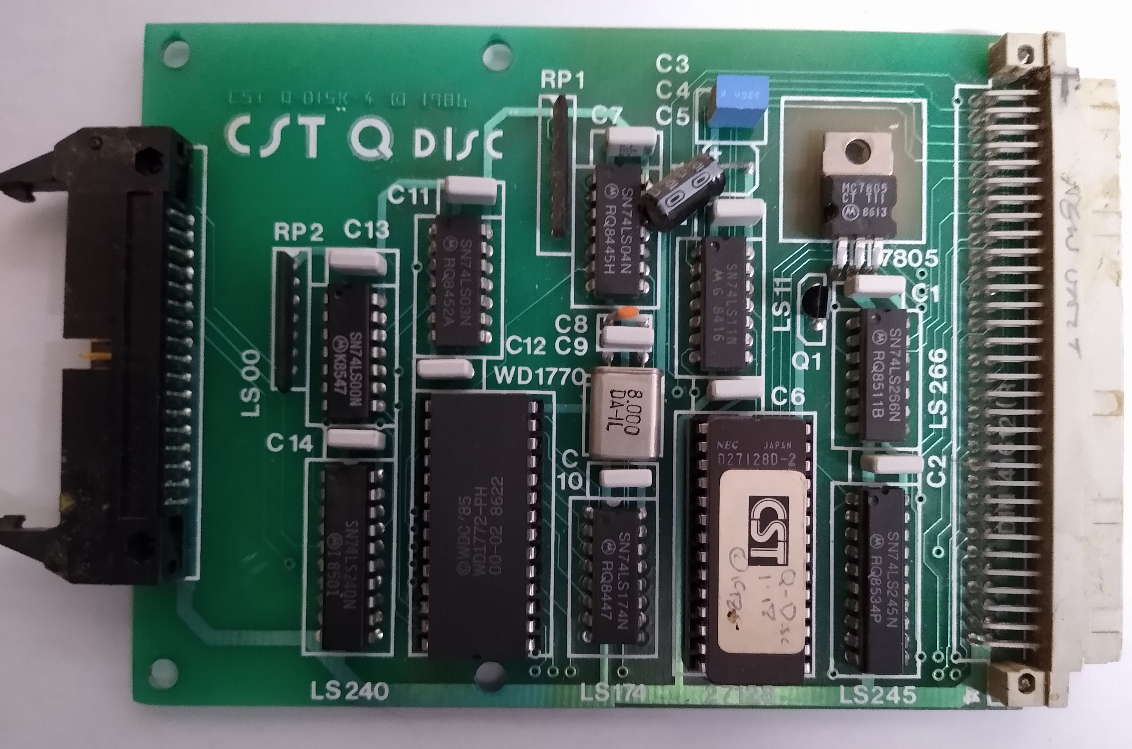

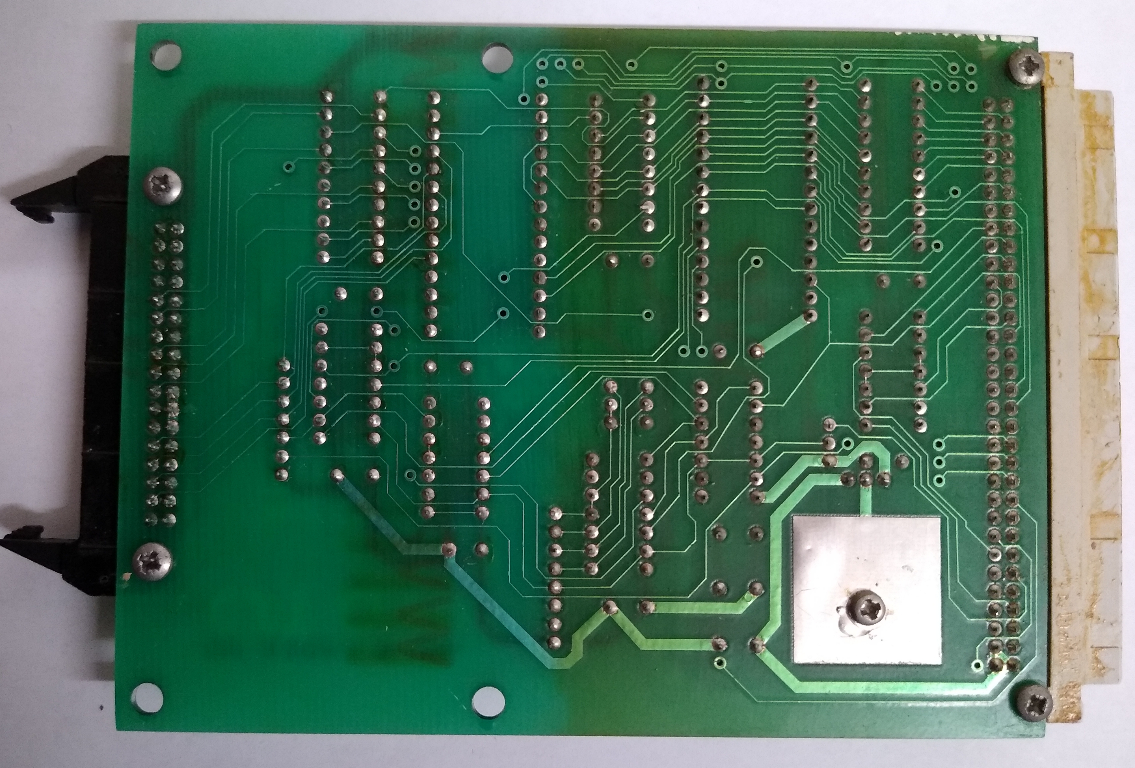

Here are some pictures of a Q-Disk 4 dated 2986, with a ROM v1.8
Top of CST Q-Disk 4
Top of CST Q-Disk 4
Here is a view without the heat Sink
Top of CST Q-Disk 4 No Heat Sink
View underneath
Bottom of CST Q-Disk 4
I tried to make a copy of the ROM, but the resultant ROM image did not look like a ROM image that I have saved from other QL Interface ROMS.
It looks like some sort of hardware encryption. To avoid copying the Q-Disk ROM, maybe.
Ithought about saving the ROM image with the Interface connected to the QL, but this may only work in a non-Q-Disk 4.

Derek_Stewart wrote:Hi,
How to you try to copy the ROM? Extract it an read with a eeprom programer? sometimes hardware designer swap lines in the eproms to do a easy PCB, shall be easy to restore to a readable form.
saving the rom space to a disk should work from inside of the QL.
Posts: 1647
Re: schematics for floppy disk interfaces
It cant be encryption with those chips, but it could be that the D0-D7 lines are in the wrong order, or less likely the A0-A23 lines are!
Posts: 2805
Don't forget that with later ROMs, the QEP III was available. It made it trivial to bit reorder the data bus pins to ease PCB layout. For this reason, a few interfaces from that time used the feature just because it existed. Look at the first four bytes and bit re-order them to get the correct ROM identifier, and that will be true for the whole ROM.
Posts: 4759
I had a look at the QEP III manual, which is a little lacking in a lot of places, but the Options Sub Menu indicate a Jumble option to jumble the data or address line.
The manual should of really describe the jumble function.
