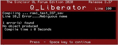

pjw wrote:I have tried to create a minimalist test program that would end up being compiled differently on 3.36 and 3.37, but to no avail (so far).
Try this one-line program ...
140 FOR a = 1 TO LEN(word$) : IF word$(a)<>" " THEN EXIT a
Compile this on v3.36, then again on v3.37
Posts: 1254
Re: New QLiberator v3.37

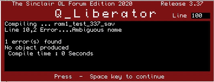

I have compiled it under QPC2 with 3.36 and Martin's original decompiled 3.36, same error:
BTW: would be good, if QLib can say, which variable is undefined.
Now compiled with 3.37:
Makes me wonder..... 10,2 means, it does not recognize the "TO" statement...?

On my setup, it just compiles without any error message - on v3.36
Try this instead ...
100 word$ = "some word"
110 FOR a = 1 TO LEN(word$) : IF word$(a)<>" " THEN EXIT a
Try to compile this both with 3.36 and 3.37
Posts: 1254
Just have added 3.37 to my last post...
The different line number...?
Posts: 1254
EmmBee wrote:On my setup, it just compiles without any error message - on v3.36
The same compile error.

I've just discovered the error is caused by my skip_Top_Line_Remark routine at line 32492 in v3.37
Besides storing the file position, recording and then restoring the variables sym1%, sym2%, sym3, etc. seems to cure the problem.
I'm currently in the process of checking all the code out for the v3.38 update.
