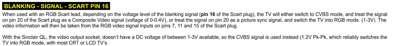

So I found this diagram with instructions which seem perfect:
https://www.retrocomputershack.com/SCAR ... index.html
Specifically the connector diagram:
And the specific line on pin 1:
So first off, this seems to be talking about how SCART that comes built-in to a monitor operates with regard to SCART pin 20 having high or low voltage causing SCART (and thus the monitor) to either go into composite or RGB mode. I suppose, perhaps, with the US model having the DIN-8 pin 1 (which is used on SCART pin 20) be a constant 5 volts, that makes more sense for building cables like that since the signal is guaranteed to be above the low voltage and even above the high of 3 volts in the description which then forces SCART to pick RGB mode. So if anyone ever tried to hook a US QL to a monitor in the UK that supported both composite and SCART, the US QL would only show a proper RGB signal on that monitor and avoid composite since otherwise it would feed an incompatible NTSC signal to it causing the image to scroll (that is my hypothesis as to why US RGB is different from UK).
Some questions:
Some questions:
- Am I reading that correctly with regard to SCART going into the two different modes?
- I'm guessing here that the US models kept the signal high at 5 volts to force the RGB mode.
- Does that seem like valid reasoning as to why the US was forced high (i.e. trying to solve that mystery)? -- with no PAL in US market at the time and no one likely thought of LCD monitors that could handle both in the distant future so the US RGB was re-designed with the high signal only so that SCART would always choose RGB mode?
- For making a DIN-8 to SCART cable where the SCART only goes into an upscaler, does the blanking signal still matter?
- Do upscalers make the same internal decisions that SCART monitors made or is it dependent on what type you have (I have a cheap SCART to HDMI for instance)?

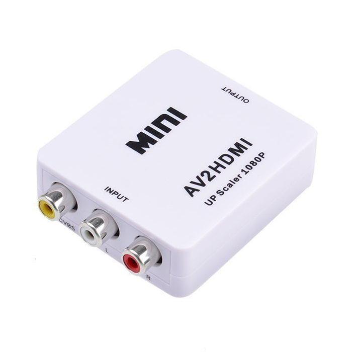

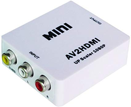

I have a bunch of these cheap up/down scalers (av2vga, av2hdmi, hdmi2av, hdmi2component):
I tried to use my color-composite to go from av2hdmi. The results weren't good. The picture was also black&white with lots of interference where the interference actually added little specs of color everywhere. It reminded me of watching a black&white TV show from the 60's on a bad color TV where it can't avoid some color adding.
So it was a bad color picture that didn't use the color of the source. It did show, for one second, a solid red and white image on booting to F1 but then the monitor just said "nope" and went to its dislike for the color-composite signal on my machine.
So I can't use the AV (color-composite) to upscale to HDMI or VGA. I just got an inexpensive SCART-to-HDMI one but am still waiting for a male SCART connector so I can make that RGB-to-SCART cable and then will see what sort of image I get.

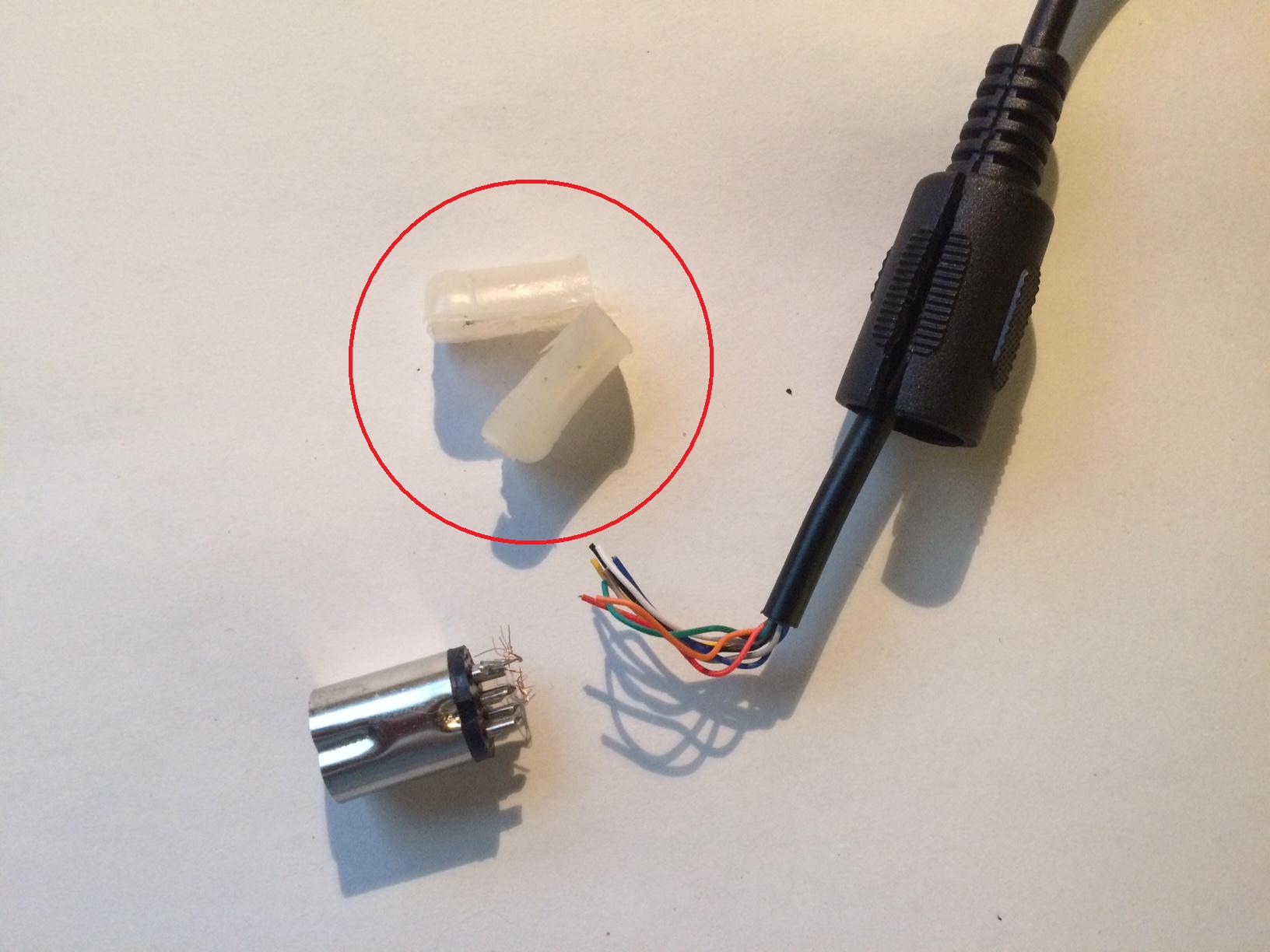

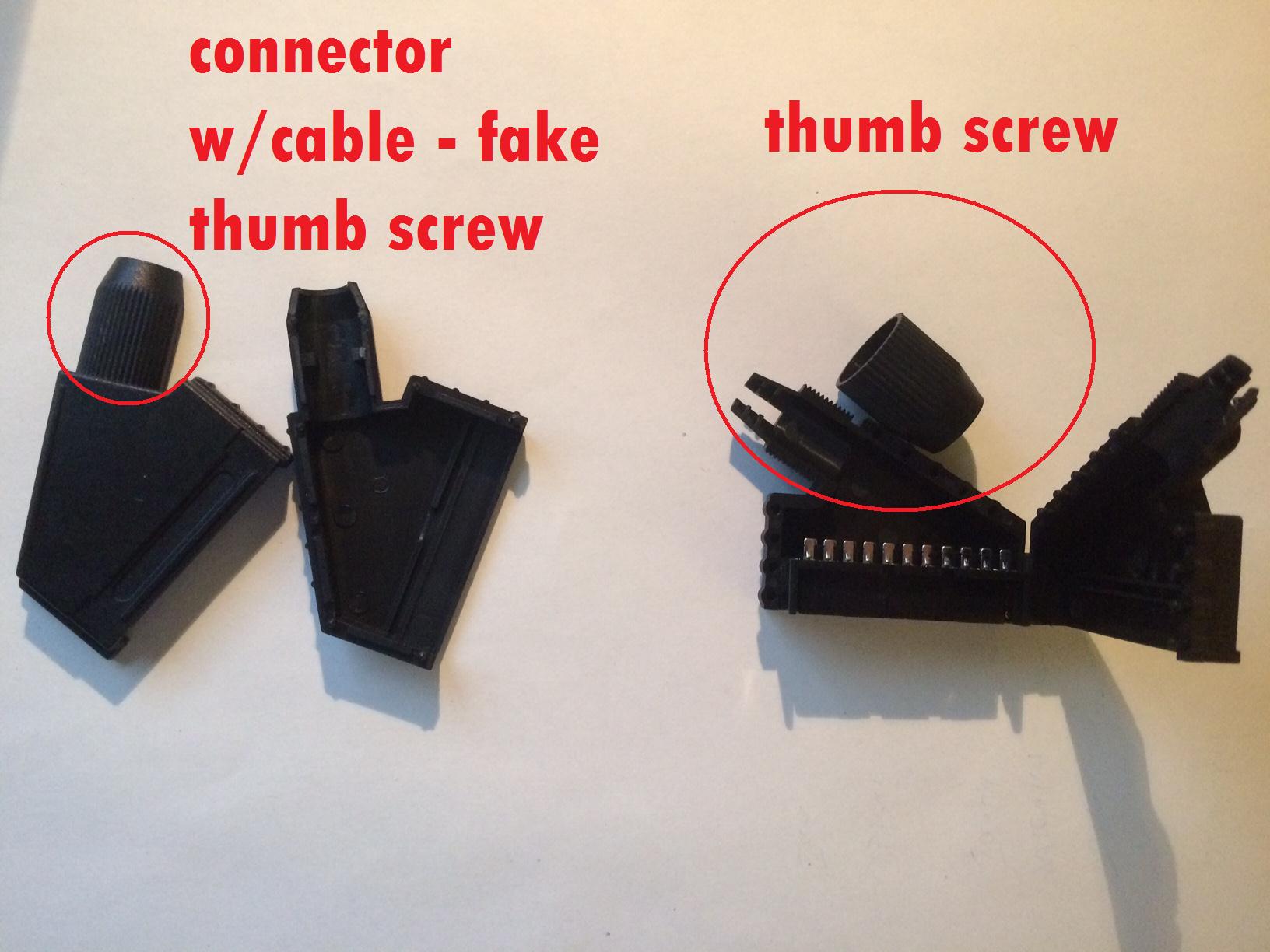

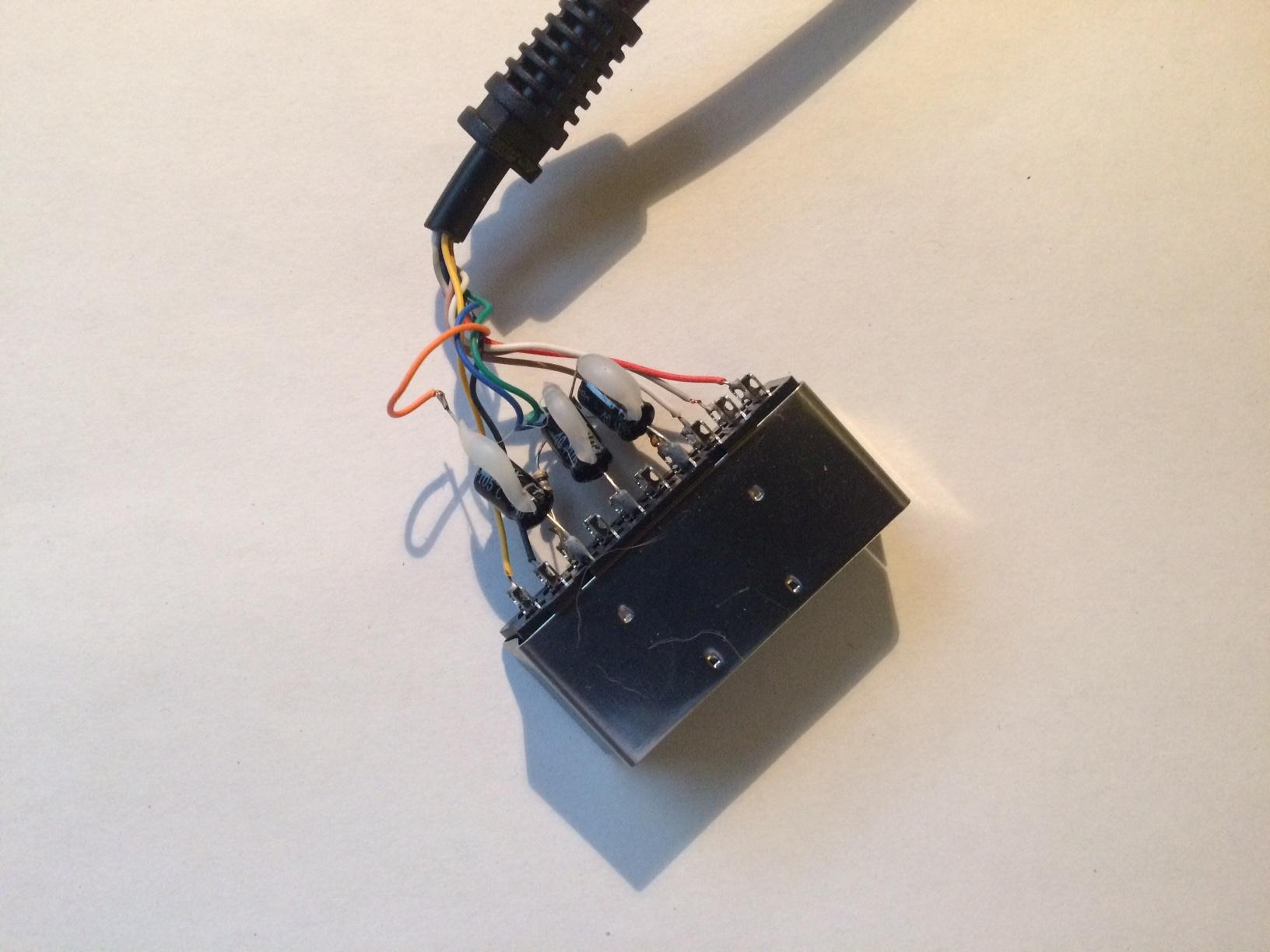

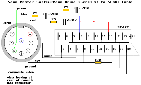

So my RGB-to-SCART cable came in today. It cost $2.95 (looks like they just added 50 cents shipping) and is for the Sega Master's System:
https://www.ebay.com/itm/RGB-AV-TV-Cabl ... 3380795198
It's not quite compatible with the QL's connector as the Sega even uses different pins for color:
So I took apart the cable. The SCART plug luckily just snapped apart though the top thumb screw was fake (I had a female connector that came apart and the thumb screw held it together) and is easily solderable:
So the DIN-8 though was weird. I had to cut if apart since it was molded on. Having done that with the QL power connector I know that if cut carefully that I can use Crazy Glue to close it up again and it will hold and look nice. I didn't expect to find a big blob of glue-stick neatly molded inside of the outer casing and covering all the wires...had to cut that off.

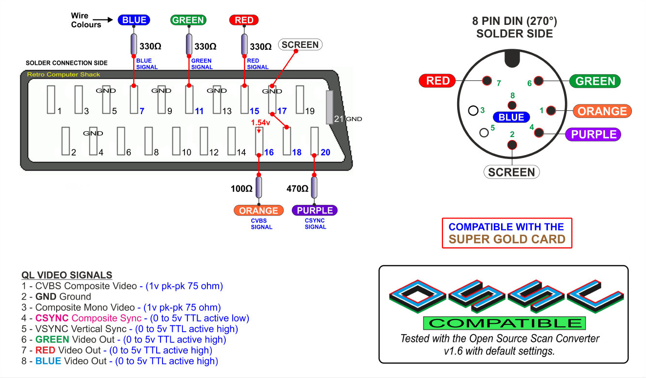

So now I'll create the QL RGB-to-SCART cable according to these instructions:
If I want to also add diodes on the DIN-8 end, anyone know what type I should use?

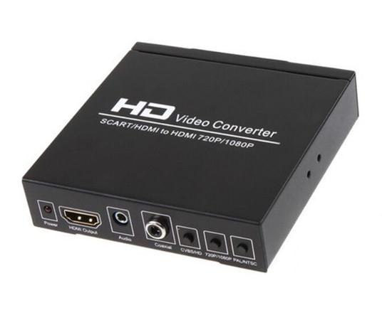

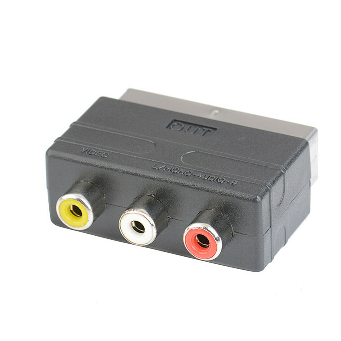

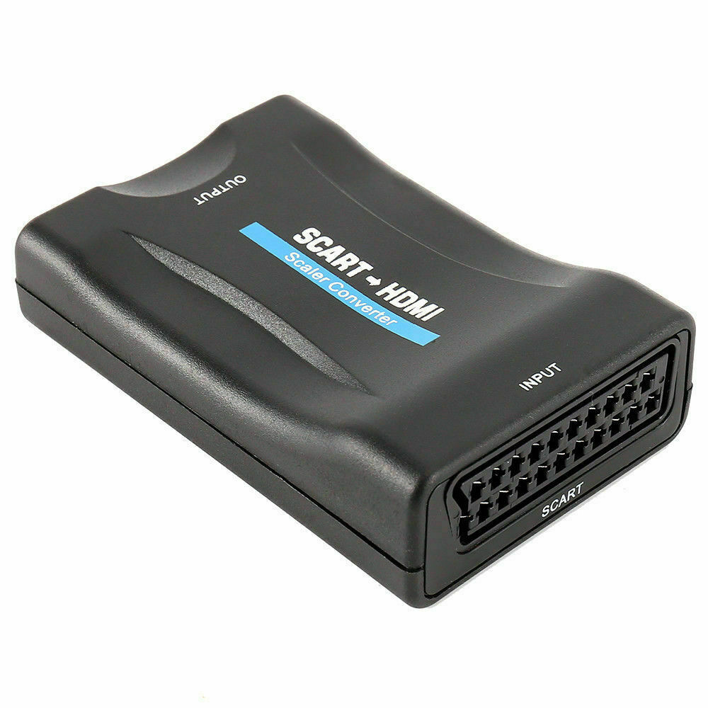

Still in search of that color monitor picture. I finally built my cable to spec and tried it on this:
Well, I got a faint image that looked like a grey scale embossing. So I figured it likely was trying to take the Composite CSYNC and display it as composite.
To test this I tried this:
But coudn't get it to work. They had sent the wrong one and instead of in/out switchable they sent it only in one direction. As it turns out it was in the out direction so pins 19/20 for video were swapped and so were 1/2 and 3/6 for audio. A quick re-solder and voila, finally got an HDMI picture via composite and as suspected, the SCART-to-HDMI is merely one of these in a different connector:
Cost about the same so now I have 2 things I can't use. I think my RGB-to-SCART cable works but I just need to get a "real" SCART-to-HDMI converter. It seems one of these might be more legit:
You can get them for about $24 on eBay. Any particular place I should look for or are the all about the same? Trying to avoid getting another dud.

They all look the same but they are definitely not. Not only that, Tobias has one that works for him that doesn't work at all for me. So no, there is no sure way to know what you're getting and I was so tired of trying that I created the only dedicated QL solution with QL-VGA. Problem is, I'm not selling it yetbwinkel67 wrote:You can get them for about $24 on eBay. Any particular place I should look for or are the all about the same? Trying to avoid getting another dud.
