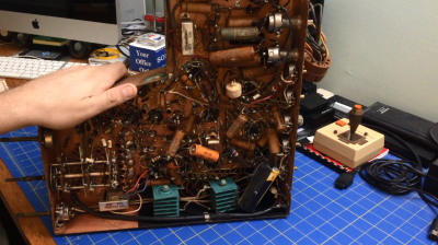

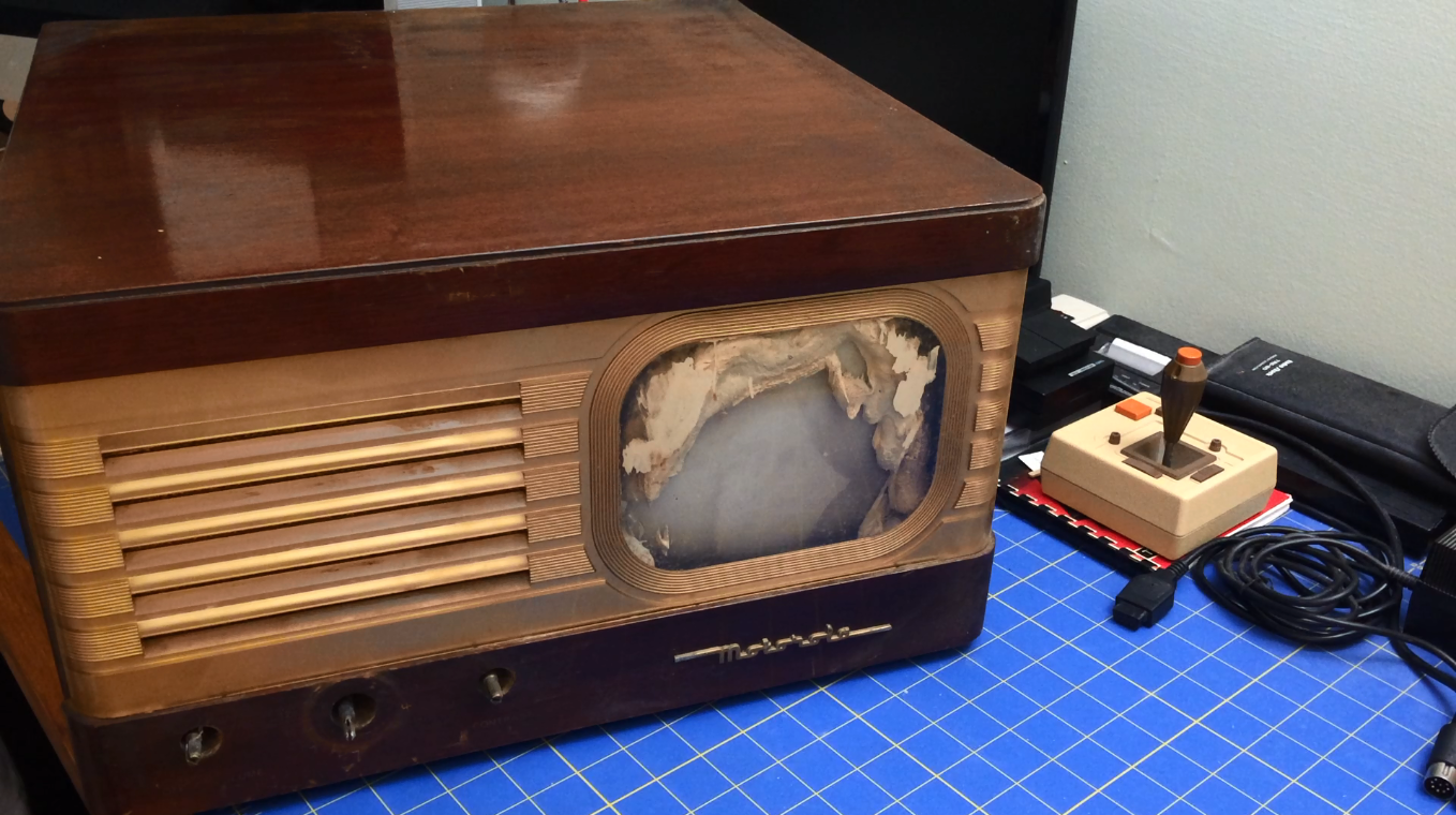

In the meantime, I've been keeping busy with this beast:

Right now I'm refurbishing the case...I got all that putty on the screen off. It slowly melts with water but is very sticky and gummy otherwise. It took a long time to remove it form the wooden case. Now I'm re-gluing parts of the case. Then on to check the tubes (one is missing), and finally replace all those capacitors. After all that, I will plug it in, step far away and turn it on...likely while outside.
