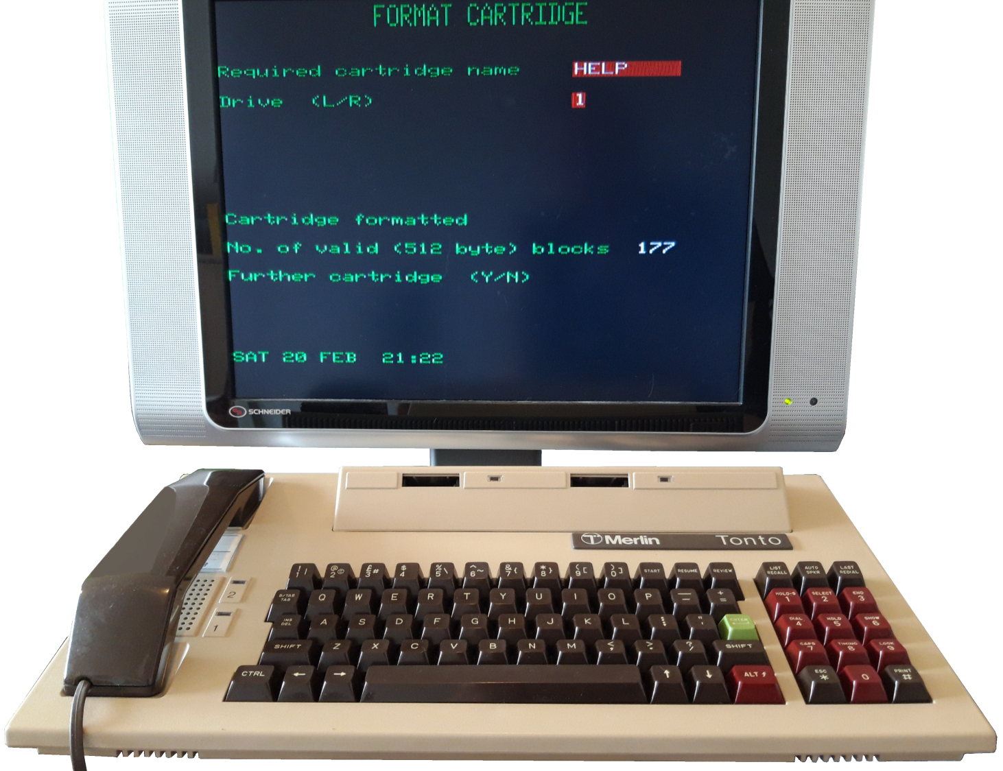

Do they have proper labels? Let's see then. Show me yours and I'll show you mine...
Posts: 1257
Re: ICL OPD
Great crisp monitor view!
I have to look, where I have the cartridges but I think, the labels are all handwritten.
Bad cartridge, I think ;)
Posts: 1401
Re: ICL OPD
RalfR wrote: Bad cartridge, I think ;)
Yeah, 177 sectors won't cut it. The same cart was 215 sectors on the QL though. It's all totally inconsistent. I've cleaned the heads and the rubber wheel. Sometimes it formats around 200 sectors, sometimes it doesn't (and the right one doesn't do anything as mentioned).
