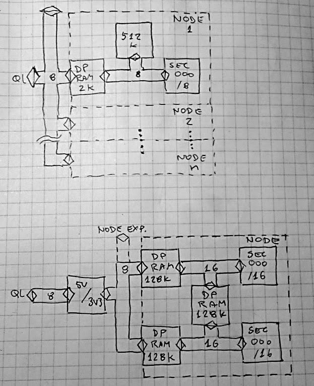

Posts: 2816
Re: Symmetric multiprocessing...
Now, to be fair, Nasta has poured scorn on my ideas, in private. While my proposal is simplistic, it is easy to implement, requires minimal development, and so actually has a chance of existing. I always try to remember that Nasta forgets between breakfast and lunch more than I'll ever know about the QL in two lifetimes.
That said, he does raise interesting questions...
How might an OS detect how many nodes are present, and their configuration and capabilities? How might an OS issue tasks to such a node? Is this the most efficient way? Is there a way to have a node write directly to the screen RAM?
He corrected me when I said "256K per CPU" when I should have said "128K shared to host and 128K shared to peer" - because between two peers there is not 512K of RAM, there is 384K of RAM. 128K is common to both CPUs. He also corrected my bad block diagram above with the following:
Drawn by Nasta
Drawn by Nasta
Posts: 2513
