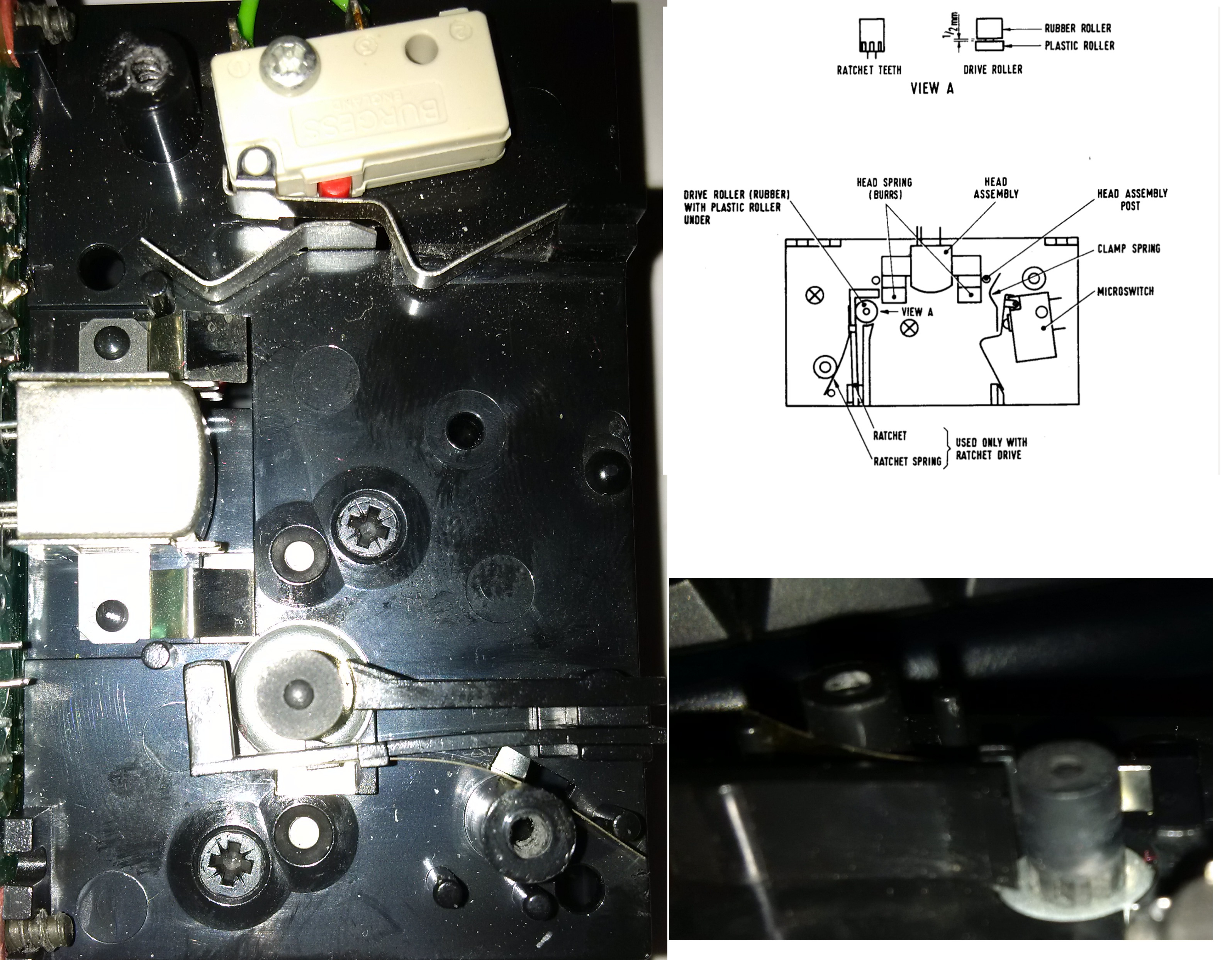

Hi Tomas
The ratchet was to stop a loop forming when the cartridge was inserted - once it is it moves the little ratchet out the way - you can just about make out the toothed bottom in the photo and of course on the diagram from the service manual.
I assumed the roller was damaged initially which is why I swapped in a ratchet one but, it almost seems to be made that way but, is very smooth and hard and it was strange the bump was in the middle - unless someone read on the net about turning it upside down without realising the implications of such bad damage being inverted - I wonder how many cartridges they destroyed before abandoning it.
Tim

Hi Timbucus,
The drive still does not format on ZX?
You mentioned some elyts and polystyrene caps replacement, r/w head seems alright.
How can ULA influence formatting, as I always though it as two channel operational amplifier and signal FM merger for reading `0' and `1' from two tracks.
Tomas
