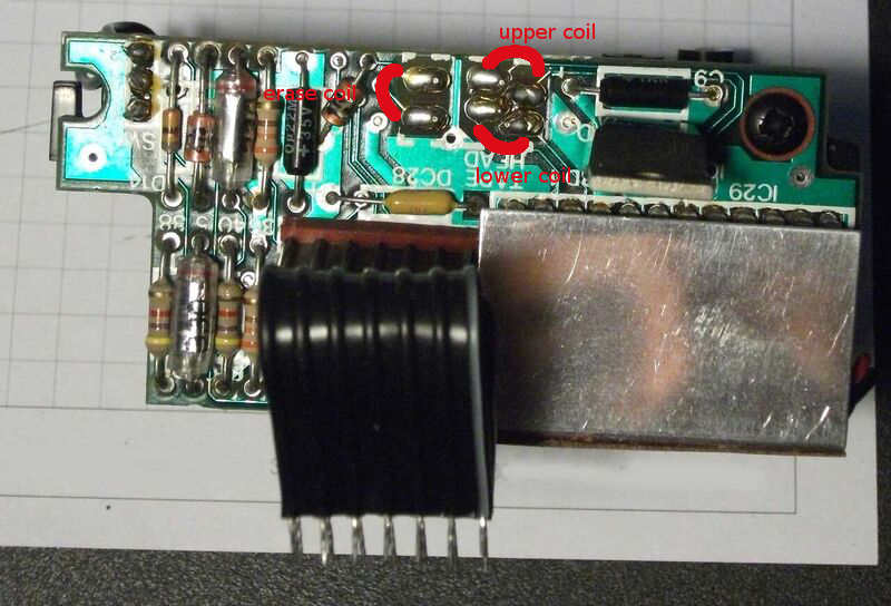

You seem skillful with your multimeter, can you try measuring the coils, to see what values you get on Iss#5,6 heads?
I will also mount my last r/w head here on one of Iss#5, so we could compare results then.

There are some contacts behind the head:
https://www.dropbox.com/s/bpnjs2pdf88m9 ... A.jpg?dl=0
could you tell me where exactly should I put the test leads please?

EDIT Upper, lower, and erase coils.
md head solder points
Tom

Thank you once again Tom.
Here are the measurements (multimeter selector placed at 200 ohm).
For straight-edged microdrives, respectively mdv1 and mdv2
Upper coil: 15 - 15
Lower coil: 16 - 15
Erase coil: 93 - 93
For "standard" microdrives, respectively mdv1 and mdv2
Upper coil: 15 - 15
Lower coil: 15 - 15.5
Erase coil: 97 - 99
Two more "standard" microdrives in my possess, respectively mdv1 and mdv2
Upper coil: 15 - 15.4
Lower coil: 14.6 - 15.3
Erase coil: 92.6 - 98
