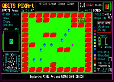

Hi bwinlel67 and Andrew, Hope this help from QBITS Intro with the setup of QPC2 and Config file created on choices made with QBITSBoot.
Amdrew the Screen layout does take a bit of getting used to but I hope the pdf notes help explain. This is me rather than pulling up several screen Modes as I wanted to link as much as possible to create a logical flow. FONT Input and resize : SPRITE Gen then to TILE and SCREEN layouts.
The WIP sets being Actions and a final Trial Play of Created Retro Game.

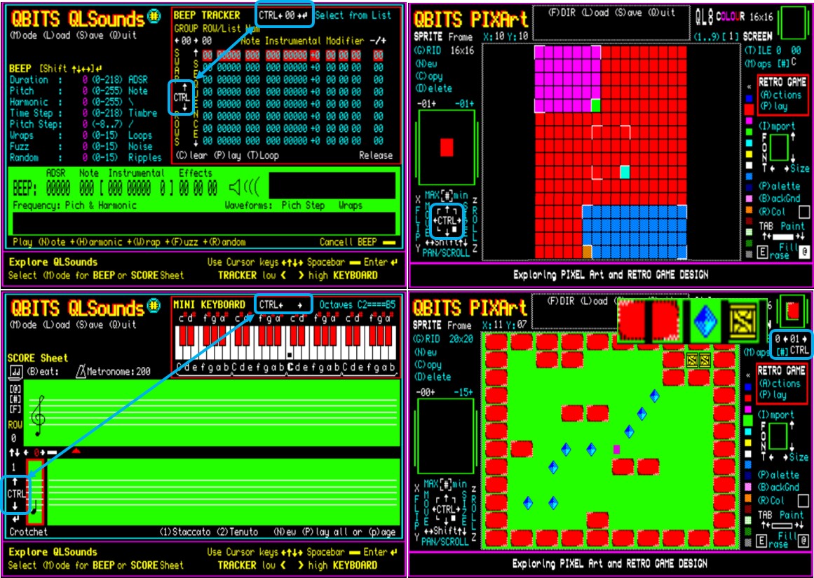

ALT swapped for CTRL this should get over the problem with those of you using tablets etc. QBITS QLSoundSE and PIXArt files attached.
The Left/Right CTRL Cursors for TRACKER row & SCORE entry in QLSoundSE match up with CTRL UP/Down cursors used with Row swap and Symbol Note/ Rest etc.
For PIXArt in SPRITE Mode CTRL cursors control the Edit area of the current Frames where you can use @ to Fill or E to erase a coloured area. Add a new frame and Copy a whole frame or selected edit area to it and build a composite Frame from many parts.

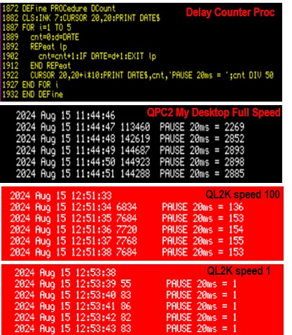

The method I used with my Keyboard demo was to base timing on the QL DATE function. First start when a second ticks....
Then ajust the 'Wait' function: Count the number of FOR loops used until DATE ticks again. On my machine, one sec counts around 1E6 loops.
On other machines you will get different 'sec' numbers, depending on processor speed and multitasking overheads, all equivalent !
So theoretically, you can time accurately to say 1/64 sec, reducing that figure to compensate for slight gaps to distinguish notes...
I am going to load DATA for Beethoven's 'Pathetic' melody soon, in trilled duo mode, so all can hear the results. Regards, Steve.

I tried something along these lines, but thought the result to variable to improved upon PAUSE across different platforms. Re-run them to day the first result is with QPC2 ruining on my Desktop, second with QL2K at times 100 and then at QLBB ie speed = 1

Not surprising that your routine gets unreliable results : You need to first wait for the QL clock to tick :
Insert the line : 1888 d=DATE: REPeat r: IF d<>DATE: d=DATE: EXIT r
That should improve things.
I also use an ajust_timer routine to allow for multitasking and other overheads, called from time to time.
All the best, Steve.

For QLSounds I now have three Timing options which all create 20ms delay at the lowest denominator ie an original speed BBQL .
The two options PAUSE and use of T_ON,T_START,T_COUNT,T_STOP,T_OFF both produce 20ms Delays across a wide range of platforms.
However, Steve your use of DATE to create a FOR loop TIMER method has the advantage of shorter Delay setting if use on higher speed platforms. This third method may prove more useful with QPC2 QSound Playbacks.
