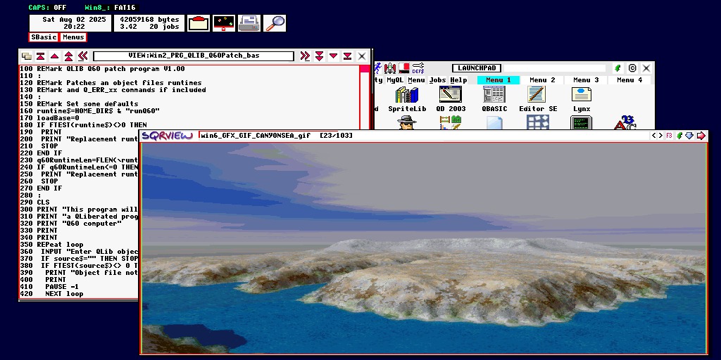

Q60Patch :
Qtrans_obj, SQRview102_obj and Launchpad_obj after patching and looking good. Early days.
Cheers

Artificer wrote: Sat Aug 02, 2025 8:52 pm Qtrans_obj, SQRview102_obj and Launchpad_obj after patching and looking good. Early days.
Nice! How do you take the highcolor screenshots on Q60 by the way?

Post by Artificer »
A screen scrape into a _pic file using a compiled SBASIC program on a hotkey and the _pic loaded into QTimage and exported as a .jpeg.
If you are asking about the canyonsea.gif, that comes from a rendering program - Vista pro that I ran on an Amiga 1200, a long time ago.
Thanks for asking.
Cheers
