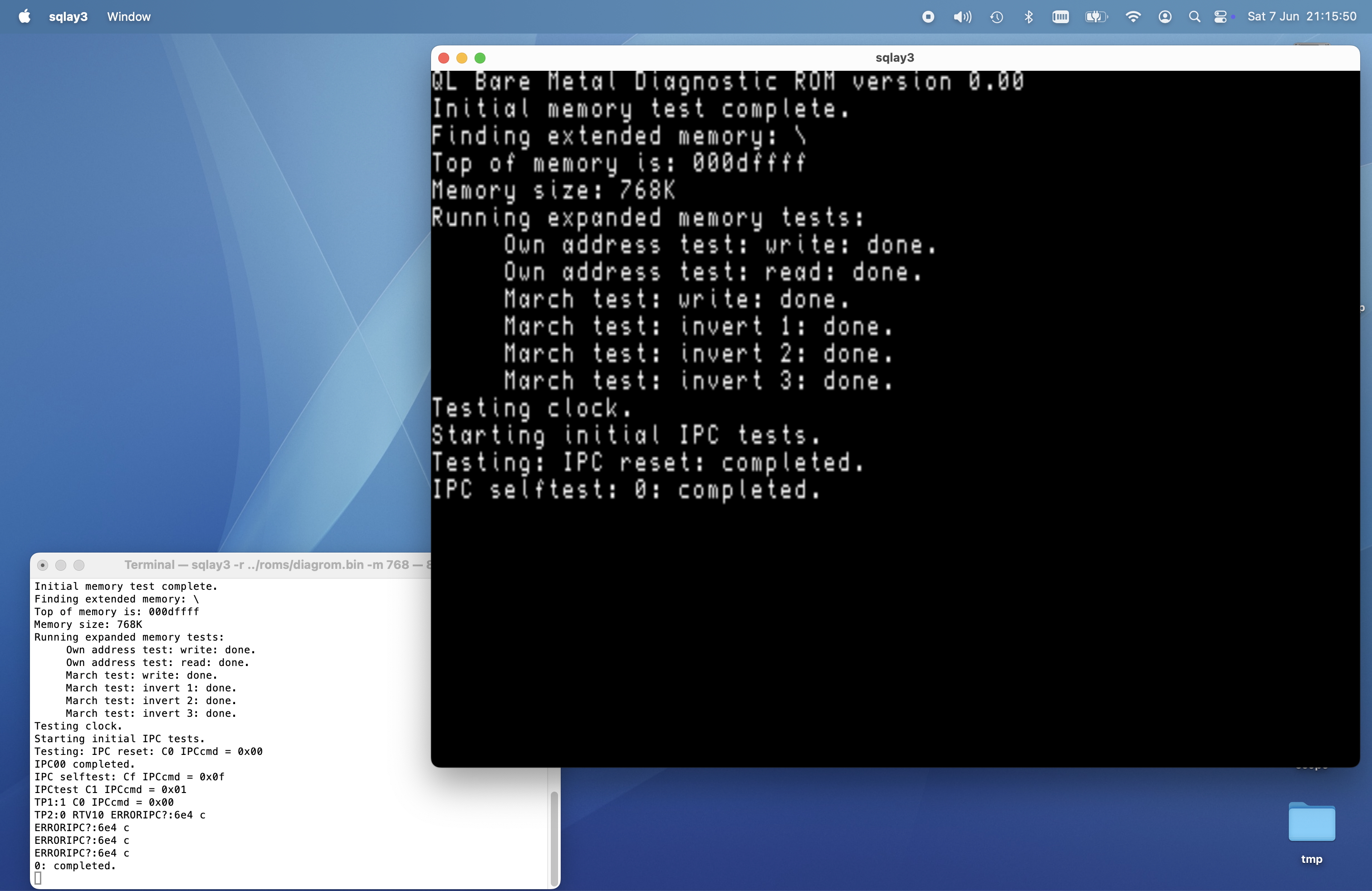

It may be useful now... at least to do memory testing as it now detects RAM expansions, sizes them and then runs an "own address" test and March test on it. Still not sure about the lower RAM RAM failure output as I'm going to have to revisit that.
P.S. This is how it looks currently. The "serial port" output is being sent to the terminal window I used to start the emulator (along with some IPC diag messages)

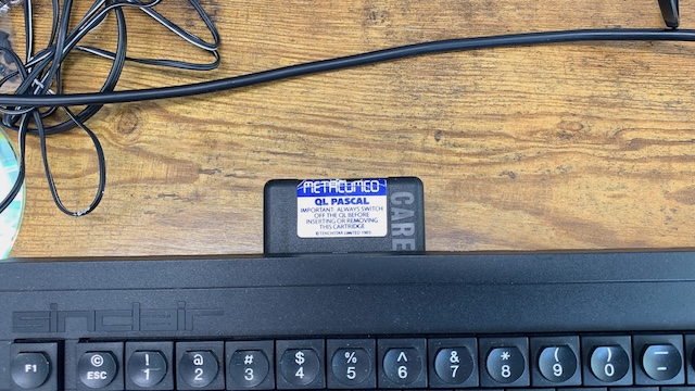

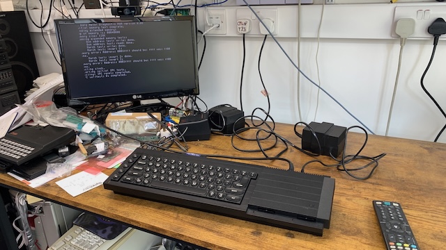

First test on real hardware... using the "let the Winbond W27C512 EEPROM overrule the system ROMs" trick.
Hack a ROM cartridge so that it passes all address lines through to the EEPROM and voila!
The masked ROMs must only pull down data lines but the Winbond EEPROM must actively drive them *HARD*.
Anyway, first test on a stock system shows that there's an issue with my expansion memory detection code due to sqlay3 looking like it has a bug where memory seems to be one byte too short.

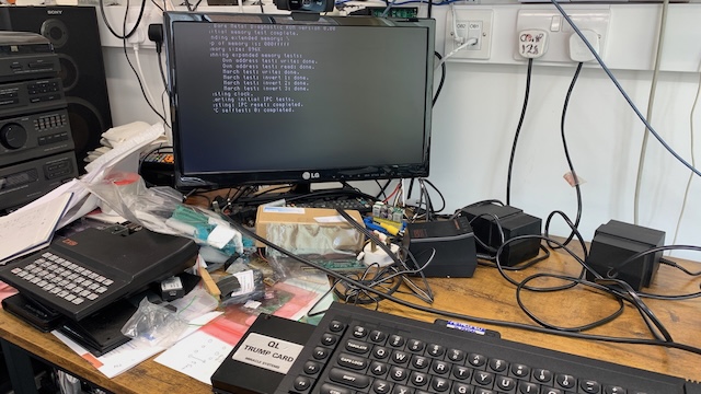

With the Trump Card installed I have to hit the reset button to get the machine to boot but then it works fine, and verifies that my Trump Card's memory is good.
So, overall a success. I can dig a serial cable out now and see if that works.

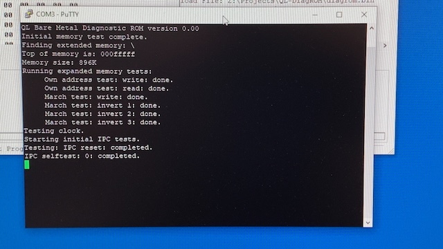

Serial port output now works.
A combination of my code having the incorrect sense when testing the transmit buffer full bit in the ZX8302 cstatus register and the ZX8302 documentation I have being wrong.
For the latter the document says that the baud rate bits are 000 for 75 baud going up to 111 for 19200 baud. In actual fact the bits are flipped. 4800 baud in the documentation is stated as '101' but that's actually 600 baud and it should be '010' instead.
All working now. I've swapped over to using ser2 as well as with the serial cables I have it was easier to verify the connection and, to be honest, it doesn't matter as long as it's documented.
