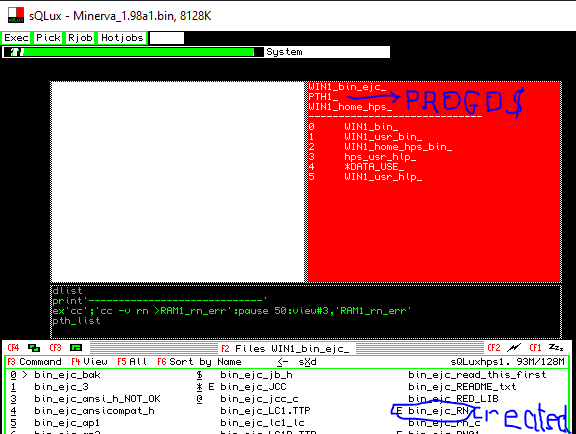

EJC (Erling Jacobsen C)
For those lucky user who have a copy of EJC:
The manual states that DATAD$ and PROGD$ must point (be) the directory of EJC.
At least with the PTH-Device from Phil Borman it is working if just DATAD$ is pointing to the EJC directory (where your C source must be present).
I will try to improve this (if I find time), so that DATAD$ may point to another directory than the EJC directory (the cc compiler driver is delivered in source code :-)).
p.s.: I have installed EJC in "WIN1_bin_ejc", i.e. the EJC executables (compiler phases and linker are even found, if the PTH1 only includes WIN1_bin and not WIN1_bin_ejc :-)
ql_freak
Posts: 609
Re: My "from PACKAGE import *" (Python) simulation project (reflection)
Post by ql_freak »
One problem exists: If there is an old version of the program (rn in my case), which appears in PTH1 before the ejc-directory (in my case e.g. WIN1_bin_), then you must enter the FQPN (fully qualified pathname), if you want to test your new compiled program, i.e.
ex'WIN1_bin_ejc_rn';'...' instead of ex'rn';'...'
