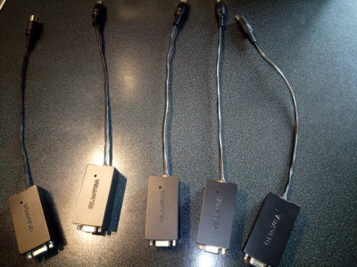

ql2vga ready to use UPDATE !! there is a new waiting list 7/2025 !! 4 units available !!

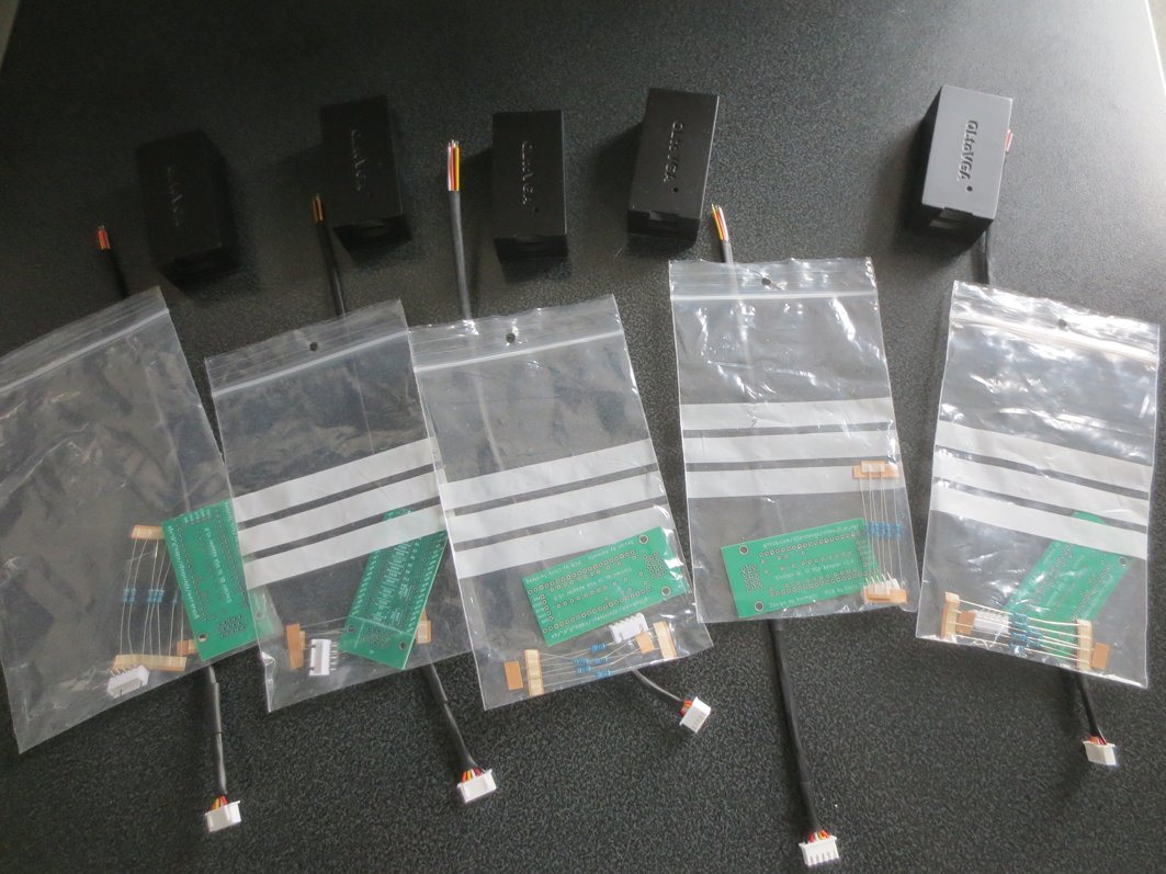

last batch ,
pcb ready for assembly ,
cases ready for assembled pcb's
now to wait for the components to arrive ...................

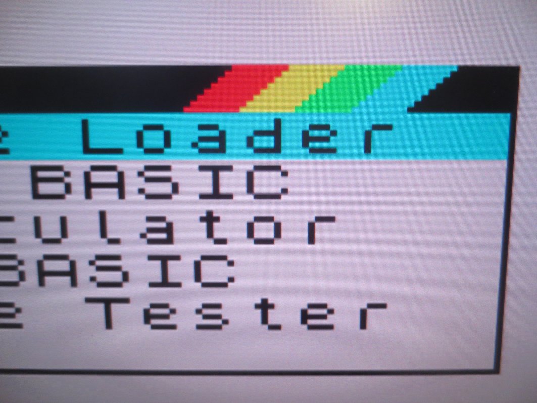

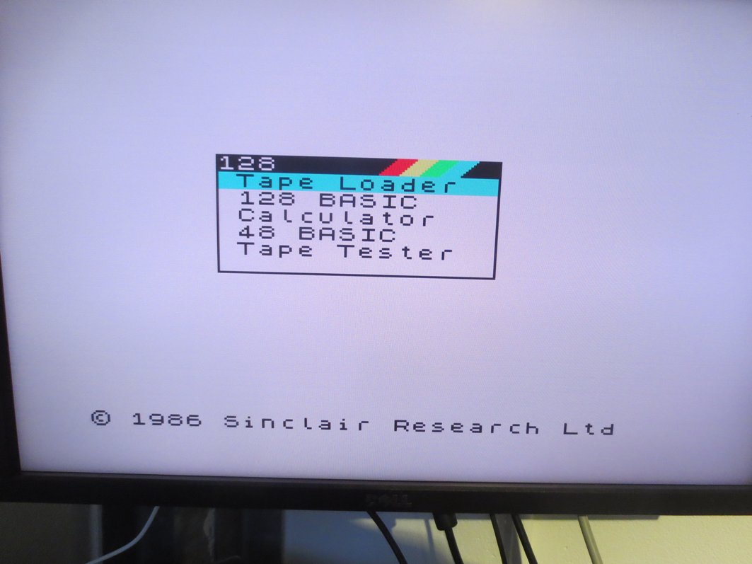

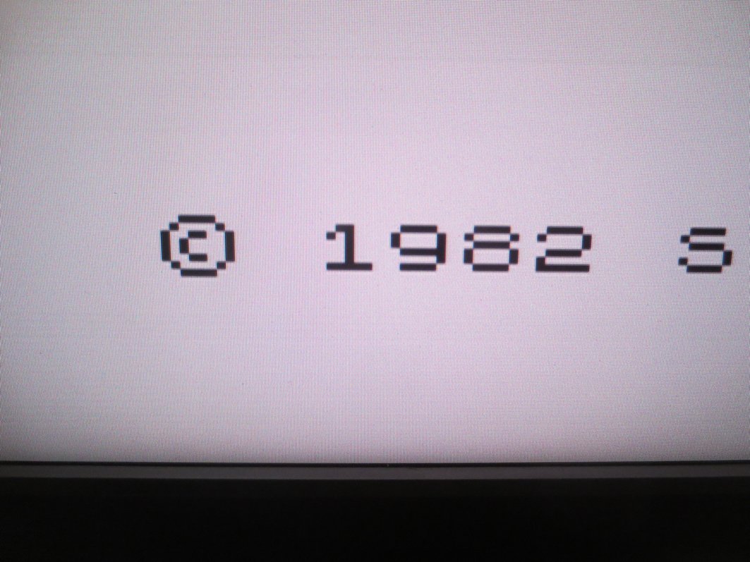

As many people asked me if this ql2vga would work with a spectrum 128 ,
Yes it does , but in terrible quality because of un-adapted timing .
here are some screen shots ;
As you can see , it is visible but not as crystal clear as when used with a ql .
Maybe the programmer of the firmware can adapt it for use with the 128 ........

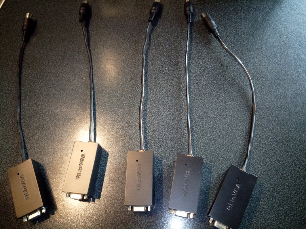

last batch finished !!
i will sent each of you a pm regarding the payments.

Those of us who already have it, can we update it somehow so that it can also be used on spectrum 128?techy wrote: Sat Dec 23, 2023 6:17 pm As many people asked me if this ql2vga would work with a spectrum 128 ,
Re: ql2vga ready to use UPDATE !!
As i am not the programmer of the firmware i can not change anything .
I know the amstrad version and the original sinclair version don't have the same video output , which then needs to be adapted separately.
if a new firmware will be available , i assume the best option is to get a second unit for the 128 .

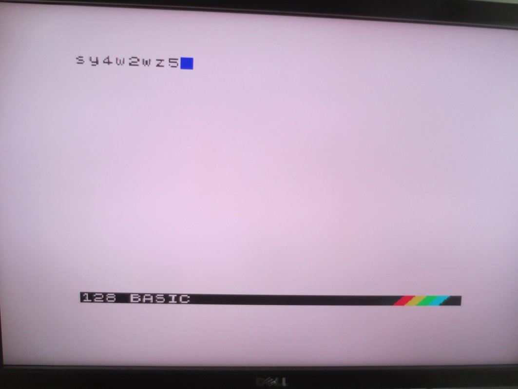

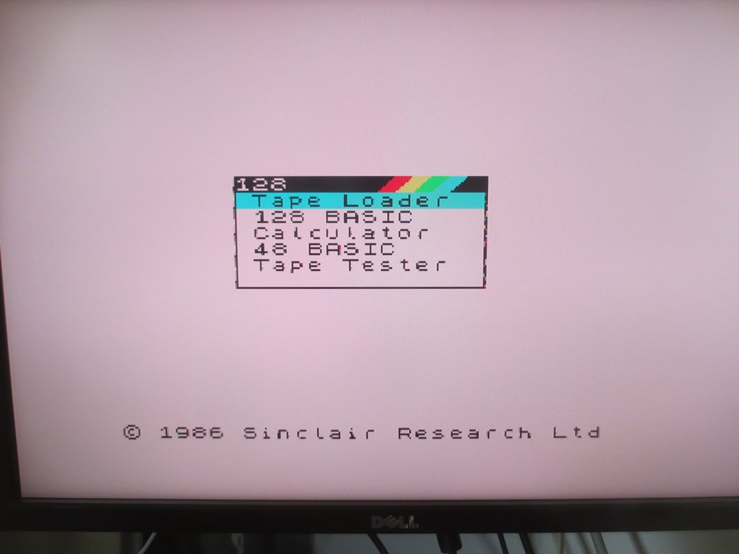

I got some info regarding the adaptation for a spectrum 128 .
Kindly shared by the designer holmatic .
The problem with the spectrum 128 and the newer amstrad versions , is the presence of an extra brightness signal ( only 3 level ) = only 2 level !! = .
This signal is not implemented in the ql2vga hardware .
The ql2vga software should be able to handle this as part of its design , a reprogramming is then needed .
But a three level hardware detection must be developed to get that signal .
So , not for now .
This is how a sinclair toastracks screen looks without the brightness implemented ( 640x480 only ). ;
So , not for now .
so ,
i can program a "ql2vga" with the 128 firmware ( 640x480 without brightness )
If anyone is interested please let me know .
