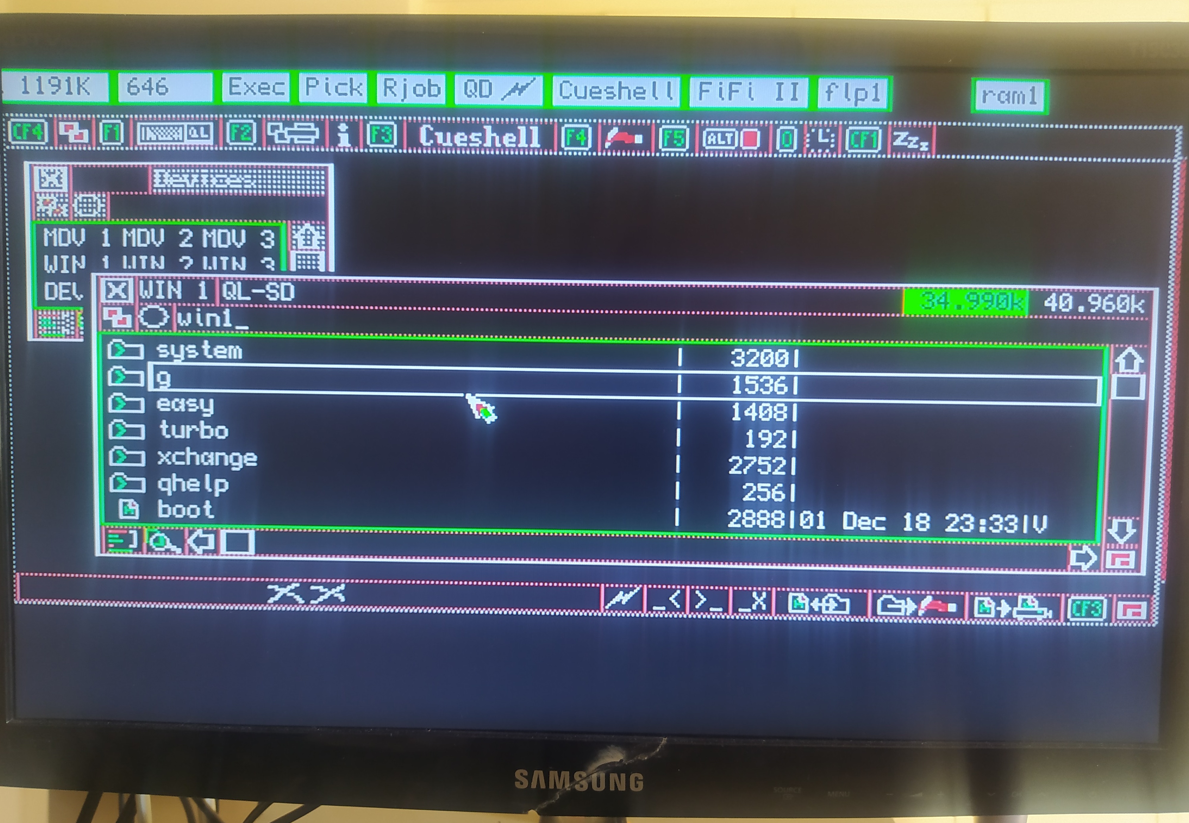

Although I have to de-solder, program and re-solder the flash chip every time since I damaged the jtag pins of the fpga I did some progress.
I used the following simple way to temporary change clock frequency of the zx8302 that seems to work:
for75<="00" when for75="1"&PCEN and rising_edge(CLKIN) else for75+1 when rising_edge(CLKIN);
CLKZX2<=for75(1);
a 30Mhz counter counts up to 3 or 4 depending on PCEN status and I use the high bit of the counter as a clock to zx8302.
This provides a 10 Mhz with 33.33% duty cycle or a 7.5Mhz with 50% duty cycle clock.
Serial mouse works
Maybe it's time for a sprites test-demo, I'm thinking of a simple game in C.
martyn_hill
Posts: 1131
Post by martyn_hill »
That's a very creative solution to the problem of maintaining 100% compatibility with the 8302, Leon!
lliont
Posts: 342
Location: Athens, Greece
Post by lliont »
So there are 2 ways to address the problem that both seem to work, either slow the cpu access or speed the ZX8302 clock when they communicate as long as the zx8302 can work at that frequency, for faster clocks as I intend to try with the mc68sec000 only the first method will do.
