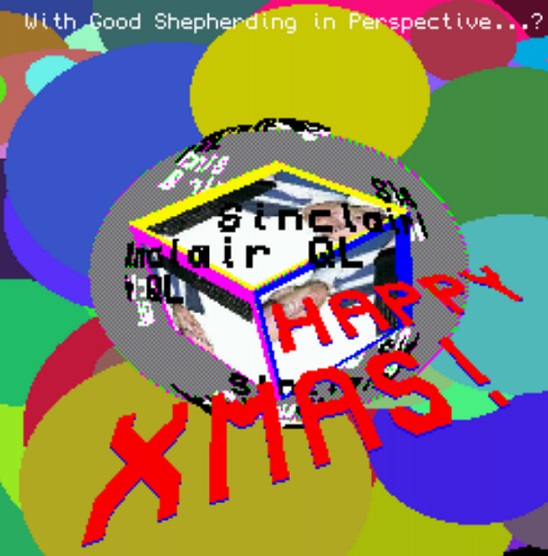

Hi Folks,
So here are seven perspective 3D programs, merged together. Just UNZIP, copy all files to dos5_ and RUN medley.Bas. (tested under QPC2).
1 RAI is an old program 'flying over our village', (calculates then replays).
2 GLOBE writes any text on a sphere. (change rows, columns or text as required).
3 INIT is called when RUN, and calls each program sequentially, with the 'trainer' at the end, (so you can see what the different variables do).
4 SLANT writes slanted text. (similar to giant cinema posters).
5 FLYIT flies a large QL along a travelling trajectory, (calculates, then replays).
6 TEXTTUMBLE rotates 'QL' around any axis.
7 DEMOS is the trainer. --HIT ESCape to quit, or in some programs, 'N'ext to move on. --
RUN calls INIT, other programs may be called by entering there names. ( GLOBE 0 or 1, SLANT angle).
The whoile lot is 83ko. But most programs have (almost) identical variables. If anyone wants more details, I will supply them;
In due course I will standarise all the common coding, but not until the new year.
Hope you find the question of perspective 3D interesting. I did 30 years ago, (but development was too slow on a QL at that time).
Steve.

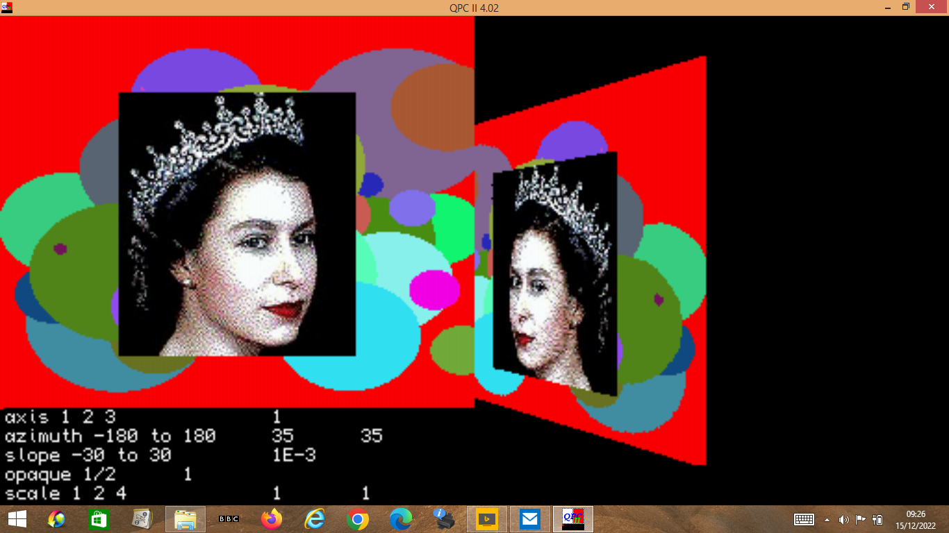

Hi again,
For those that downloaded the 3D program, here are some remarks about using the DEMOS trainer :
(default 1) OPAQUE ( 1 or 2) : 2 gives slight transparency
(default 1) SCALE (1 2 4) : 1 zooms nearest
(default 1) AXIS (1 2 3) : x y or z axis
(default -180) AZIMUTH : -180 is nearest position around orbit, +180 is farthest position around orbit.
(default 0) SLOPE : +30 looks downward, -30 looks upward to object. ( 0 defaults to 1E-3 to avoid division by zero !).
(default -90) SPIN : spins the 2D image before wrapping onto 3D plane...
IF you just get a flat horizontal line, hit 'N'ext and change the view variables, so as not to be side-on !
To modify any problem with your system's aspect ratio : Tweak the Viou routine : 3650 m=TAN(h)*-1 , to say m=TAN(h)*-.75 or similar.
Regards, Steve.
