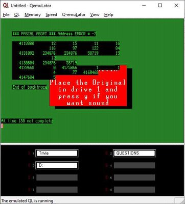

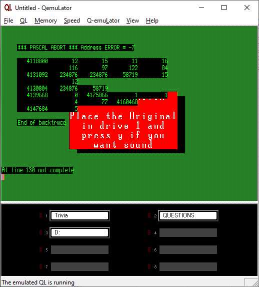

Ah, yes, that works. Well, for a few questions, then this happens at a random point (never the same place twice):
Oxford Triva error
Oxford Triva error
The executable stops and goes back to BASIC. The -7 error implies something was not found.
I think where I went wrong with the keys was that the cursor keys are so fast you don't actually see them go up and down - it seems to use the equivalent of KEYROW.
You certainly don't get much time to answer questions - barely enough to read them, not think a little about the answer to choose. But that's part of the game I guess.
That's odd then. You get the same error when there is no cart at all in mdv2.
I think I had them the right way round (with my brain anything is possible). Mind you, it wouldn't have started at all if I had the two MDVs the wrong way round. Was a bit weird since it happened after the start of the game. All I can think of was that something went wrong with MDV2 at some point.
