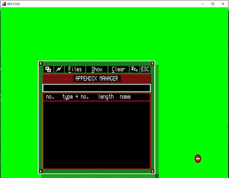

BSJR wrote:Interesting observation.
I had a quick look at the AppMan4 sources but so far cannot find anything that would cause this.
As v4 was adapted to High Colours and Resolutions it was probably not fully tested at the standard QL size.
Can you show me a screenshot of your mode 4 AppMan?
I will have a further look at the way the screen is checked in AppMan.
BSJR
The default configuration for APPMAN is to use system palette 4. In mode 4 this is not a happy choice, as black ink on black paper is rather hard to read :D :D
I have to thank Markus for telling me that I can use menuconfig on Appman to change to palette 0

BSJR wrote:
Andrew wrote:LATER EDIT:
I found out what the problem is: APPMAN will run in high color mode only if resolution is at least 640x480!
But it would not run in 512x256 High colour mode!
All other Easyptr programs work in 512x256, in all colour modes.
As I only use a BBQL, my QPC is also set to run in 512x256, hence the issue
The default height of the HC menu version is 294 pixels while the QL version has 168 pixels. I guess that's the reason.
