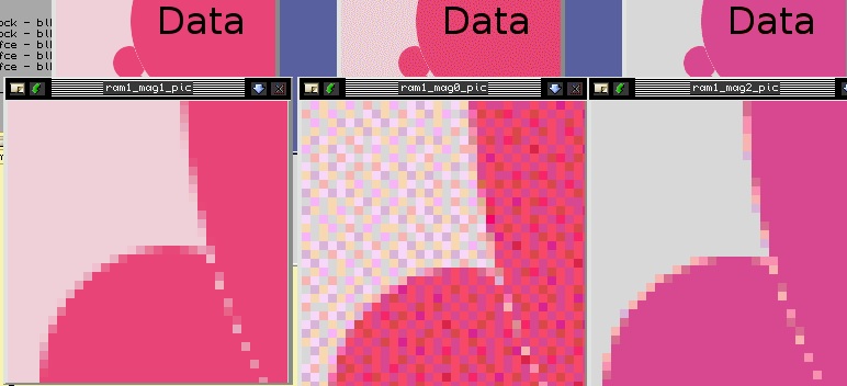

Dec wrote:<>
I have updated my tool, now it supports Mode 16. Could you test it? Tool does NOT add extra bytes in PIC file, so let me know if it can cause a problem.
So, I did a quick test of a single PNG image, just to get the gist of DaDither.
You appear to have got the GD2 mode 16 PIC header right :)
The composite image below shows three of my results, with a small piece of the
converted image above, and a tiny peice of that again magnified below each
image.
From left to right:
1. PNG converted to PIC with PHGTK. This looks pretty much like the original, as
viewed on the PC side.
2. PNG converted with DaDither, using the Floy-Steinberg setting
3. As above using the <none> setting.
All the other filters produced a slightly different, but similar, "speckled"
appearance as the middle item.
Dec

pjw wrote:You appear to have got the GD2 mode 16 PIC header right
So real machine/emulator can load PIC files as expected without any problem? And what about files created in 32/33 modes?
