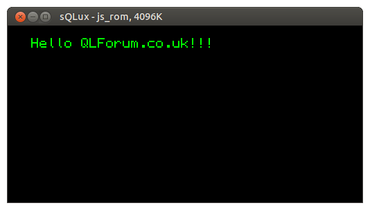

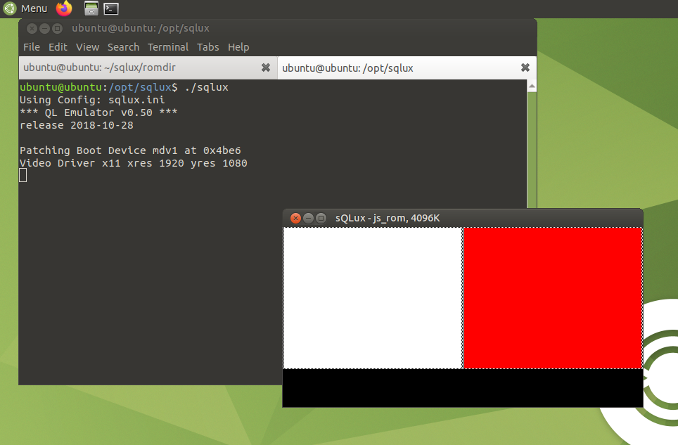

Sparrowhawk wrote:Success! :)
I have a few more questions if you do not mind XorA:
1. How d I set the display to be 2x default (is that possible?)
2. Is there a way to swap mdv images while the emulator is running?
3. Just checking I have the latest version, as the runtime output says the version is 2018? I downloaded the source code from github - I assume latest is there?
Thanks again,
JY
1. At the moment the window is dynamically resized I took out the zoom option as it was interfering with hidpi displays.
2. No
3. Yes, I’ll update that when I actually have it release ready.
