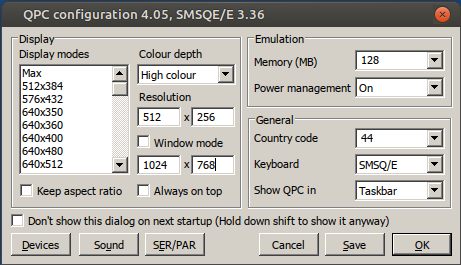

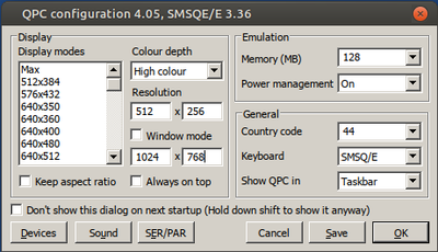

The QPC2 startup screen is able to be configured as Marcel stated, here is a QPC2 startup screen that is configured as a QL 512x256 screen, which is expanded to 1024x768
QPC2 QL Mode Setup
QPC2 QL Mode Setup
Selecting the Window Mode disable full screen mode.
The use of SMSQ/E is much better than JS, which is full of bugs and can not multitask basic.
