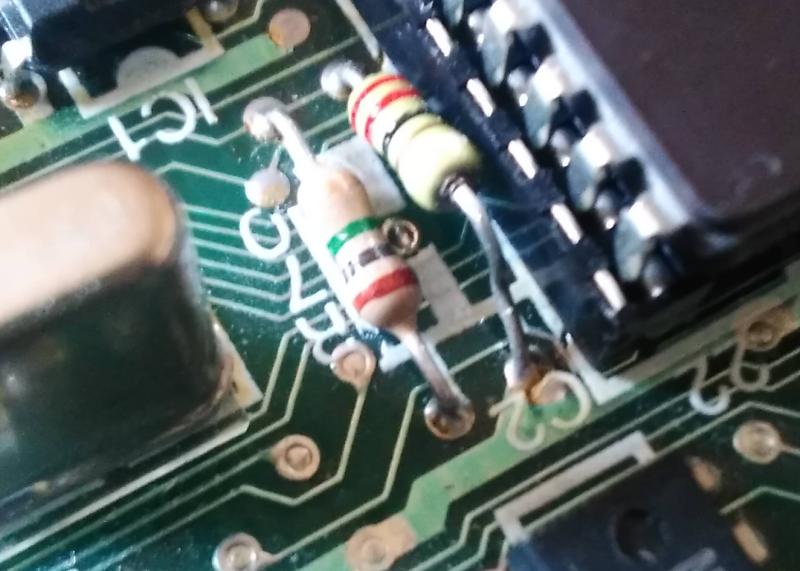

Looking around the clock circuit of the 8301 the picture shows the capacitor is not ideally placed and the joint has a lot of flux I think giving the brown colour. The clock signal is very sensitive compared to others I have been involved with so I put the capacitor in its correct position flat on the board improving the joint at the same time. It didn't make the QL work but things appeared to have changed again. The CAS1L signal is now working where it seemed to be stuck high before. The scope measures 15 MHz now and there are a lot more colours in the screen like darker blues and more vivid red. Don't ask me what is going on I am just reporting what I see but it seems incredible the QL ever worked. :?

Do all capacitors on your board look like a resistor?
Edit: OK, seems to be the norm with Issue <6 boards.

mk79 wrote:Do all capacitors on your board look like a resistor?
I see you answered this yourself. :lol: I don't remember seeing capacitors with resistor type markings that are very confusing they are normally like the yellow ones between the RAM chips.

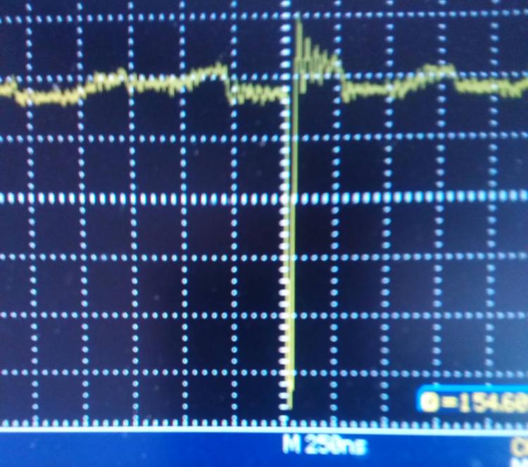

I didn't look at the power rail at different particular points but I did look to see if was there. :lol: It was glitchy and you could see small square waves on the rail but it was all less than 250mV so nowhere near the logic levels. I will have a look on the chips like you suggest. What about the slow edges on my HAL chip that look like capacitor charge up curves rather than square waves as if they are heavily loaded or is that normal?

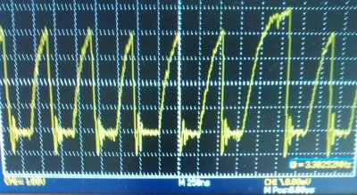

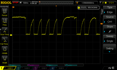

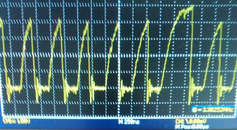

Done more poking around with the scope and the power rails on all the RAM chips are probably the best bit of the whole box. The HAL chip is the thing that does bother me but it might be perfectly normal I don't know. The pictures show pins 15 & 19 the OE and DTACK signals respectively. I would say both signals are not what I call good but maybe they are acceptable on the vintage QL and normal. The 25nS is the rest state of a regular pulse that becomes 250 nS for an active signal like the Minerva memory changing on the screen. As for the DTACK I am assuming the shorter pulses are the inactive state and the longer one is active. Could someone enlighten me if they are good enough or not?

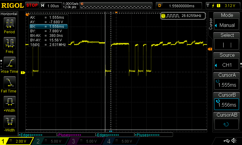

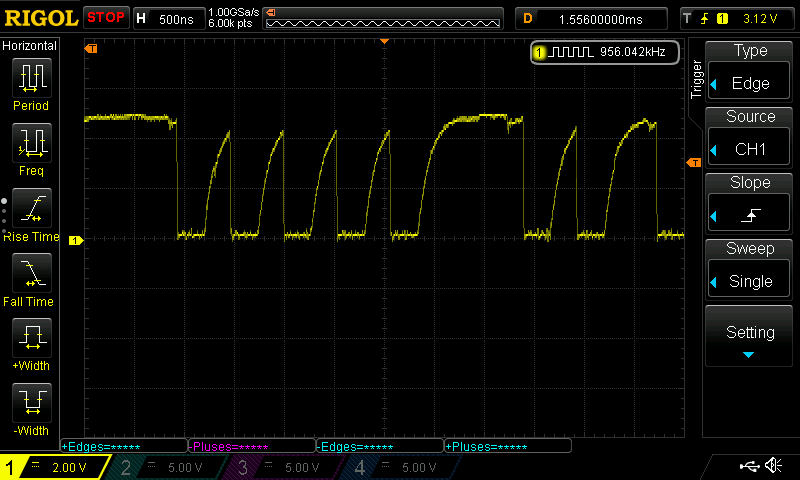

DTACKL looks normal. Not sure about OE. I've measured these on my QL for reference, you have much more ground noise, but could be that the Samsung QLs were better in this respect.
DTACKL:
OEL:
