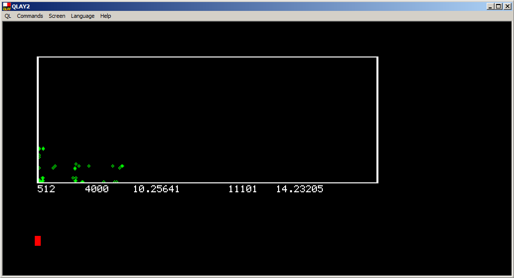

Note that randomizing the seed is not something you want to do when encrypting since the seed is the key and you must know exactly what it is so you can decrypt (since you want to recreate the sequence in exactly the same way). With a good 16 bit random number generator, you can choose any of the 65,536 values and they will be equally fine. One usually uses a hash function to convert a string of characters, symbols, and numbers (i.e. what we call passwords) into a numeric value.
With regard to the code you showed:
The call to QLrand is independent of x and y so it can be more clearly written like this:
So when n is 2 then you run x 65536 times but call QLrand twice and so you will repeat the cycle the second go around. That is the limit of the 16 bit sequence and the best you can hope for with using it for encryption.
If you want a truly random sequence with no upper limit for the cycle, then you might as well get rid of QLrand and just use get_seed and call it since it is using the beep command and (I assume) gets some truly random set of numbers. Though useless in cryptography, it might be neat for games and such.
I did try the code below but "t" seems to never get bigger than 5 since it is local to trueRand. This caused the function r$ to only return 0 since beep ended on the first go of the for loop.
When I moved "t" out of trueRand (removit it from lines 105 and 110) and made it global (added this: 5 MODE 4: t=1) so it would cycle through all 24 values, it started giving me non-zero strings but mostly they were numbers like 100100 or 101011. So it seems to end the "loop" always pretty early and thus not give very random values.
So then I changed the formula for beep to BEEP 2^t, 2^t going up in powers of 2 (and then I had to cap t at 12). So these changes to the code above:
This mostly gave me numbers with 0, 1, 2, 3, and 4 in them which is not very random (i.e. 20134). It sometime throws a 5 or 6 or 7 in there but mostly they are small numbers. So it sounds like a great idea but I just don't think it can be pulled off if you can't get through the repeat loop and randomly have j give you higher values for 5, 6, 7, 8, and 9 so you can construct truly a full set of random 5 digits numbers between 00000 and 99999. Now I ran this on QLAY2 (so no sound chip and much faster) so perhaps on a real QL it works better but that doesn't make it very portable.
Below is the plot I got using the powers of 2 which was the best I could get but it really doesn't distribute well. The reason your scatter plots look great is because you are using that nice 16 bit random number generator that we already tested is good. You just reseed it with these bland numbers that aren't all that random but as long as they are off by a digit the 16 bit random number generator will be fine and not repeat the sequence.
Still, a pretty cool idea and I liked it...why I spend some time digging into it
5 MODE 4
10 WINDOW #1, 344, 128, 35, 35: SCALE #1, 128, 0, 0: BORDER #1, 1, 7: PAPER #1, 0: INK #1, 7
15 WINDOW #2, 344, 10, 35, 164: PAPER #2, 0: INK #2, 7
20 FOR i = 1 TO 512
25 x = trueRand: y = trueRand
30 INK #1, 4: CIRCLE #1, x/390, y/780, 1
35 PRINT #2, i, x, x/390, y, y/780
5 MODE 4: t=1
105 LOCal i, qs, q$
110 q$='0'
160 BEEP 2^t, 2^t
165 t=t+1: IF t>12: t=1

Here are two improvements to the mar 08 - 9.39am program :
Line 357 the exact number is the string literal '1.52584860' .... in place of 1.5E8 .... to cater for the full 65537 range.
Line 370 return qs -1 .... to allow a return of '0' .... which the line 157 INT( ) statement made impossible.
These seeded scatter plots now seem to be absolutely correct. So that would appear to verify the proof of concept.
The routines now need tailoring for ordinary (non-demo) use by anyone in their programs, ( I will report back ... )
Steve.

You have a slight bug, fix the line below accordingly to get a fair distribution.
Change from:
To:
In other words, you always need to normalize, not only when it is above 65537 to get the accurate distribution otherwise you are skewing the scatter plot. Or get rid of the divisor on qs and just plot your x and y using 390 as your divisor not 256 (in other words, let it range form 0 to 99999 and normalize while plotting, or you can change the scale on your plot to 100 an normalize by dividing by 1000). Six of one, half-dozen of the other, so to speak :-/
Note again though, something similar did not work well on QLAY2 so it might only work on QPC. Plus, it also is a bit slower than your random number generator based on the 8421 number (which we did determine is also sufficiently random and pretty good). I wouldn't worry about the cycle being only 16 bits since you can really only work with 16 bit numbers accurately on the QL. Also, the 99999 range is not even 17 bits so you don't really gain anything with regard to precision on the QPC.
That being said, it is a cool implementation adding some physics and electrons into the equation to get a pure random behavior so I like it for that reason. Just may not be practical for application. Certainly cannot be used for encryption or decryption since you need to make the sequence repeatable but for games and the like just to have the cool factor and saying "true random based on physic" might be fun. Maybe if we can prove that it is uniform on QPC, Q40, Q60, all the emulators, and the BBQL, I might just stick it into my ZX81 Simulator once I get that done at the end of summer since ZX81 BASIC does support RND.
Change from:
357 IF qs>65537: qs=INT(qs/1.52584860)
To:
357 qs=INT(qs/1.52584860)

I wrote the program above with QPC2, which produced correct random scatter plots.
But on my QL, under QDOS or SMSQ, the scatter plots were not correct.
This is due to different 'BEEPING' polll return speeds, so there can be no universal program for all platforms...... Sorry !
After much experimentation, I cannot find any simple workarounds, so I shall have to throw in the towel.
Steve.
