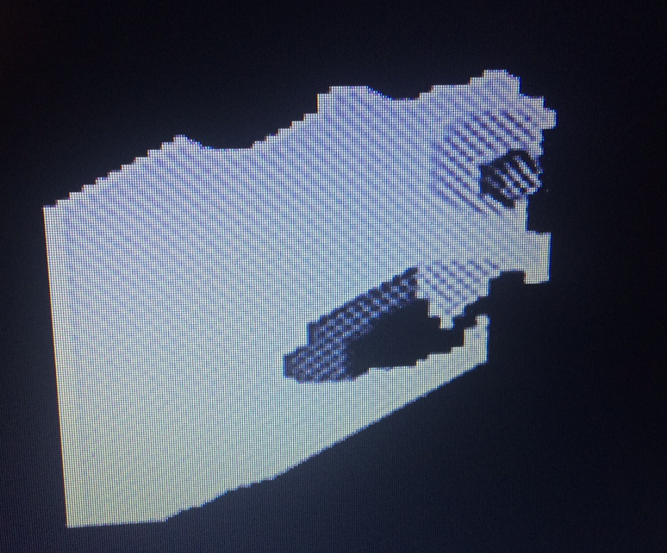

F1 color-composite picture where monitor fails and shows black&white and claims PAL. You can see the grid pattern and those slowly are in motion:

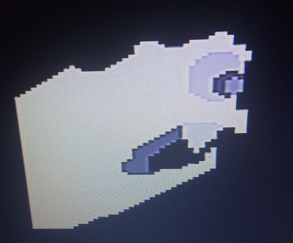

F1 monochrome-composite and the picture is smooth. The circular artifacts on the white part are from the iPhone camera and don't appear on the screen.
Also note that when you view image in full size that both pictures are about twice the size of what the monitor shows.
Interesting also is the edges of the picture where the monochrome-composite shows the block outline of the ghost clearly whereas in the color-composite some of that disappears. Looking specifically at the lower lip area really demonstrates this.

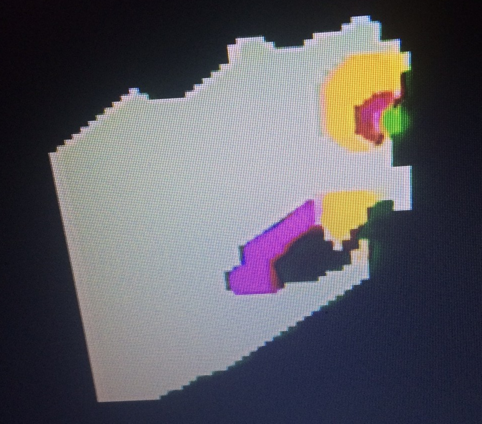

F2 color-composite picture added just so you can see how my monitor shows color when in TV mode. Note that the picture is a little wider since TV mode stretches the image but also removes the bottom portion (i.e. the stuff after the 8 high scores in Spook -- though here you are only seeing the ghost from top of picture).

In the first picture. Does the monitor/TV have a 'colour' control to turn the intensity of the colours up and down. If so does the patterning disappear or vary? This would indicate that the patterning is caused by the TV trying to 'decode' the colour signal, but having problems, and producing the patterns instead. Which would not be surprising if the TV is trying to decode a NTSC signal as a PAL signal.
If I have read what you say correctly, comparing RF and colour composite outputs in the F1 screen mode. The RF one switches the TV into PAL mode, where the colour composite one does not. If your TV, when it switches into PAL mode. Also switches into the UK mode of 625 lines (where the US mode is 525 lines). I would expect this to alter the size/position of the displayed picture. https://www.movavi.com/learning-portal/ ... etter.html this talks about the differences between the two systems.
When Sinclair designed the QL display circuitry, They bent the specifications of the TV signal a bit. Making the 'visible' part of the picture between the synchronising pulses, a bit wider than standard. That's why you can loose a character or two at the sides. Hence the F1/F2 Monitor and TV modes. Now I'm not too sure about NTSC, but in PAL there is a special signal between the end of the synchronising pulse and the start of the displayed picture called the 'burst'. It's used to synchronise an oscillator in the colour decoder. Which if not correctly synchronised will give you all sorts of colour problems (This is 4.4433MHz in PAL, 3.58MHz in NTSC, and I think there may be a 4.43MHz NTSC as well).
This may be where your monitor/TV is getting confused, If the burst signal and the start of the picture are a bit too close for the monitor to handle reliably, it may be misinterpreting the the signal, and choosing the wrong standard.
Here http://www.sinclairql.net/srv/QLSchematicIssue5.gif is a circuit of the QL, look in the top right hand corner for the video circuit. TR9 takes the RGB and sync signals, joins then together, and send them out of the mono composite pin of the video socket.
The RGB and the sync signal are also supplied to the MC1377, on pins 1,3,4,and 5. The colour composite signal comes out of pin9, and is fed to the modulator and pin 3 of the video socket (in a UK QL). I don't know about a US QL.
So the mono and colour composite signals are completely separate.
