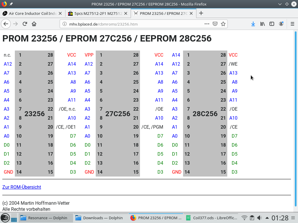

The flash tick box is on the read page and I tried both settings but no difference. According to the pinouts here
http://mhv.bplaced.de/cbmroms/23256.htm
the 23 is the same as the 27 for reading since the 23 has unconnected pins on some not different ones but I don't know about pin readings the programmer would be expecting.
The fact that one consistently gives five data lines as pin errors implies it might be damaged.
