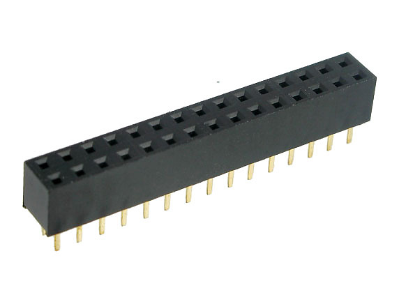

Re: Announcing availability of a QLNET driver for the Q68 (ND-Q68)
That is the exact header I have. Some have the index key, some do not.
I decided to put the index key facing right, if present, because the other way it just touches the pins of the ethernet controller.

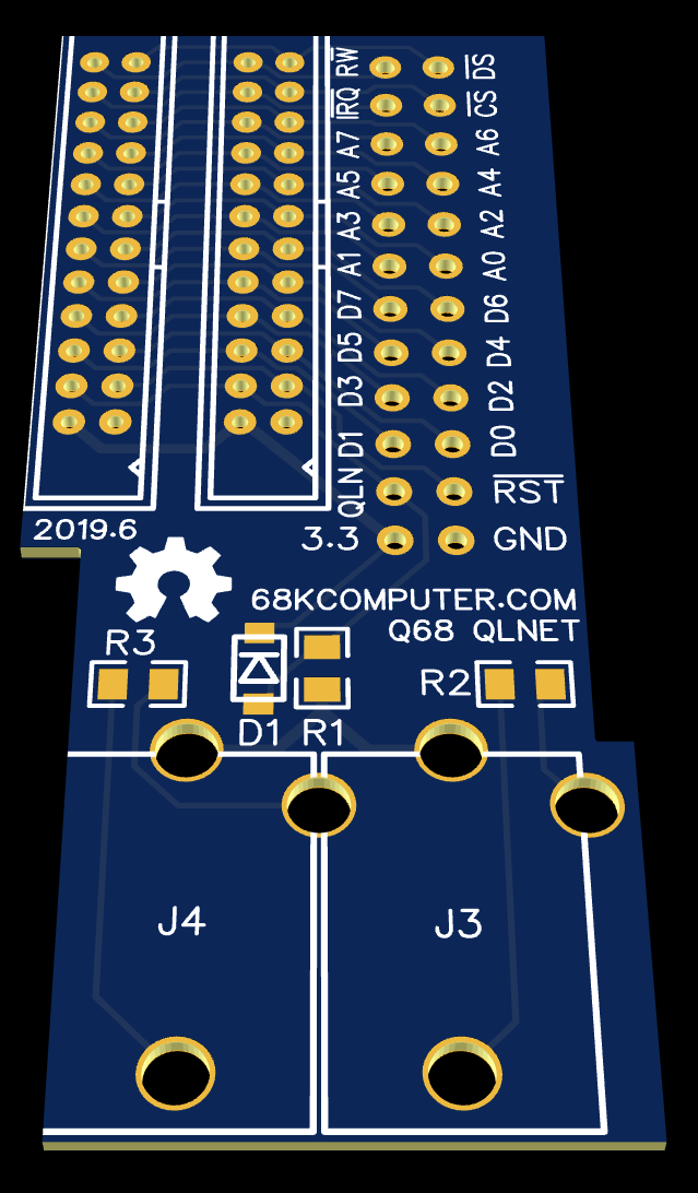

I did some clean-up on it, and added some labels. I did a test fit and massaged the shape a little to stay clear of the power connector and supercap.
Hi Dave,Dave wrote:I did some clean-up on it, and added some labels. I did a test fit and massaged the shape a little to stay clear of the power connector and supercap.
It is pity you never listed proposals before performing all the work on the PCB design.
It looks to me after an examination of the Q68 PCB, the logical way would be to orientate the expansion board perpendicular to the front panel or in line witht he expansion connector, only 2 holes would be required in the side of the case wall. The Network Sockets could be connected to the Expansion PCB by a wire link to the PCB. This would allow assembly of the Q68 to remain the same.
The JTAG programming Pin Header could replaced by a 90 Degree Pin Header, But looking at the dimensions of the expansion board, there is enough space to for all the expansion facilities.
The advantage of this solution, is that the front of the Q68 stays the same, there is still use of the power button rather having it at the side.
But I am sure you will come up with all sorts of reasons why this should be done but I am reluctant to have the power switch at the side or an inline power switch on the power cable.
This is introducing non standard approach to the Q68 design.
Clearly a new case is required, I will start a new thread concerning a new case design.
