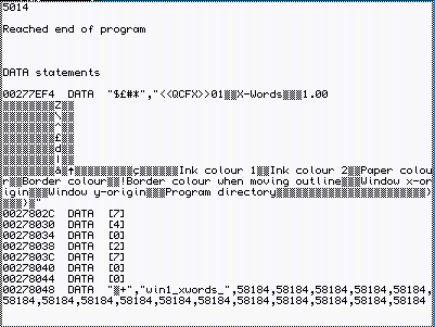

Martin_Head
Posts: 1002
Re: SuperCharge Decompiler
Post by Martin_Head »
I think I've got a bit of a handle on this now.
First problem was that the decompiler was not finding the true start of the DATA area because there is no specific RESTORE (without a line number) in the program.
After studying the code that reads the DATA, there is a special case of an integer that starts $7FFF
The decompiler now produces this -
as the output for the DATA statements in the xwords program.
The first DATA line looks corrupted, but it's non printable characters in a string.
I have put the special case integers in square brackets to distinguish them from normal numbers.
All the 58184's are zero padding, I expect to let the "win1_xword_" expand.
And here's the decompiled part of the code for reading it
170 IF COMPILED THEN
180
190  RESTORE ** Line number to be determined ** data0027802C : READ var94E2%
200  RESTORE ** Line number to be determined ** data00278030 : READ var94E6%
210  RESTORE ** Line number to be determined ** data00278034 : READ var94EA%
220  RESTORE ** Line number to be determined ** data00278038 : READ var94EE%
230  RESTORE ** Line number to be determined ** data0027803C : READ var95C6%
240  RESTORE ** Line number to be determined ** data00278040 : READ var95B6%
250  RESTORE ** Line number to be determined ** data00278044 : READ var95BA%
260  RESTORE ** Line number to be determined ** data00278048 : READ var94F2$ : READ var94F2$
270  ELSE
280
290  var94E2% = 7
300  var94E6% = 4
310  var94EA% = 0
320  var94EE% = 2
330  var95B6% = 0
340  var95BA% = 0
350  var94F2$ = "win1_xwords_"
360   : END IF
