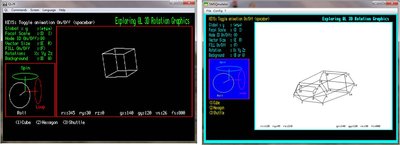

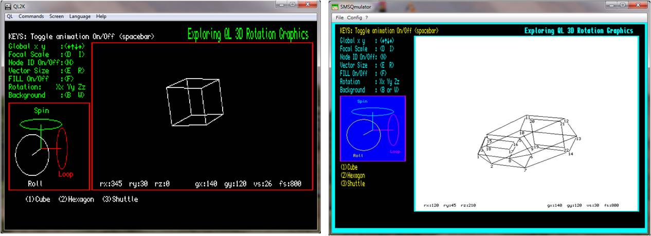

QBITS Exploring QL 3D Rotation Graphic
I guess as many others were, I was intrigued by the lure of 3D Graphics. I dabbled a bit, but to get any reasonable performance required direct machine calls and the like, a bit out of my league and understanding.
Anyway it seems another of my doodles is ready for judgment. This code has been developed using QL2K and SMSQ emulators running under Windows 7. There are four programs, the first is the initial trial of xyz rotation code. The second and third are the Wireframe programs with commands that allow manipulation of parameters controlling various aspects of movement, size and perspective. The fourth provides Node and Frame Data to configure three Objects, a Cube, a Hexagon shape and my attempt at a Space a Shuttle.
QB3D_Cube Basic code to rotate a Cube.
QB3D_Wire512 Program for standard QL 512x256 screens.
QB3D_Wire768 for the SMSQ 768x512 screen and 16 bit colour.
QB3D_Data1 Data coding for Cube, Hexagon, Shuttle
