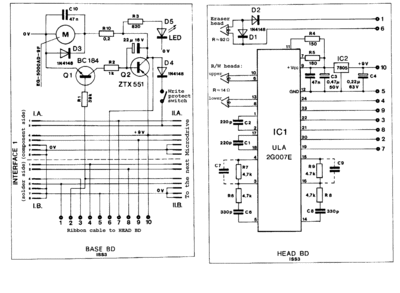

I found this chart for ZX MD base and head board, unlike QL, there are two PCBs, as they are detached. There is 92R stated for Erase head here.
Could it be, unless I made a bad measurement, that Sinclair at one stage fitted ZX R/W specific heads in QL for some reason?
With a smaller resistance, could this mean a higher erase current?
Also ULA of Unit 4 appears visually different so perhaps, erase current is compensated here somehow with different resistors used?

Hi Tomas,
Further to the erase head resistance: All 8 that I've measured here have a resistance of around 95-100 ohms (including one that had been removed from the head board). Measuring some ZX microdrives also gives the same value. None that I've found measure as high as the 750 ohms. The erase circuit comprises a switched 9V supply (write protect) with a series diode and series resistor (either 180 or 470 ohms dependent on the board revision). This gives a current of around 30mA or 15mA for the 100 ohm erase head and 9mA or 7mA for the 750 ohm erase head (for comparison, the ZX sevice manual gives the ZX erase current as 25mA - calculation gives a figure closer to 23mA). Would seem odd that all these values would give adequate erase performance but maybe I'm missing something?

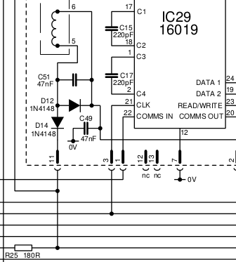

Now I see the reason why MD units#1-3 do not format. The resistance I measure is between points 5,6 of the coil. See picture.
The readings of 760R I got on 5,6 are in one direction/polarity only, and is that on the the diode D12, which is in parallel to the coil. It is hard to admit but erase coils in MD#1-3 are most likely dead
Unit#4 gives reading 96R in one and roughly 100R in the other polarity on the diode D12 - so is GOOD and can format tape which it does happily.
