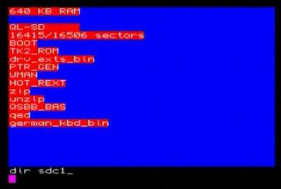

MIST wrote:New video:
https://www.youtube.com/watch?v=kVKXTzqTFFU
QL on MIST FPGA. Using 640k RAM and running Minerva + Toolkit 2 from ROM. Loading Pointer Environment and Crazy Cards from Microdrive-Image. The QIMI mouse imlementation uses the USB touchpad of the K400 keyboard connected wireless to the MIST.
And last but not least this happens on a regular TV using the SCART input as the scandoubler required for VGA can be disabled for use with TV sets.
Next i'll take a look at the QL-SD. I find the source code of the ROM image. But i don't see the compiled ROM. Does one of you have the QL-SD ROM? Either with prepended OS ROM or without ...

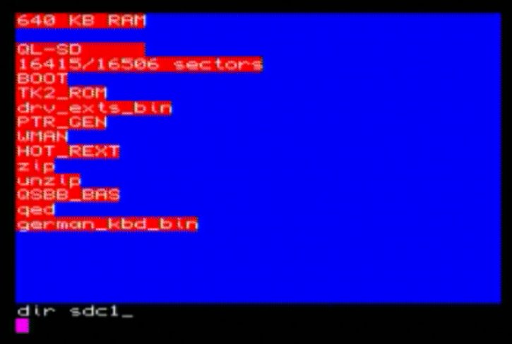

QL-SD turned out to be trivial. I actually only had to do some minor changes to the original Verilog code that was used to program the QL-SD's CPLD. Funny ... this is the first time i am actually using hardware code from a real device when rebuilding it in the FPGA.
So my setup now has 640k ram, qimi and ql-sd support.

Just found the benchmark on the QL-SD. Results:
Printing 1780
Functions 1900
Strings 2460
So pretty exactly twice the speed of the real thing. And that's with a CPU core running at 1.31 MHz. Yes, that's the clock the tg68 currently runs at. It's pretty efficient. In the Atari and Amiga we run it at up to 32 MHz ...
