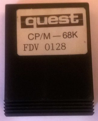

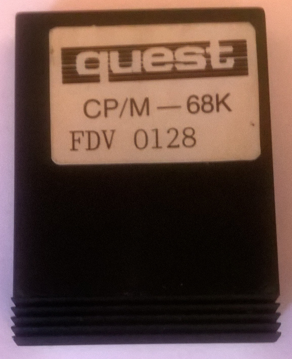

Quest CP/M 68K Boot MDV Cartridge
I have found the Quest CP/M 68K boot micrdrive, it was very cleverly hidden in a case with other microdrives?
See attached photograph
I will make a copy of the microdrive, but the CP/M 68K boot loader needs the OS Module Card in the expansion slot.
The problem now is that the OS Module is dead ended and the disk interfaces I have are also dead ended with no through port expansion. Which is the main reason for not having a working system.
