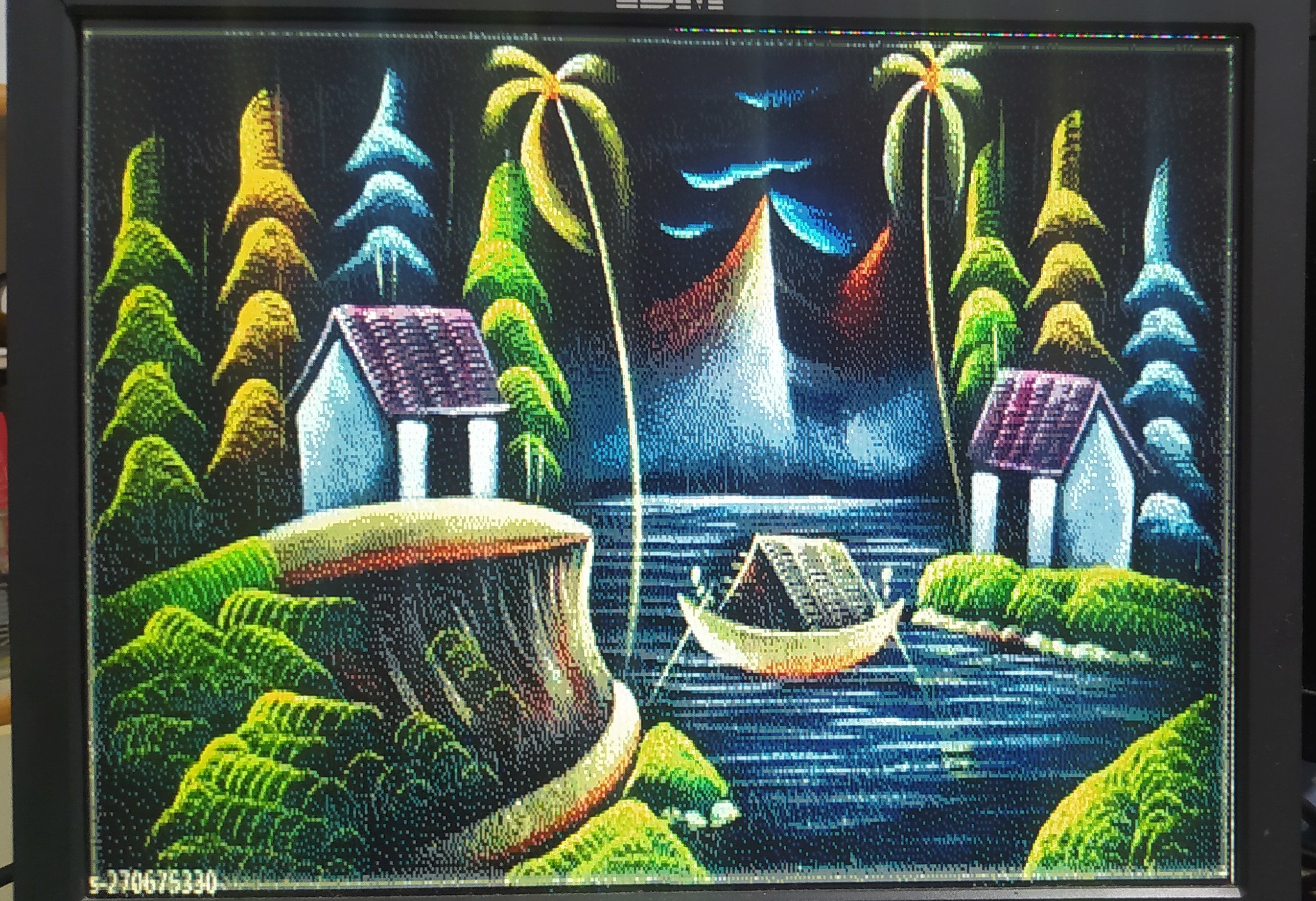

I added a "256^3" graphics only mode, 256x256 pixels with 256 colors.
Because there was not enough bram I had to use normal ram and steel cpu cycles to draw the screen so in this mode the speed is lower but now with 90 sprites, 256 colors and AY/YM compatible sound some good games could be written using this card.

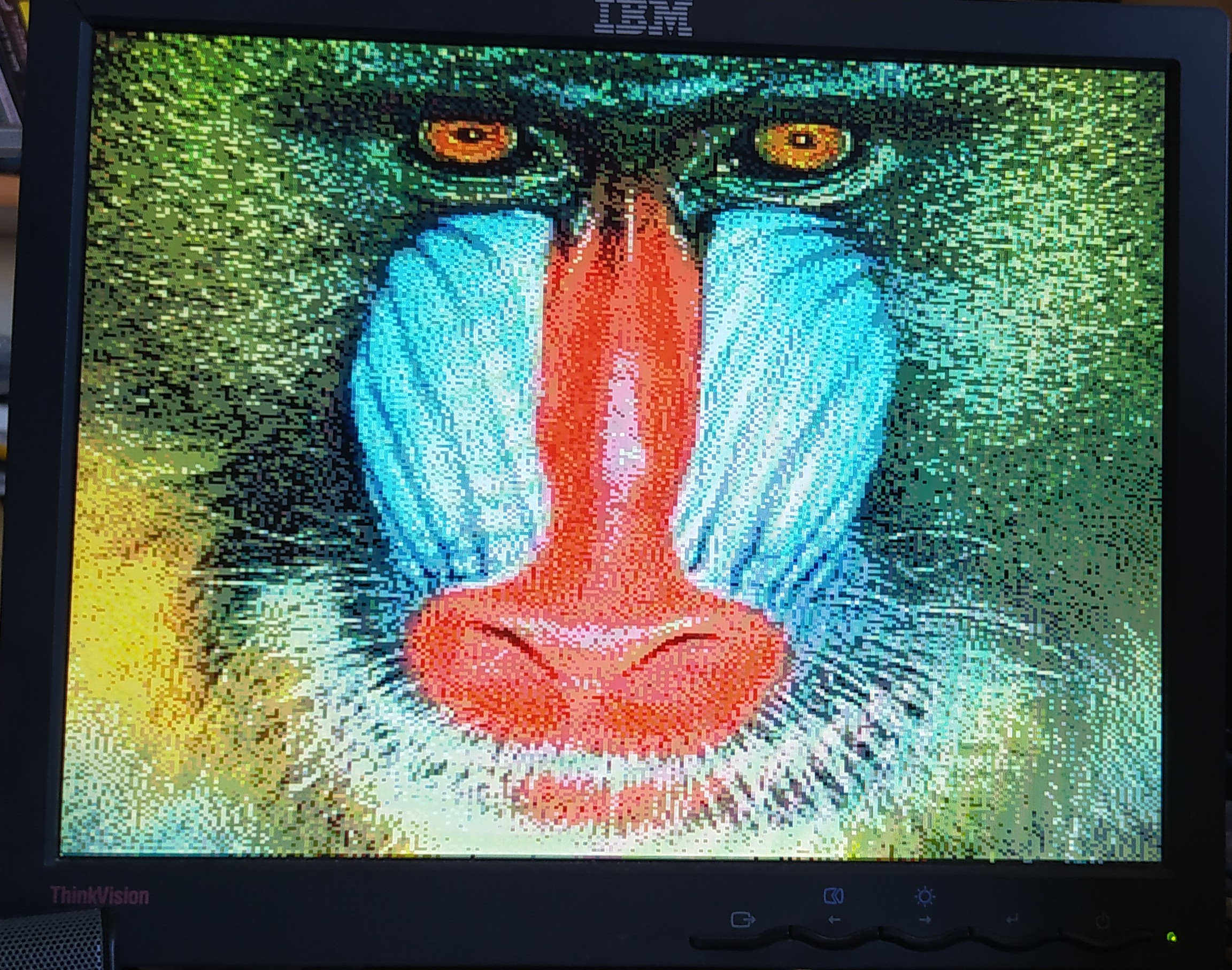

And now 512x256 with 256 colors.
This 512x256x256 mode is slower than 256x256x256.

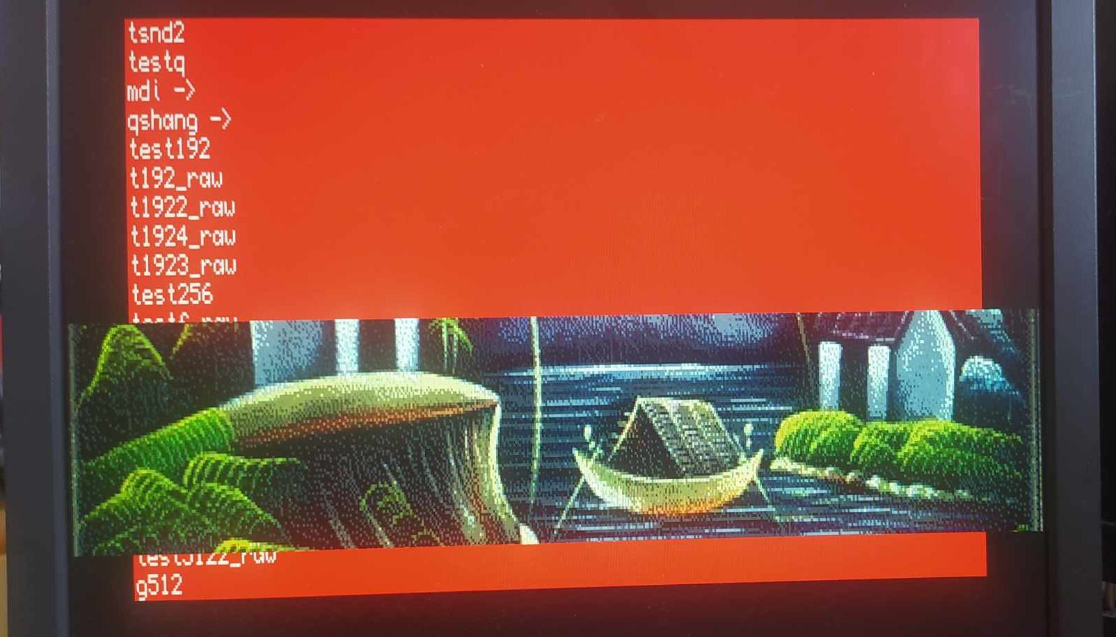

Because standard modes and 256 color modes use different memory areas mixing them is possible.
When mixing modes the speed depends on the mixing ratio so can be much higher.
You can have 2 independent screens and show one or the other or part of one and part of the other. One has the standard QL functionality the other is a graphics screen and I need to make text printing commands for it.

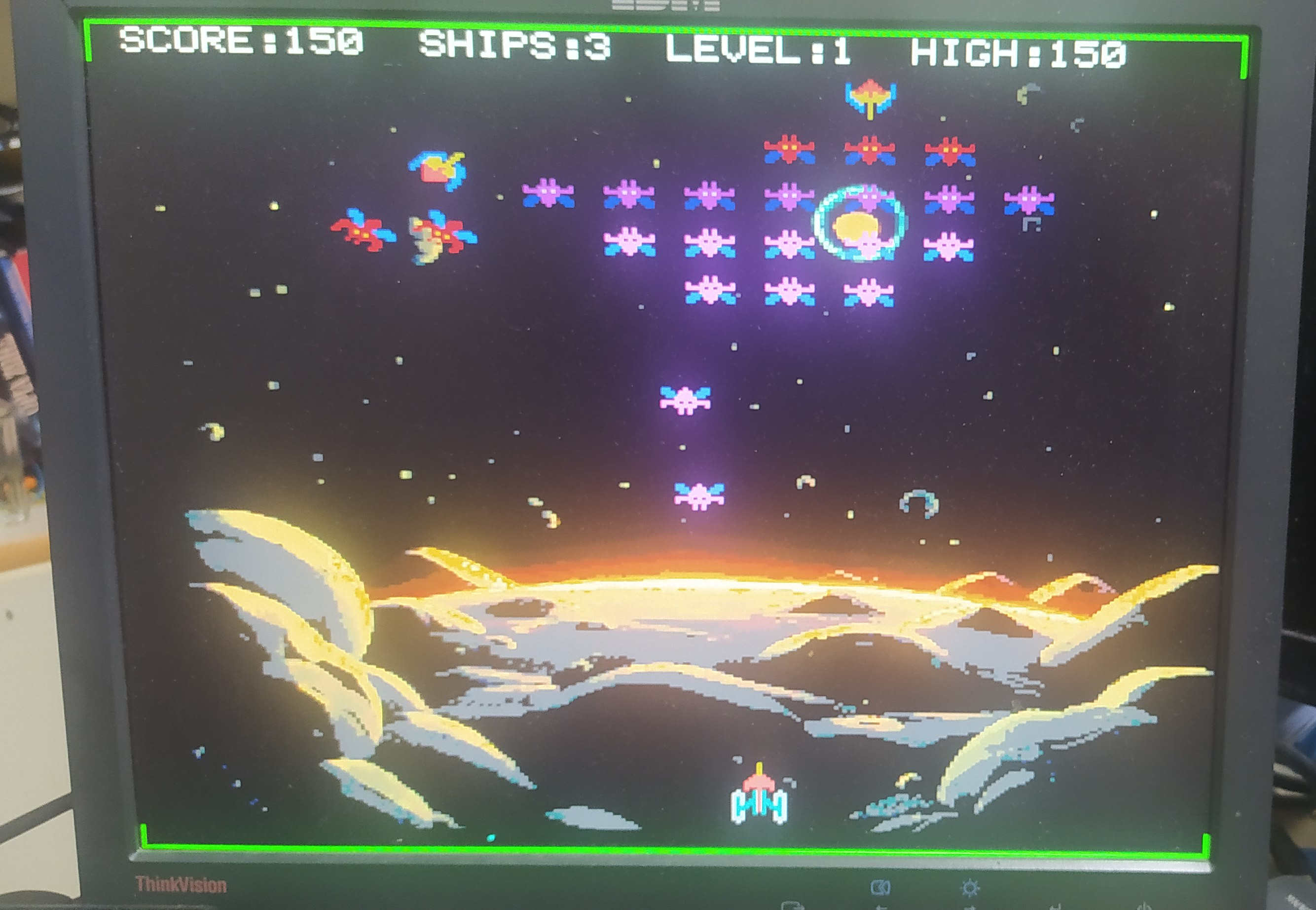

See this: https://drive.google.com/file/d/1tHv9F_ ... sp=sharing
This is the glaxians clone game with a 256x256x256 mode background (AI generated) but top few pixels of screen (and some at the bottom) are from the standard mode 8 screen to display the score. Sprites are not affected by what is going on under their own layer.
