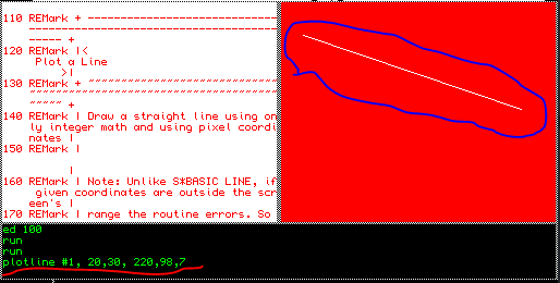

Just "played" with Per's PlotLine, nice. I always wanted "graphics" for the pixel coordinate system.
Wish: Someone should port it to assembler.
Here my (as an owner of "The C Programming Language") "hello world" example:
Posts: 3194
Re: Knoware.no
ql_freak wrote: Thu May 29, 2025 12:47 am Wish: Someone should port it to assembler.
Have a look at DIY Toolkit's graphics functions. They provide pixel coordinate plot and draw functions in assembly language.
pjw
Posts: 1653
Location: Norway
Re: Knoware.no
Post by pjw »
tofro wrote: Thu May 29, 2025 7:47 am
I had intended to convert the plotline algorithm to assembler, but then I got stuck on the high colour modes and the whole project became too complicated for what was intended as a leisurely walk in the park.
Even simplifying to use the internal block drawing routines rather than plotting coloured pixels of my own didnt yield to my repeated attempts. All I ever got were black lines.
So while figuring out how to get the block routines to produce the desired colour is still somewhere on my ToDo list, plotline, with the shapes I had planned to go with it (rectangles, triangles, circles, etc) are off the menu.
I wasnt aware of the DIY version before, but on checking it out now it seems it is rather out of date. It may work fine on QL-like machines (512x256, modes 0 and 4, and Thor mode 12) but no high colour. A later update seems to be able to work with larger screens, but due to some design decisions, Im not sure these routines will work with very large screens.
No doubt they could be updated by some knowledgable and dedicated enthusiast. But personally, I wouldnt have used two step instructions to draw a line, and therefore the need to "remember" values between calls. It might be a lot simpler and better to start afresh..
