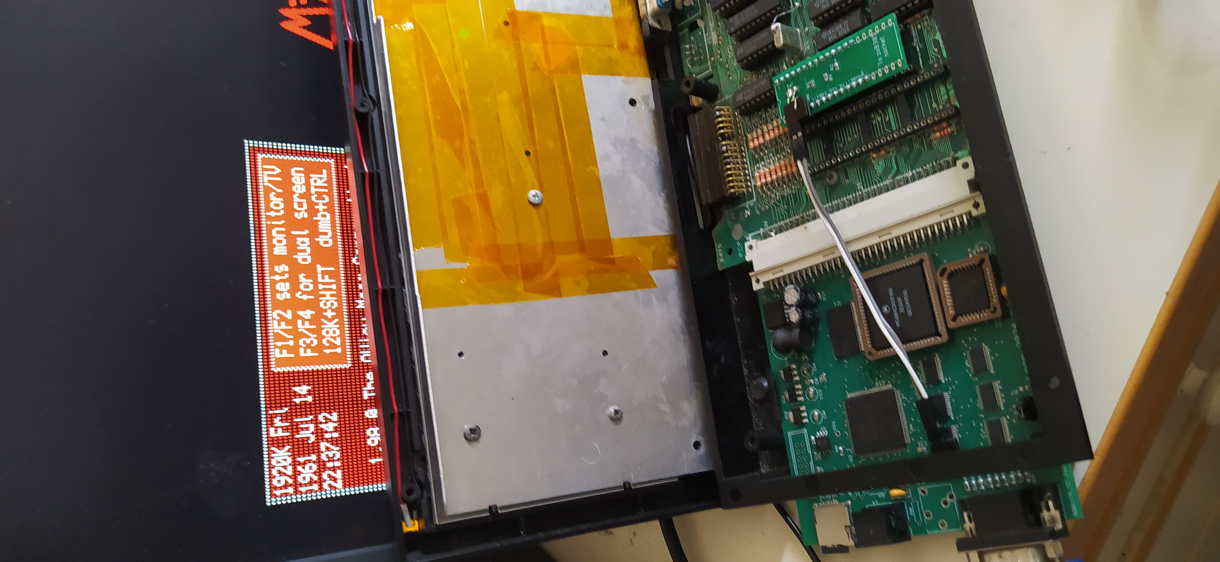

It started as 2 separate boards but then I made a single board to eliminate the cables, that was ok in my ql with the changed sockets.
It was when I tested it to another QL I realized the height problem :(
I didn't tied the unused inputs to a fixed voltage because their outputs are always disabled (high resistance) by the G pin so they shouldn't oscillate at least their output stage.

As Peter and one's complement suggested an expansion card board is ready and it solves many problems.
It also needs two wires and a small board over zx8301 socket but it is so much easier to install and no need for 3d printed plate for the ports.
I also changed fpga to the newer cyclone 10 LP that I finally found in stock.
I am testing it now.

Posts: 2540
lliont wrote: Wed Apr 24, 2024 4:35 pm It also needs two wires and a small board over zx8301 socket but it is so much easier to install and no need for 3d printed plate for the ports.
One or two wires are not too bad. For QIMSI I also needed one for the QL speaker.
I had the luck that one ROM port pin has no dedicated funktion, so the card remained pluggable.
Maybe some expansion port pins are forever so useless they could be cut an re-dedicated?
