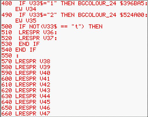

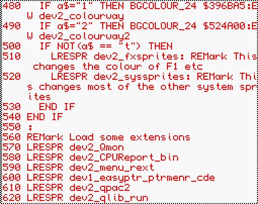

I tried it with my BOOT. Of course it stops at line 480. What should have come out of it?
Original:
Changed with the program:

RalfR wrote: Wed Feb 19, 2025 3:25 pm I tried it with my BOOT. Of course it stops at line 480. What should have come out of it?
Original:
This is because you do something I never do: Use unquoted file names!
EW now thinks that V34 is a file name which, of course it isnt. I havent catered for this kind of thing. It should be simple enough to fix it manually. All of your LRESPRes are going to go the same way!

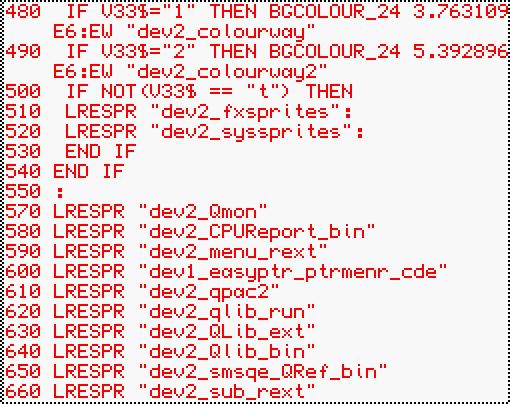

What bothers me more is that the hex on line 480 is supposed to be converted to a normal float. I'll have to look into that when I next have time.

I uploaded a new version (still V0.01) to fix the hex issue.

OK, I've put the names in quotes, but I don't really see the point (at the moment ;) ). Is it primarily about encoding the variable names and to delete the REMarks?
