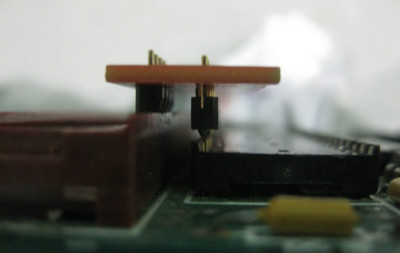

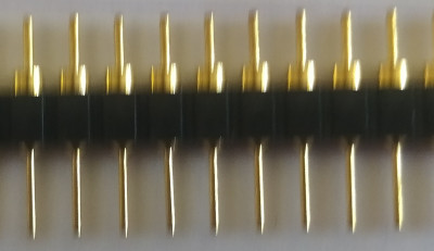

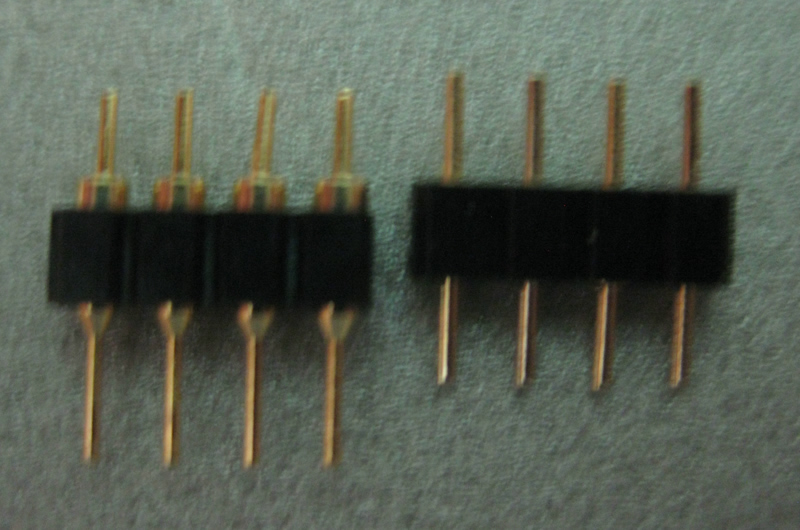

It a matter of 3-4mm
I use these pins that are perfect for round pin sockets and are thin enough not to destroy the others unless you insert and remove many times.
if only they where a bit longer from either top or preferably bottom side.

lliont wrote: Fri Apr 05, 2024 5:04 pm It a matter of 3-4mm
Hi.
We can't find the long round connector, but we can use the short connector instead the normal and the normal instead the long.

Nice I'll look for the short one, thanks.
